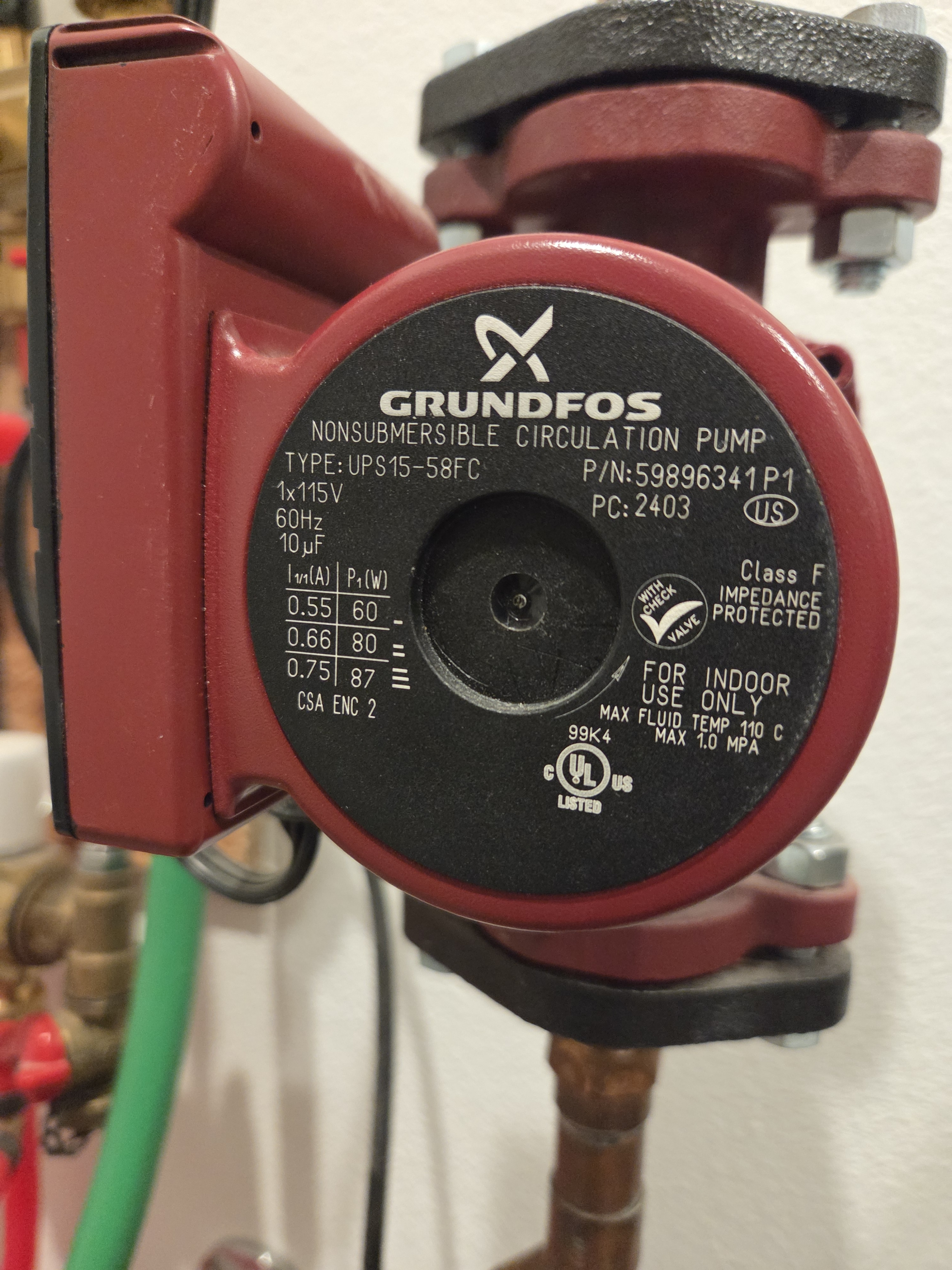

    Grundfos ups15-58fc with hot water heater for floor heat at 80F but pump warms up to 135-155F. I suspect air in system and will install t pipe at highest point in system to bleed air. Does this pump have bleed screw,?
    hot_rod Member Posts: 27,301
    if you pop that black label off, some models have a large screw below that you can purge some air.
    Or loosed the top flange bolts and burp it. Be careful if it has been dead headed there could be a steam discharge
    The checks can sometimes fail inside that volute and cause a blockage or restriction.
    The motor will run a bit warmer than the fluid it pumps

    Is this a system down near Branson by chance?
    That looks like a fairly new pump, I think the PC indicates the 3 week of 2024 manufacturer date.
