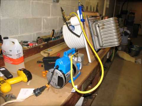

    This is my unit that will finally be put into normal service soon. I have the other 2 shelves and a fruit basket that were all nickel plated. They just weren't needed for testing and doing the final charge.
    You know all the guys that claim there's no replacement for displacement? They're actually talking about insulation. :)

    Been working on it on and off since 2007. After its put into service I have two more to start on
  • ChrisJ
    ChrisJ Member Posts: 17,047
    edited March 2015
    SWEI said:
    You're getting me interested in adding another project to the already-bordering-on-untenable "I want" list. Bad.
    Be careful, it ended up being a lot more work than I expected. As I said this one started in 2007 as a free refrigerator and it's far from that now.
    High side float valve had damage to the seat so I converted it to a capillary tube.
    Crankcase heater was burned out so had to order a few custom made 12mm x 2.5" 12W heaters.
    Door hinges had too much wear on them.
    Door handle was beyond repair.
    New reproduction door gasket.
    New reproduction black plastic feet that go under the legs.
    Found an original GE Chiller Tray that sits under the evaporator.
    Sandblast racks and get them nickel plated.
    Sandblast top and paint it, 5 coats.
    Start relay was buzzing so converted it over to a solid state one with built in overload. May change my mind and go back to a mechanical one though as the solid state one makes it so it can't restart immediately. This makes the unloader pretty much useless.
    Had to grind all of the rust along the edges of the porcelain enameled panels \ legs off and paint it with a brush.
    Sand surface rust from bottom and paint.
    All new wiring which is a pain and you almost need to tear the entire top apart to do it.
    Grind out deep rust from top plate (plate under compressor that forms top of cabinet from inside) and bondo holes then paint. New insulation added after that.
    New cork, insulators and 316 SS hardware to bolt evaporator to top plate.
    Bought 2 liters of new Methyl Formate which is kind of cool because it comes in a glass bottle and you pour it in via a funnel.
    Of course I needed refrigeration tools,
    Robinaire 2 stage vacuum pump and a gallon of oil.
    Yellowjacket micron gauge
    rare adapter for charge valve on fridge (bought 2 as I found them).
    TurboTorch swirl type acetylene torch with 3 tips and tank.
    Nitrogen tank and regulator.
    Brazing rods, I think 15% sil-phos but can't remember.
    I'm well into the thousands of $$ on this project but the good news is most of that can be used to restore the other two as well so that's nice. I also love the torch and haven't used my Bernzomatic MAP torch since even for plumbing work.
    Learning to braze was easy but working with flammable refrigerant was less than fun.
