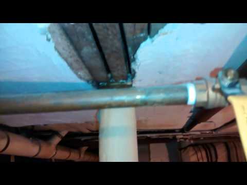

I have a oil converted to gas steam boiler. It's at least 31 years old but I would say at least 50. It does not have many of the new features like an automatic water refill or low water cutoff. It's been trucking along alright but I'm getting worried that failure is eminent. It appears I may have a small water leak somewhere because I find myself filling the boiler with water more frequently. So what are some thoughts as to when I should look into a replacement? Thanks!

    Can you post some pictures of the boiler and the piping around it?
    Single pipe quasi-vapor system. Typical operating pressure 0.14 - 0.43 oz. EcoSteam ES-20 Advanced Control for Residential Steam boilers. Rectorseal Steamaster water treatment

  • hwangnyc
    hwangnyc Member Posts: 18
    Here is a video of my boiler. what do you think?
    https://www.youtube.com/watch?v=EnFhf8KfEms
  • Fred
    Fred Member Posts: 8,542
    It's not piped like we would do it today but if it's worked well all these years, I would continue to maintain it as long as it continued to keep the house warm. My piping is 113 years old and isn't piped exactly like we'd do it today either but I doubt that it could perform any better even with today's modern header configuration.
