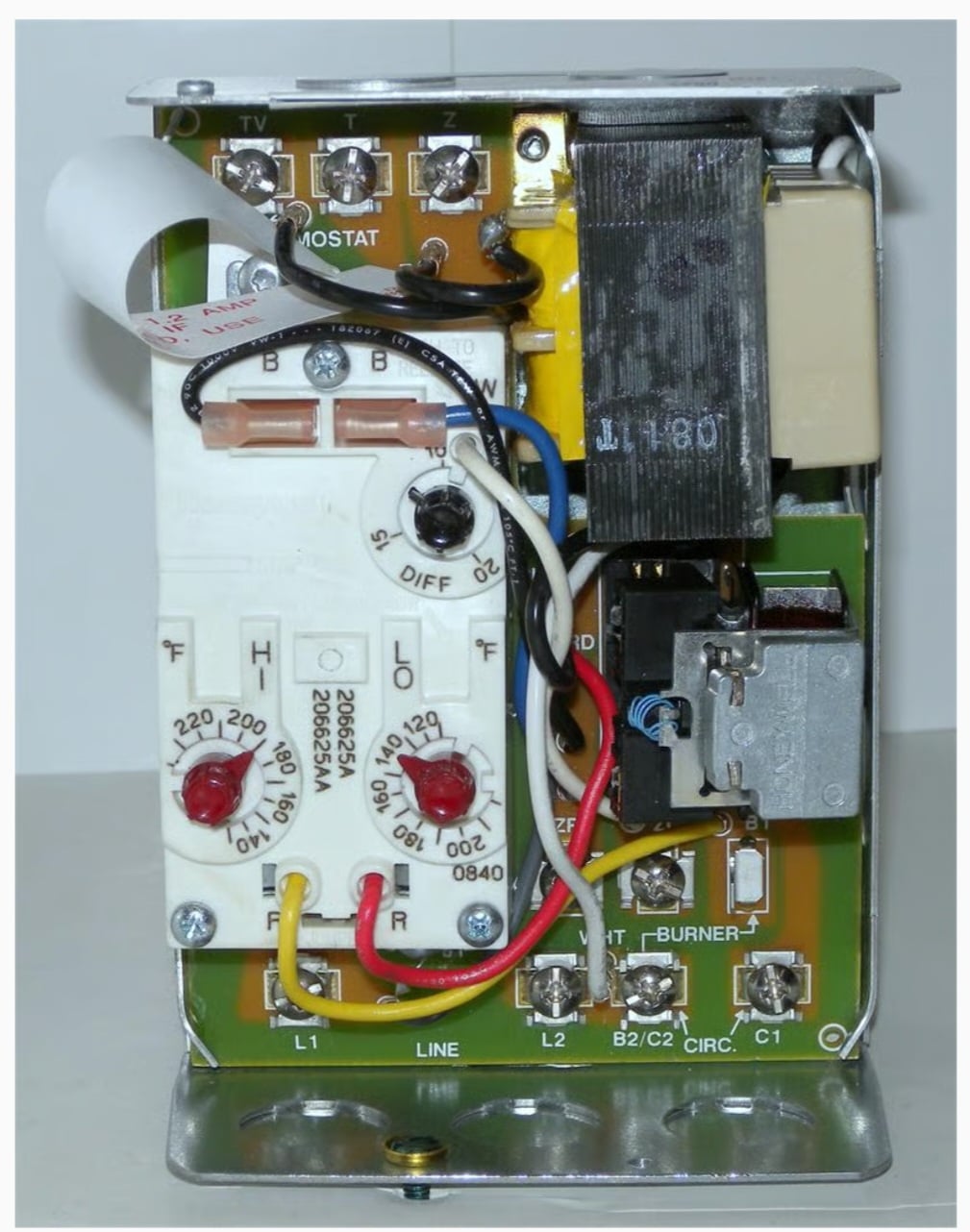

Have a 5 zone Taco zone controller and an L7224U aquastat. ZC wired to ZC and ZR wired to ZR. L7224 is set to warm start. The circulators drop out when boiler temp goes below LL -diff and they restart again when it goes above LL just as it should. The boiler is only for for space heating, no DHW. I'd like to try it as a cold start and save some fuel but still have the circs controlled by ZC signal to the Taco. I know if I just set the L7724 Low Limit to "off" it makes a cold start but then I'd lose my LL control of the circs. I'd like to leave the L7224 in warm start but use the unused isolated relay in the Taco in series with the burner control wiring. Since the isolated relay is not energized when there's no call for heat the LL function would be defeated, the burner would not start, and the boiler would go cold. When a call for heat occurs the isolated relay closes and the burner can start and go up to HL. So I'd have a cold start but with circs that do not operate when temp is below LL. Make sense?

If you want to make your boiler aquastat relay a cold start, you have to disable the lo limit.
To do that......
Shut off power to the boiler,
remove the white wire out of the (differental knob (should be white) from the front.....
Remove the wire out of the lo limit knob (most likely Red) from the front.....
To remove these wires... stick a very skinny screwdriver or finish nail in the opening on the side of the wire while pulling on the wire at the same time, it should release easily.
use a wire nut and join these two wires together, there is no more lo limit control. The boiler will only run during a call for heat.
The aquastat is an L7224. I know how to make that a cold start. Just set the LL to off. I'm looking for a more sophisticated setup to retain ZC control of the Taco and circs but fool the system to go cold when there's no heat call. I think I can do that by leveraging the unused isolated relay and using it in series with the B1 burner wiring.0
what about jumping "T-T" in the aquastat, run "T-T" from the panel relay to The cad cell control, leave the LO limit set about 120? Just thinking here for a min0
I think you can drop Z-C at that point?
nah, scrap that idea. You are not using C-1 in the aquastat
From control pic above, it is the blue wire you want to remove to make it a cold start, but C-1 will continue to get power when the LO temp setting is reached0
