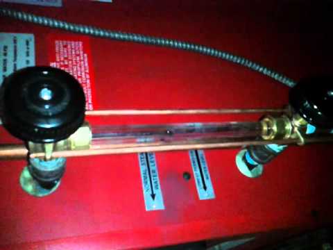

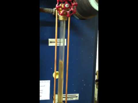

    I came across this one a while ago. Not sure if this is what you are talking about, but this shows the surging that can be associated with a boiler that needs skimmed. The second is a link to a video of what the water level should look like when steaming. A little bouncing.
    http://www.youtube.com/watch?v=eqpbPPmiEXg
    http://www.youtube.com/watch?v=DYNzAYjd5K8

    That's quite a difference! Mine looks more like the top video, unfortunately. The old adage "oil on troubled waters" definitely does not apply to steam :p

    Steamhead Member Posts: 18,176
    It's the Weil-McLain demonstration boiler that is piped in Pyrex glass. There are pictures around- I had some from a long time ago but can't find them now.
