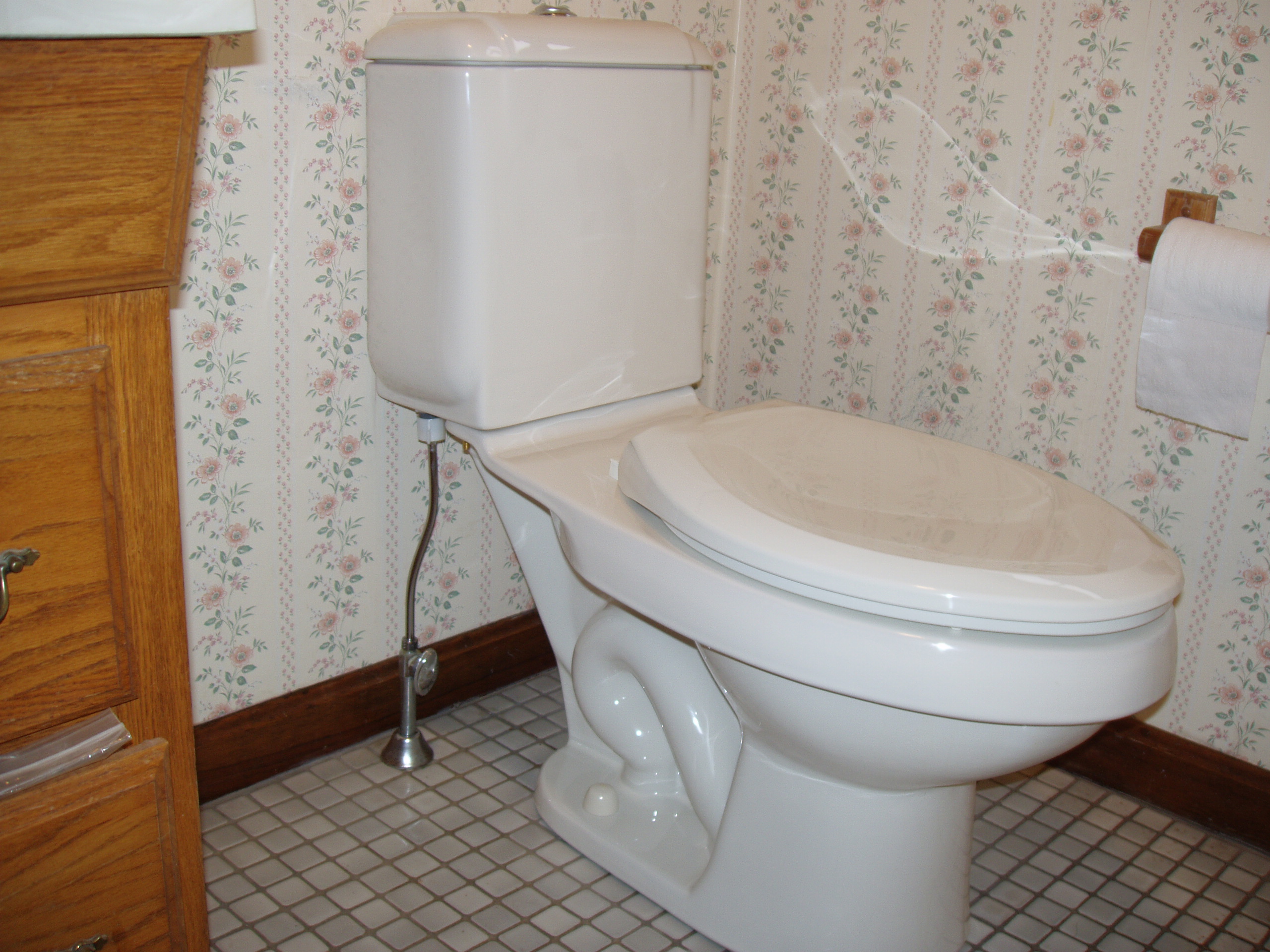

I just tried one of those much hyped Toto Drake 1.6 flush - round front.
Amazingly, I think some of the PR might be justified. The thing has _no_ swirl, just one quick GULP-Thump as the flush valve slams closed. A 1-second glug and it's all over except the fill-valve hissing. First flush seemed so strange I figured I got a bad product but the thing just keeps clearing the bowl, 1st time every time, no matter what's in it. Had it a month and I'm about sold.

Kohler makes a great 1.6 that I have used for a few years that I have had no problems with. I now use 1.28 Kohler's when ever I can, and I put a dual flush Sterling, Kohler subsidiary, that uses .8 on a liquid flush and 1.6 with solid wastes. This toilet has not clogged in three years since I put it in. Before someone else says it the last one I put in was manufactured in Mexico, but at least it's an American Company and made in North America.
