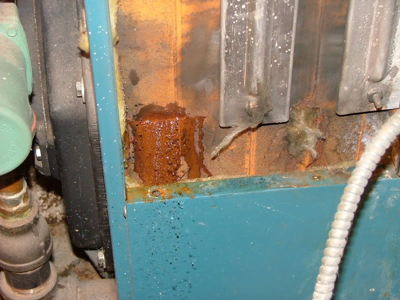

    pictures
    #1 shows the closely spaced monoflo t's. 6 within a 40" run of 1.25" pipe, separated by 4", 6", 8", and 10" nipples. they are not far enough apart nor are they alternated properly between the upfeed and downfeed emitters.
    #2 shows the near boiler piping.
    #3 shows where the supply split occurs at a normal 1.5" tee to 1.25" pipe moving away from the photographer towards the next three supply monoflo t's which return behind the photographer on the left side of the loop.
    #4 shows the balancing valves that I worry aren't going to last very long. Especially the one farthest away in the photo. Made by Welsbach, brass I think, very difficult to turn when trying to adjust flows and I normally break things no matter how gentle I try to be.
    #5 shows the location where I would need to move the 1.5" supply pipe from picture #3 and tee into the line between those 2 monoflo t's where I have the plastic hanging. This would set the system so everything supplied on the right returns on the right, and everything supplied on the left returns on the left.
    I think everyone can guess I am not a heating professional, and looking at the pictures you can tell I am not a photographer either.

  • S Ebels
    S Ebels Member Posts: 2,322
    Looks like
    A: The point of no pressure change rule has been ignored. The circ is pumping at the air vent and the expansion tank.
    B: Removing all the monoflo piping would be a real piece of work in and by itself.
    C: The whole house is set up as one zone?
    So here's some thoughts
    PAP is rated for 80PSI @ 200*F, no problem with using it for your intended purpose at all.
    The expansion tank should not be hung of the back of that flow check. You want it and your air vent/air eleimination device to be in a location where the circ is moving water AWAY from both of them not toward them. It's also a good idea to bring your feed water into the system at that point.
    With the right manifold setup and home running each, BB you could zone as many ways as you want with the addition of telestat heads.
    What problems are you having with the system?
