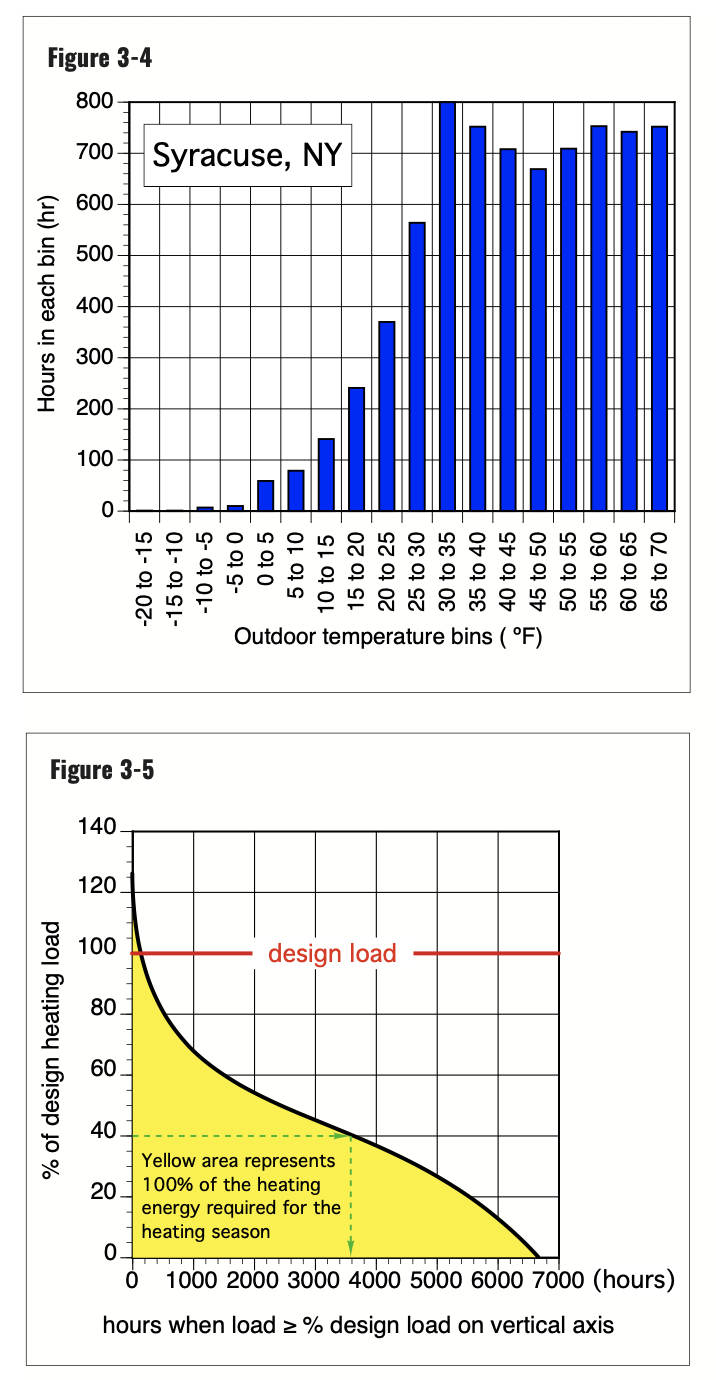

    So many good choices. Most brands offer a basic model and a version with more features. I like the Lochinvar Knight. 20 year record of use now. I use most of the control features, so it is worth the exrea $$.
    Even if it runs 180, it will be more efficient because it modulates and should all but eliminate short cycles. On a zoned system, especially with micro zones the modulation is a big deal.
    It's the short cycling on CI boilers that drives efficiency numbers down.
    With ODR you should modulate down below 180 for most of the heating season.
    Do a radiator or fin tube count to see what BTUs are being delivered. Then a load calc would show % of the season at lower SWT.
    Idronics 25 has ideas for lowering swt.
    If you want to take it a step further download the past temperature data for the location. Put it into a bar graph.
