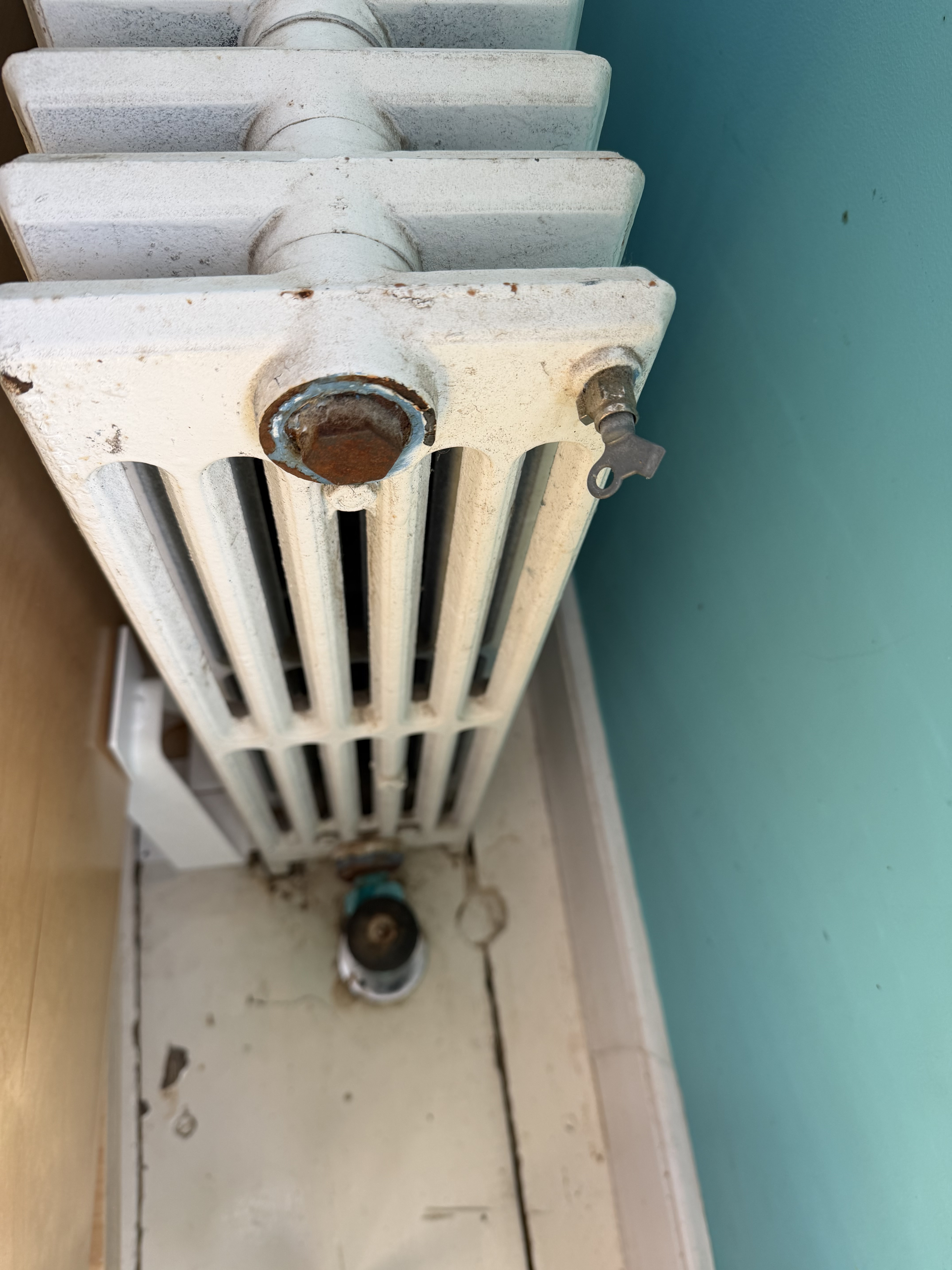

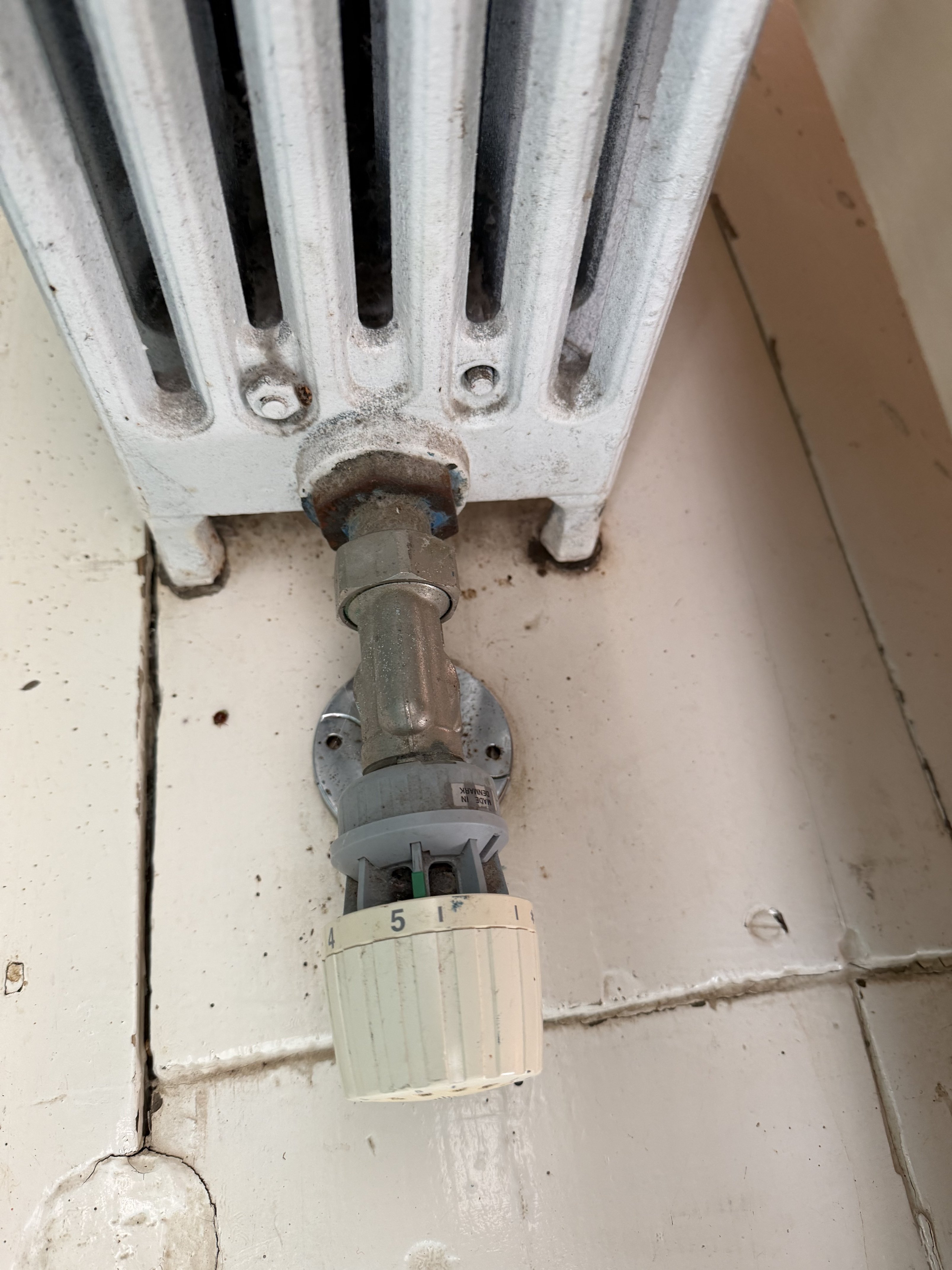

Firing up the heat this year one radiator remains cold, think it could be the pictured thermostatic valve has failed, probably over 20 years old, dial turns but no heat comes on at any setting, other rads in series heat up. wondering if there is any idiot-proof dyi i could try? before calling (and paying) a plumber, next photo shows the rad other side, thanks
Have you tried bleeding the radiator? How far above the boiler is the radiator? What is the pressure on the boiler gauge?

snap the actuator off and see if that pin below pushes in and springs back
Push on it with a flat tool of some sort
If the pin us stuck the actuator will not control But the thermal cartridge inside the head can fail also
