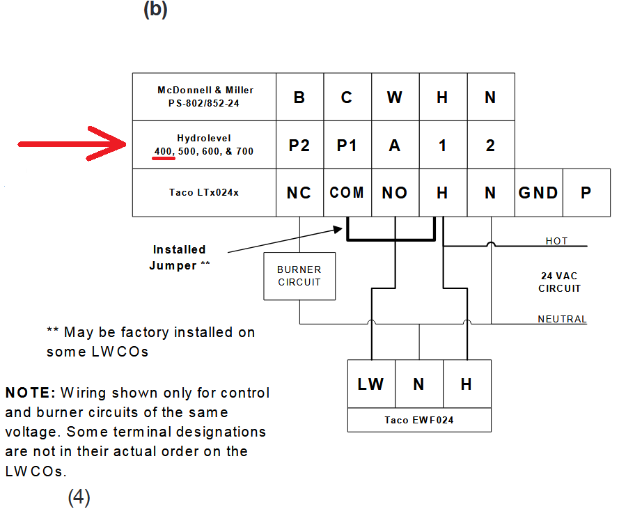

LWCO to AUTO FEED WIRING
CAdam
Posts: 1

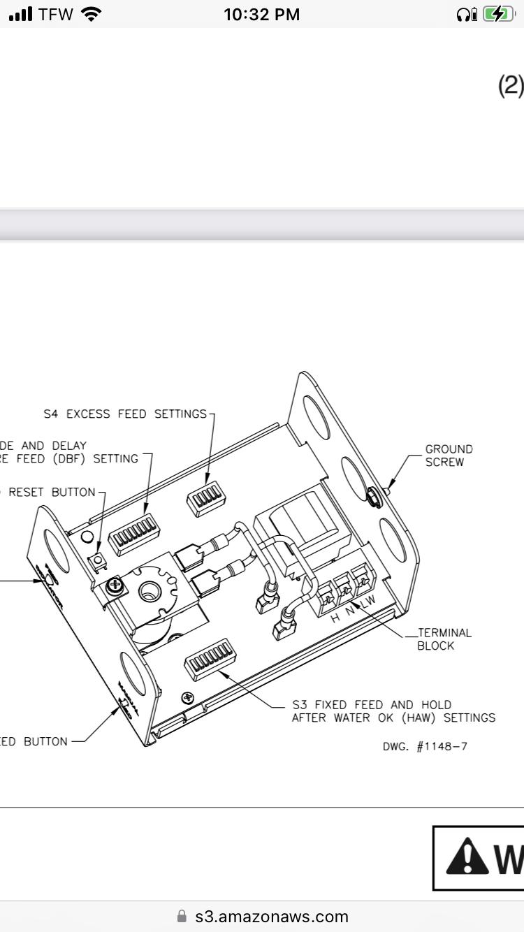

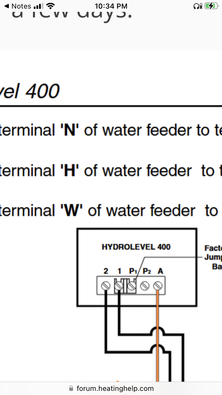

Have a CG400 LWCO and Taco EWF024-1 auto feed. On my natural gas steam boiler. Had to replace old auto feed which was a McDonnell & Miller just want to double check if my wiring between the new Taco and CycleGard is correct. It would be?
A - from cyclegard to LW on feed
2- from cyclegard to N on feed
1- from cyclegard to H on feed
