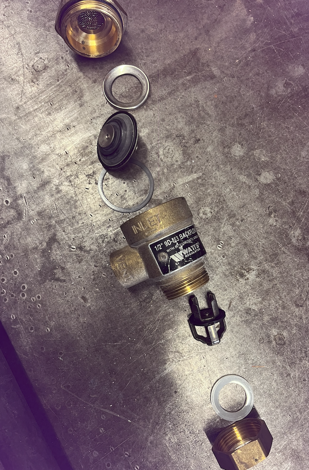

I was wondering how easy it is to clean the Watts 9DM3 back flow preventer?
I have softened well water, my Watts back flow preventer is mounted on a long nipple 1/2" black iron pipe after the ball valve and before the Watts fast fill valve on the pump module.
I wanted to fill the steel compression tank with water as it appears low on water after I installed the new Bell & Gossett NRF-25 circulator.
I opened the ATF 12 to vent the excess air out of the steel compression tank then I opened the ball valve to add water back and the fast fill valve but nothing happened other than air coming out of the steel compression tank.
I have not had to add water back to my coal stokers system for at least 5 years before this.
There was no leakage coming from the back flow preventer nor was there any pressure build up on the boiler pressure gauge.
I can buy a new back flow preventer and just swap them out I guess using the old unions if the long dimensions for the valve length are the same.

    If it has a fill valve and BFD, the fill valve is more prone to sticking shut.
    There is a strainer on the inlet of the BFD, maybe the fill valve also.
    BFD easy to disassemble and clean, keep track of the order of parts.

    hot_rod Posts: 28,776
    Comes a point where rubber components inside give up the ghost. Consider it a consumable and replace 3 critical components.
    BFD, fill, and safety relief valve.

    Well, we did not have to drain the boiler as the pressure relief valve and the fast fill flow regulator are fine as well. The supply house has never heard of Fernox aerosol boiler treatment.
    He traced the problem to the L8124L triple aquastat as failed. He replaced it with an L7224U digital triple aquastat. The box for the L7224U looked like it had been through a heavy rain and then dried off. It works that is all I care about.
    He replaced the back flow preventer reusing the original union from the first back flow preventer after seeing what the poppet valve looked like. So, after almost $943.00 we have heat.
    I will be going back to the plumbing wholesaler tomorrow with the fast fill valve and the pressure relief valve and have them credit my debit card for the purchase as a refund, then to the bank to verify the refunds were credited to my account.
