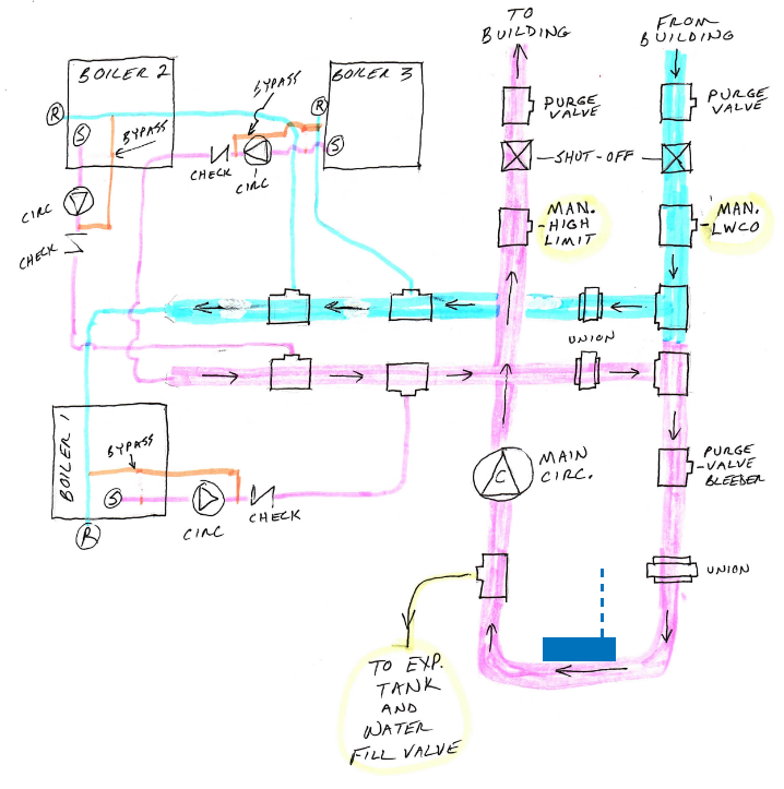

This is in regards to a recent job that has been completed. I have 3 boilers connected to a single zone system for the building, and have a Tekmar 294 boiler control system.
The system is working well overall, but on occasion, it seems that the supply temperature reading displayed on the Tekmar is a bit off.
So on the attached drawing, where should the sensor be located for supply water temperature ??

    Let me clarify… There is only one single supply temperature sensor for the Tekmar to monitor "SYSTEM" supply water temperature. So the sensor should be somewhere on the main piping, or technically the "secondary" loop. Isn't that correct? My question is where on the main piping

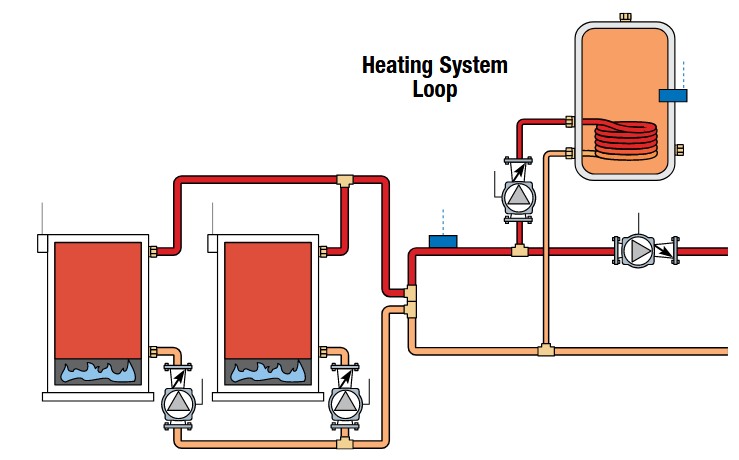

    Looks like only one sensor, boiler sensor which would go on the piping at the top of the drawing.

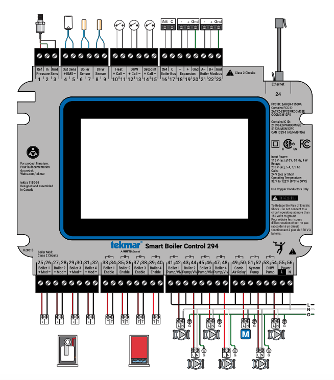

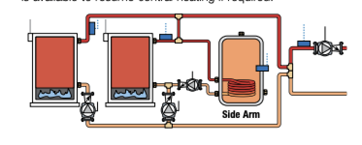

    But one drawing in the manual seems to show sensors at all the boilers?? Where would those wire to?
    As for the two loops. The loop that has the expansion tank connected is the primary loop. So the boilers are actually secondary loops.

    EBEBRATT-Ed Posts: 21,202
    I would put it next to the High Limit
    109A_5 Posts: 4,650
    Why ? The manual clearly shows it before the main circulator and after the closely spaces tees and after the elbow. Maybe between the 2nd elbow and the main circulator would be better.
    hot_rod Posts: 28,558

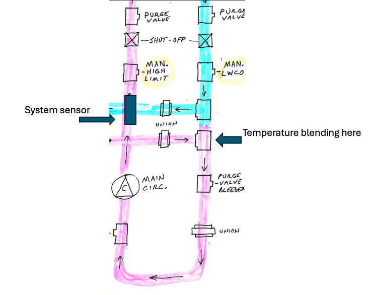

    Downstream of the loop pump would be my choice, so the circ stirs the blended temperature happening at the close tees
    You may have more purge ports than you need? Upper left you could pump into, purge from upper right.
    Just makes sense to me to put the operating control next to the high limit so they sense the same temperature.
    109A_5 Posts: 4,650
    edited 2:44AM
    Having a high limit down stream from a circulator that could fail seems a bit curious to me.
    That High Limit connects to what ? Some burner control loop for all the boilers. I don't see a High Limit on the Tekmar 294.
    yeah, I don’t see the purpose of the high limit. I would guess the boilers include that function in their control string.
