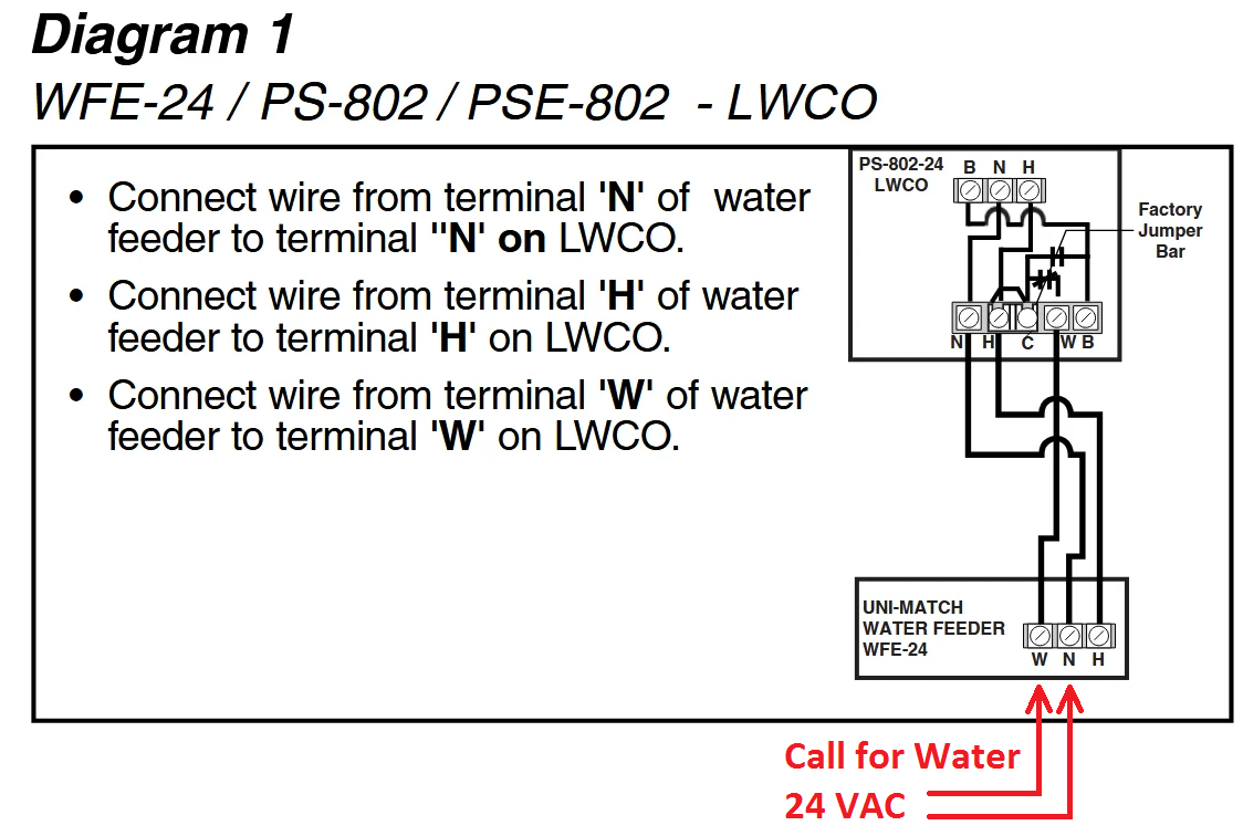

Hi, I think I am having issue with my McDonnell Miller PS 802 LWCO sending a signal to the Unimatch water feeder. The LWCO installed on my dunkirk boiler seem to be working. The green light is on showing power. When I drained the water enough, the red light turns on indicating low water, and when I manually add enough water back-in, the red light turns off. This appears to me to eliminate that it is a probe issue.

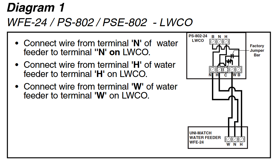

On the water feeder, when I manually press the feed button, the green light on the water feeder comes on and water is fed into the boiler. However, the issue seem to be the green light not turning on when the water level is low from the LWCO. The wiring setup current from the LWCO to Unimatch is N = 2 (N on PS802 and 2 on Unimatch); C = 3; W = 1
What should I test with the multimeter to determine whether it is a LWCO failure or Feeder failure? Is there a way to manually provide the signal on the "W" wire to test the feeder?

    109A_5 Posts: 4,759
    Assuming the 24 VAC models. At the LWCO removing the wire on the W terminal and touching it to the C terminal long enough for any delay to expire should activate the feeder.
    EdTheHeaterMan Posts: 12,940
    Your wiring may not be correct. Can you take a photo of the wires and how they are connected to each control then post those photos here?
    109A_5 Posts: 4,759
    edited October 20
    I assumed it worked at some point but that may not be true.
    If you want to test with a meter, with the LWCO calling for water I would expect there would be 24 VAC between N and W terminals at the water feeder.
