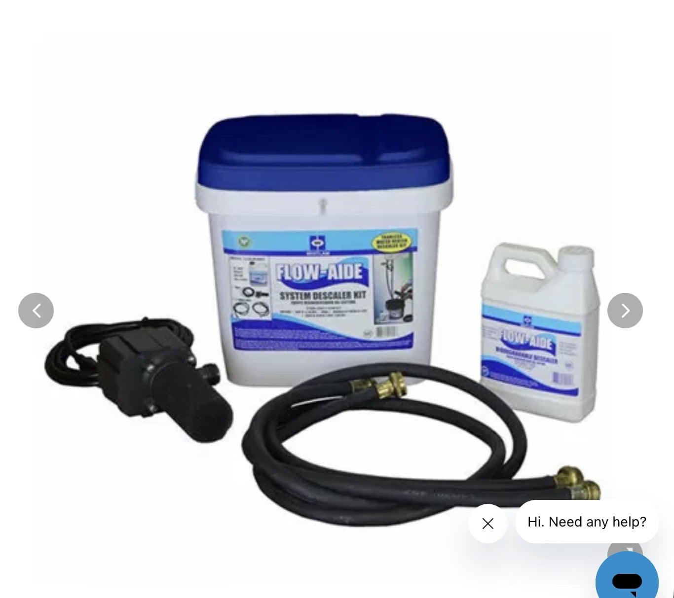

you might add some service valves to the water connections. Then you can attach a clean and flush kit once a year. The minerals in the water can cause the valve and plate heat exchanger to get scaled up.
The kit includes a chemical, bucket, hoses and pump got the procedure.
If this is something you want to tackle on your own?

Flushing the DHW side of the flat plate will not touch the water on the diverter side.
