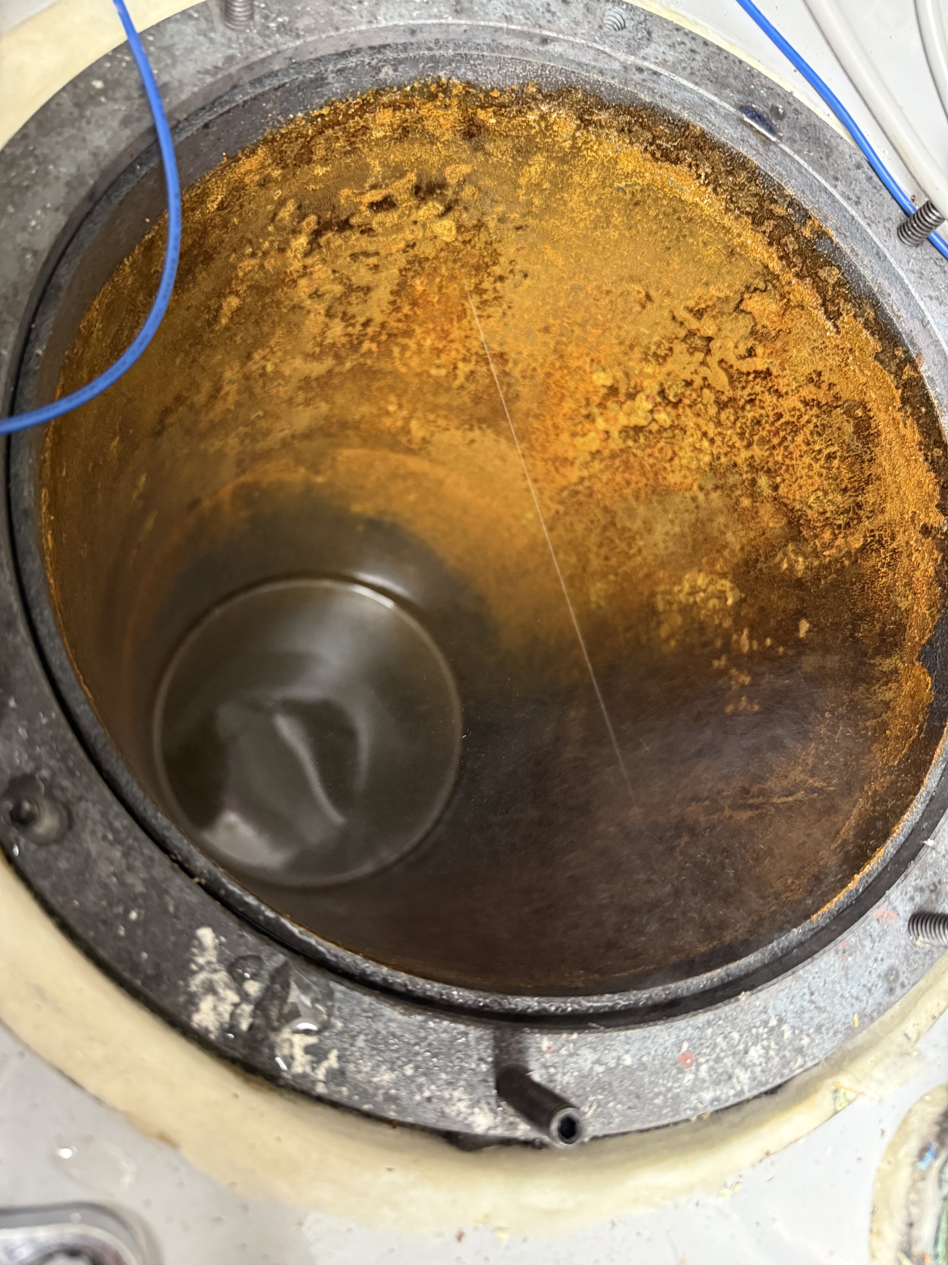

I hesitated to post this but I wonder if there is anyone with the same issue. We have a dorm building that occupies about 20 kids and two resident apartments. Commissioned 2017. Some time in 2020 the water heater failed. A combustion chamber leaked flooding the flame.
On the 9th of October the new one failed. Had a couple service companies out who diagnosed an igniter. I got one but no go. I was suspicious and pulled the burner assembly and found a flooded chamber again.
If you look closely you can see the fine stream of water jetting across the chamber. I don't know if any of you have have 25 teenagers side eyeing you but something had to be done in the short term so I drove a Sheetmetal screw into the hole and stopped the leak and I also pumped out the chamber. It's working now. I'll have the water checked but none of the other water heaters on campus are having issues. We are sort of locked into this heater due to the size and plumbing arrangement.
I guess I'm just wondering if this is not that unusual or has this been an issue for anyone else.

    The BTH500 is under a lot of stress when it kicks on. They have a large BTU output but a small body of water capacity in caparison. They continuously cycle on/off when used in places that require a large recovery. We replace these water heaters all the time due to failure within the 3-5 year range. We find that they are used in a lot of restaurants due to the small footprint they will occupy.
    Did the training in Nashville and it looks solid inside with the lining. i wonder how many hairline cracks develop in shipping as they are real heavy.

    Maybe try an electric powered anode rod. All depends which side the major dilapidation is actually on.
    To me it looks like the dilapidation is on the fire side, closest to the fire, see where the rust seems to stop (Red arrow). The tube could be thicker or a different material if they wanted it to last longer (Orange arrow).
    109A_5 Posts: 4,759
    Kind of wondering if a sheet of rolled stainless steel inserted would extend the tanks life or just cause some other issue.
