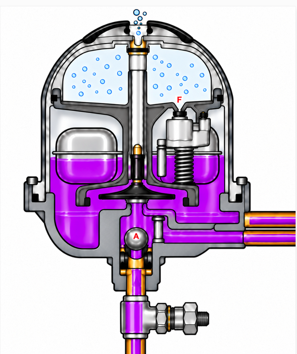

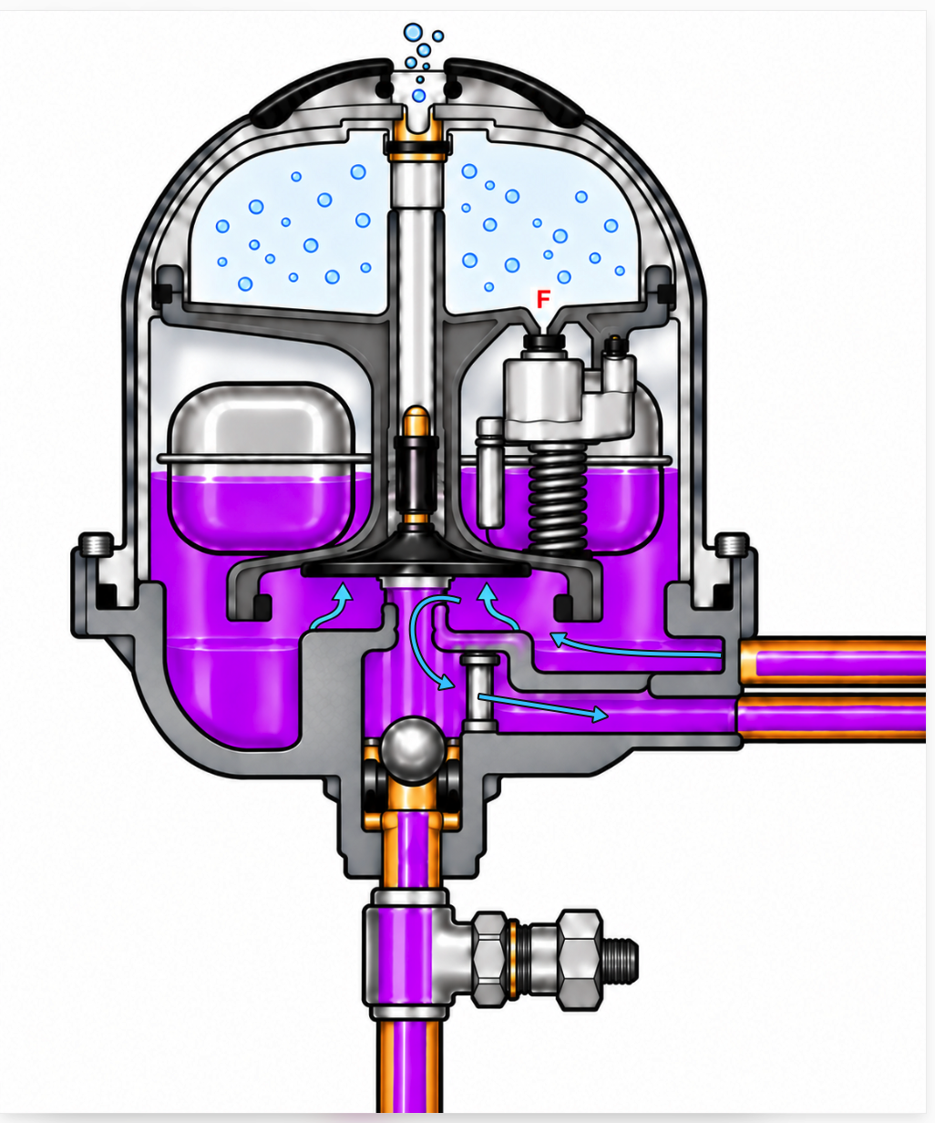

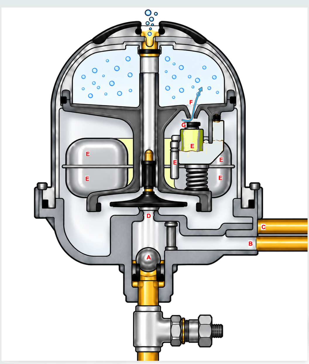

In another discussion, On Oct 12 @MaxMercy said "I've been following and not commenting since I don't know what's going on, but I do have a question and then a comment. OP mentioned several times that there's no sign of air/bubbles/foam in the TL. I have NEVER seen a TL ever, so I confess that I don't know how they work, but my question is that -"
Here is how the tiger loop works.
Lets start new with no oil in the TL

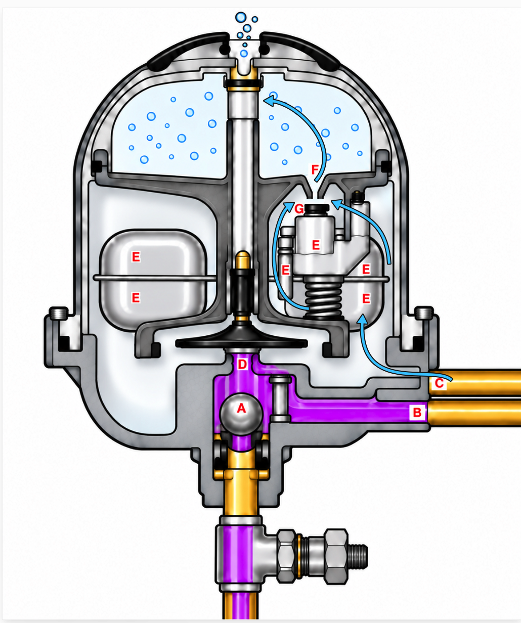

Float E is at the lowest point and that leaves Port F open from the Central chamber to the upper chamber so air can vent. The valve seat covering Port D is closed so the path from the tank to the fuel pump is sealed and the ball check A is closed.
When the pump operates a vacuum happens on the inlet of the pump. That vacuum thru port B opens the ball check A and oil from the tank is drawn into the pump thru the bottom chamber of the TL
Air in the fuel line system is then driven out the pump's return line to port C of the tiger loop. The air vents thru port F of the TL from the Center chamber to the upper chamber where is is vented to the atmosphere.
Once oil is returned to the TL from the fuel pump it enters the center chamber and the float E raises to cut off port F with valve seat G.

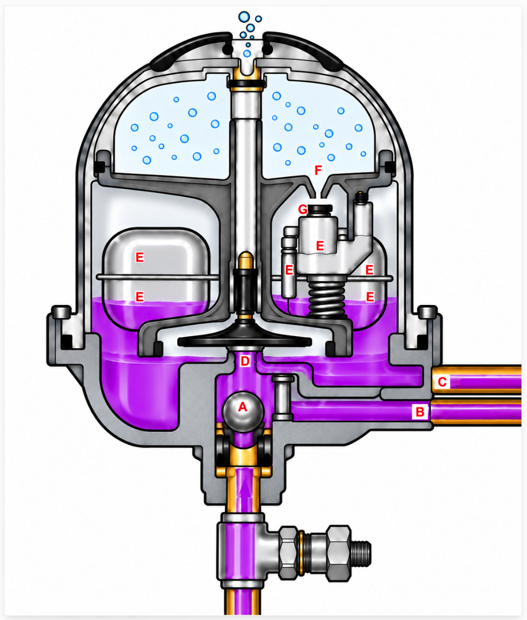

With port F closed the oil begins to build up pressure in the center chamber of the TL. when the pressure reaches about 1.5 PSI that forces valve seat D to open and allow fuel from the center chamber into the lower chamber so it can pass to the pump thru port B. That oil can return to the pump inlet.
Check valve A drops to close off fuel from the tank until it is needed when pressure in the center chamber drops which closes valve seat D sealing off the center chamber from the lower chamber.
  • If air enters the Tigerloop, the float drops, allowing the air to escape into the upper chamber.
  • As the burner continues to operate, the oil pressure in the center chamber gradually drops as fuel is consumed. When the pressure drops, valve D closes, and ball check A opens, allowing more fuel to enter from the tank.
  • As the center chamber refills and the oil pressure builds, valve D opens, allowing fuel to flow to the pump. At the same time, ball check A closes, stopping the flow of fuel from the tank.
  • This cycle repeats continuously, with ball check A and valve D opening and closing in response to changes in oil pressure in the center chamber.
Hope that explains the TigerLoop operation clear as mud.
