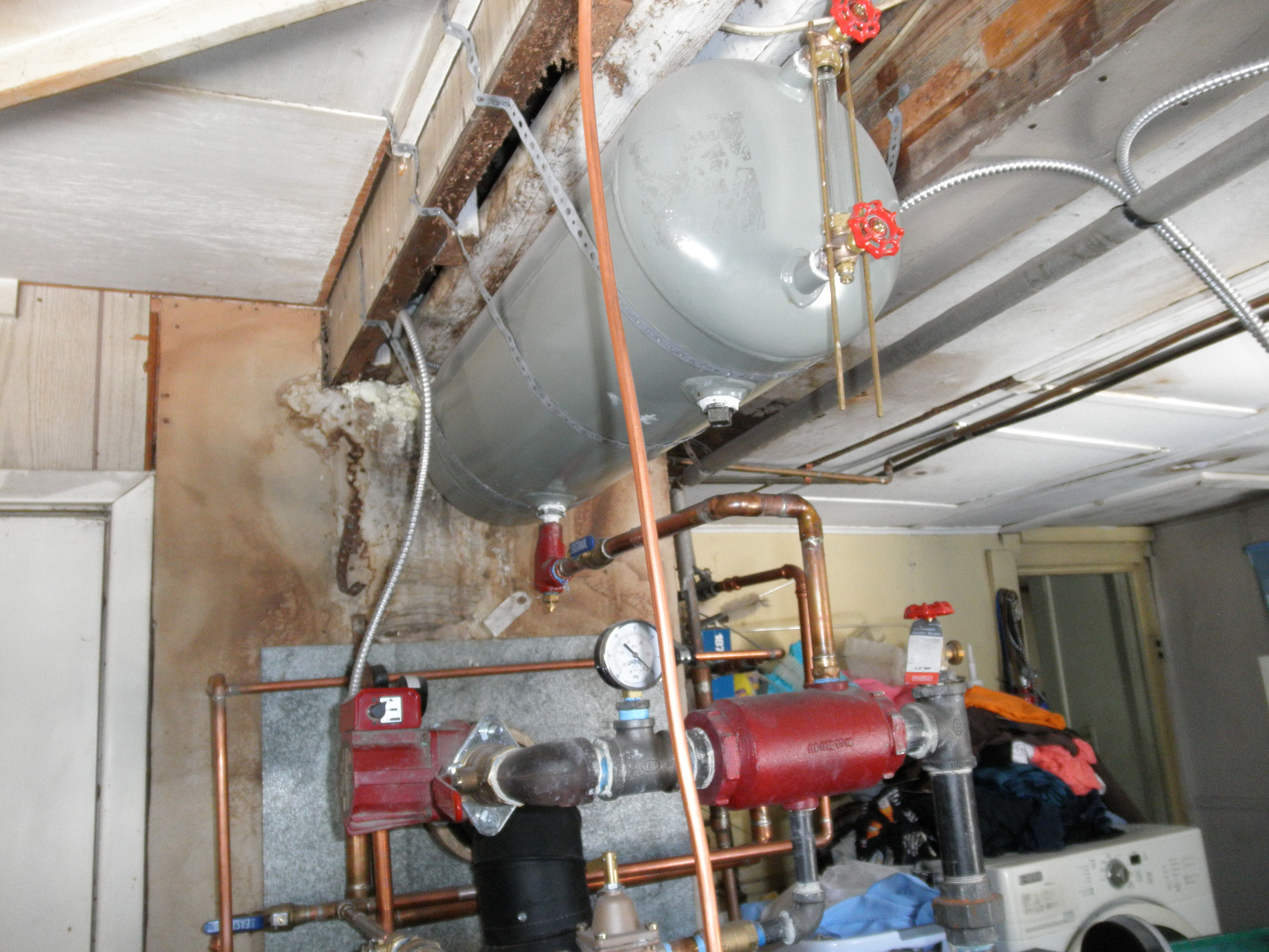

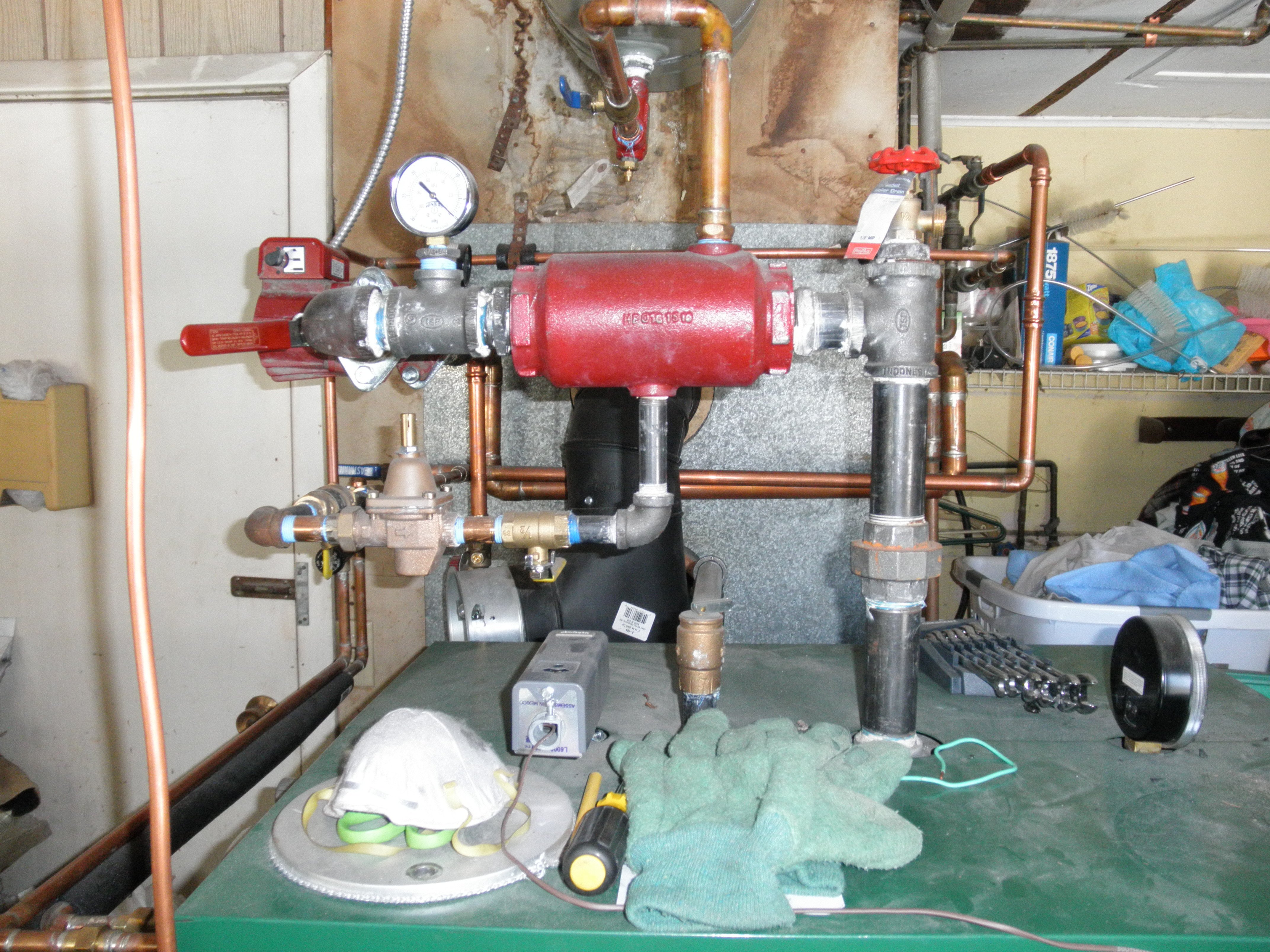

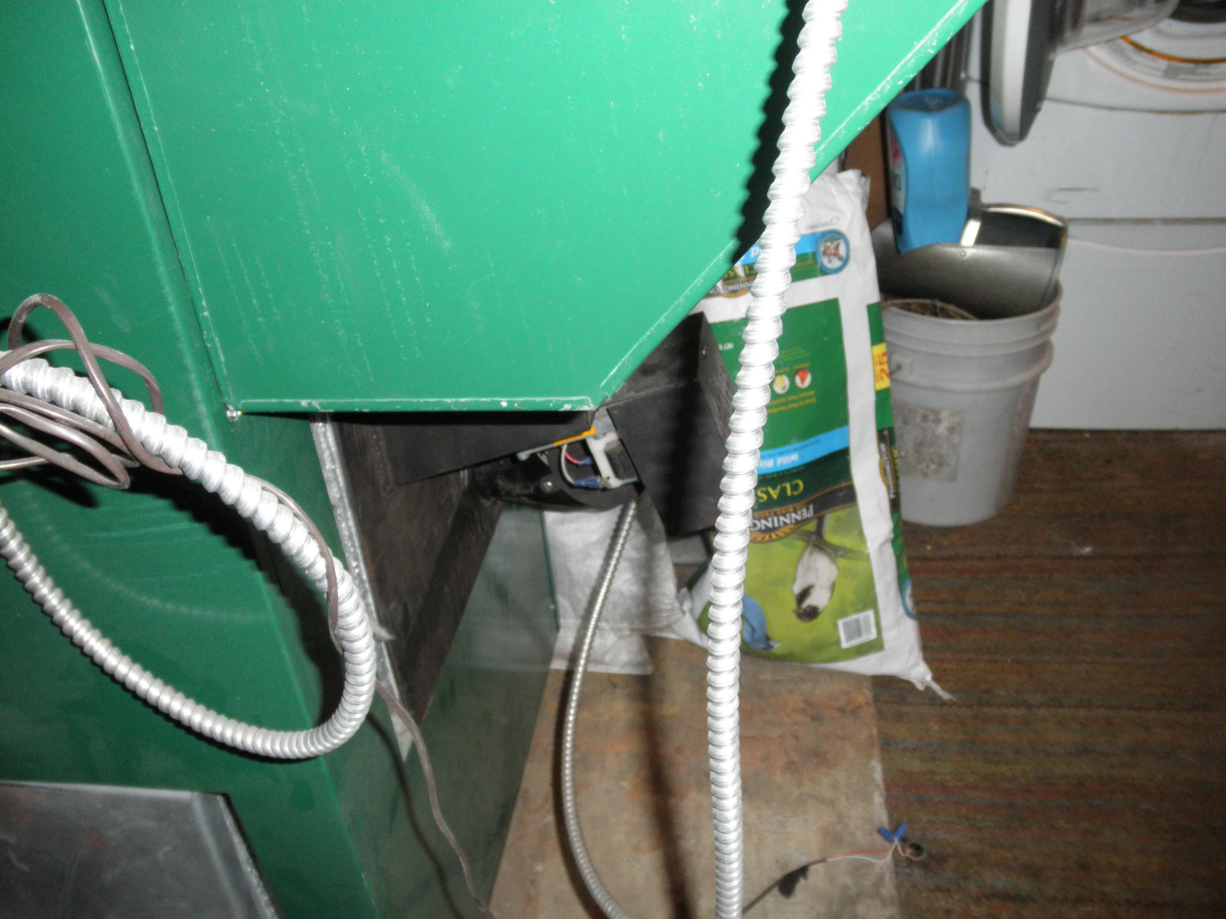

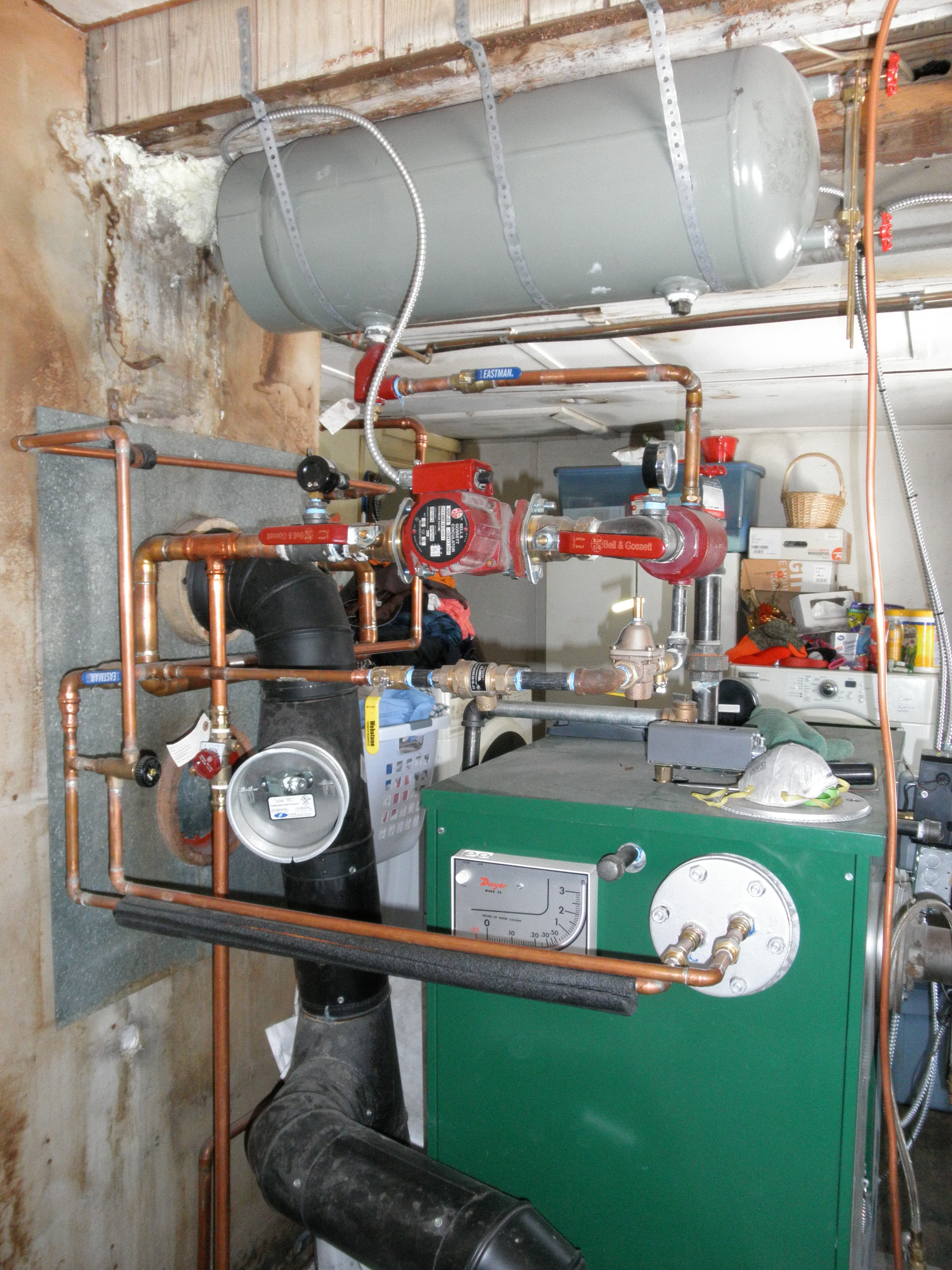

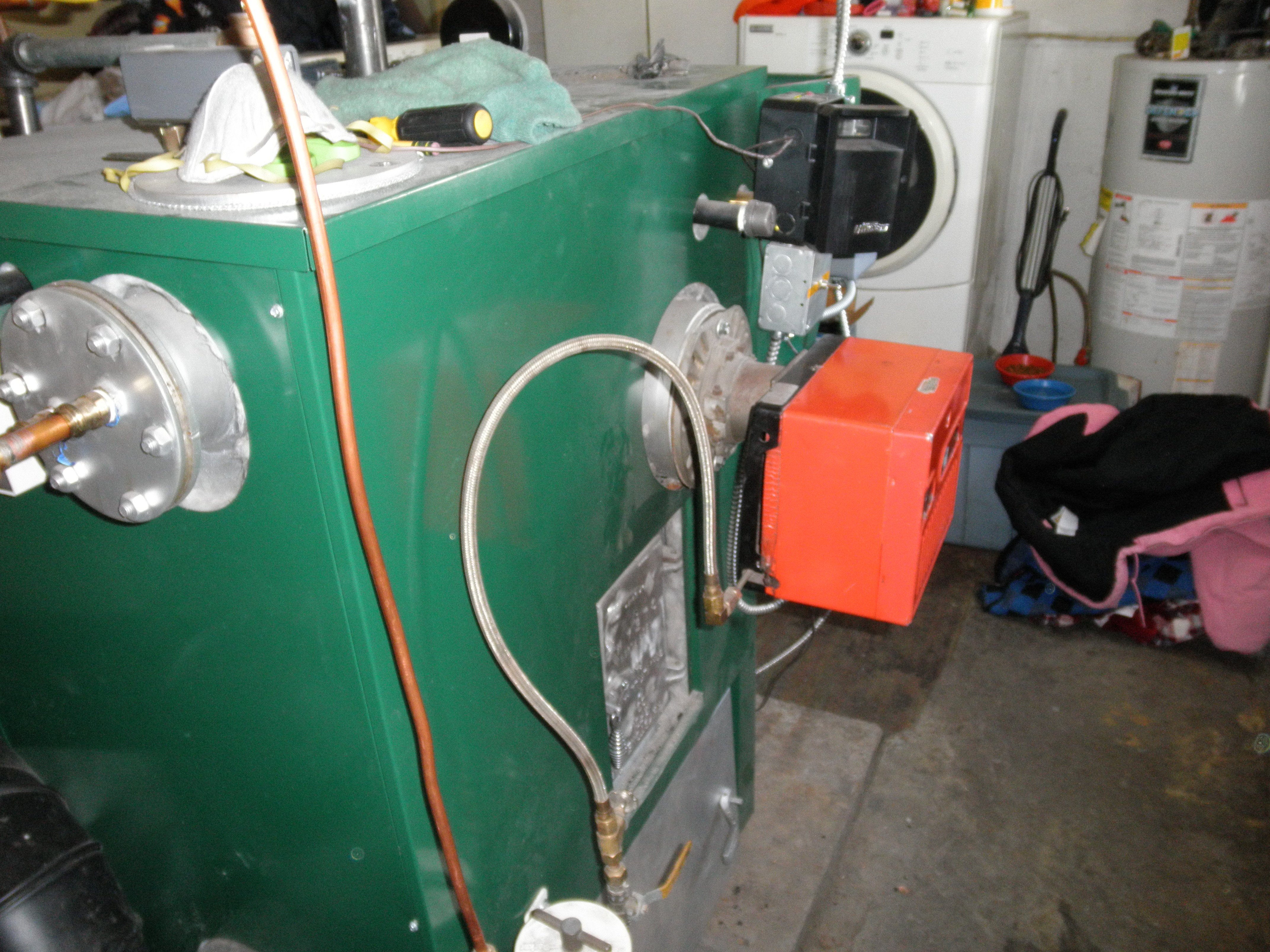

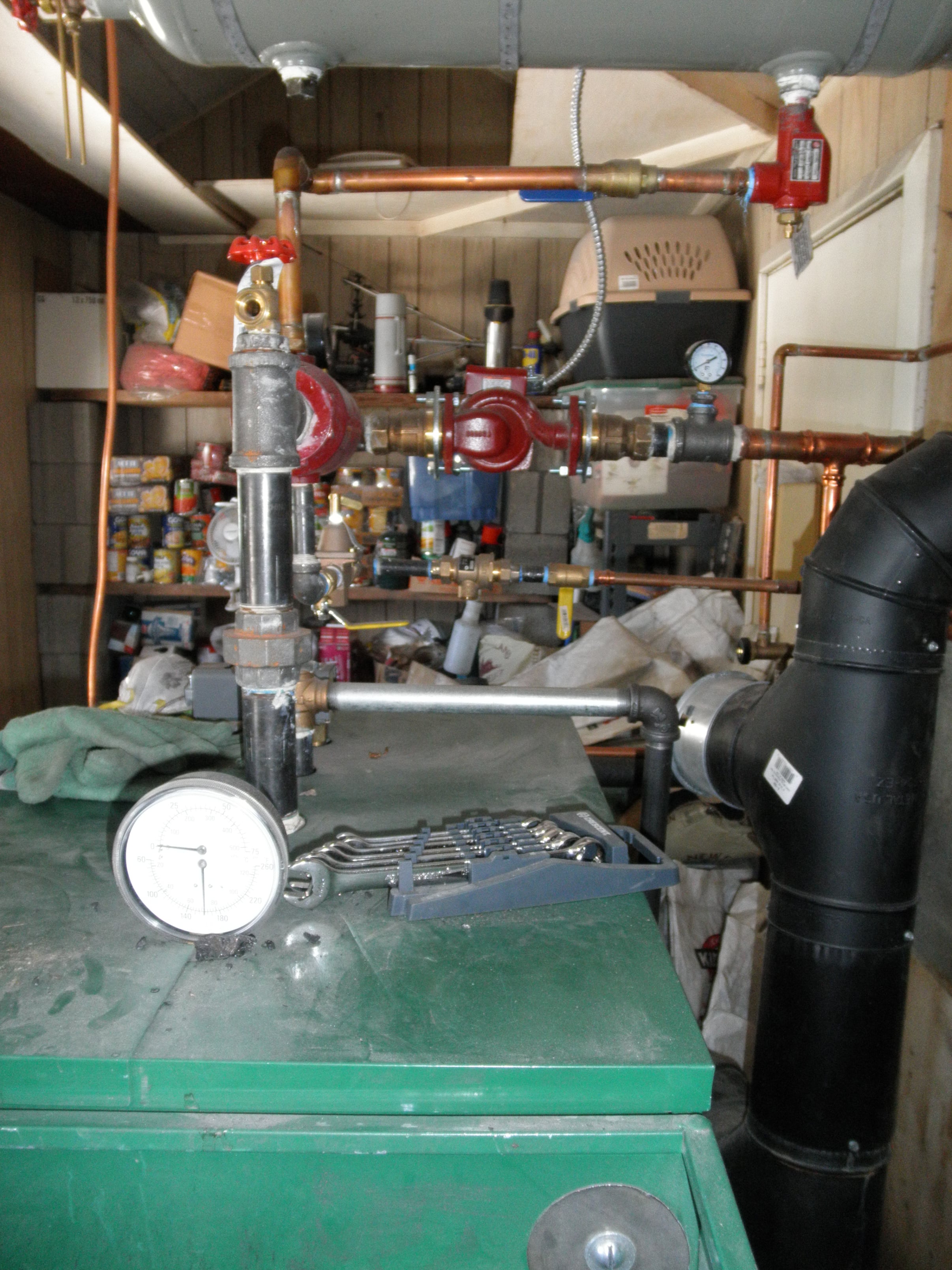

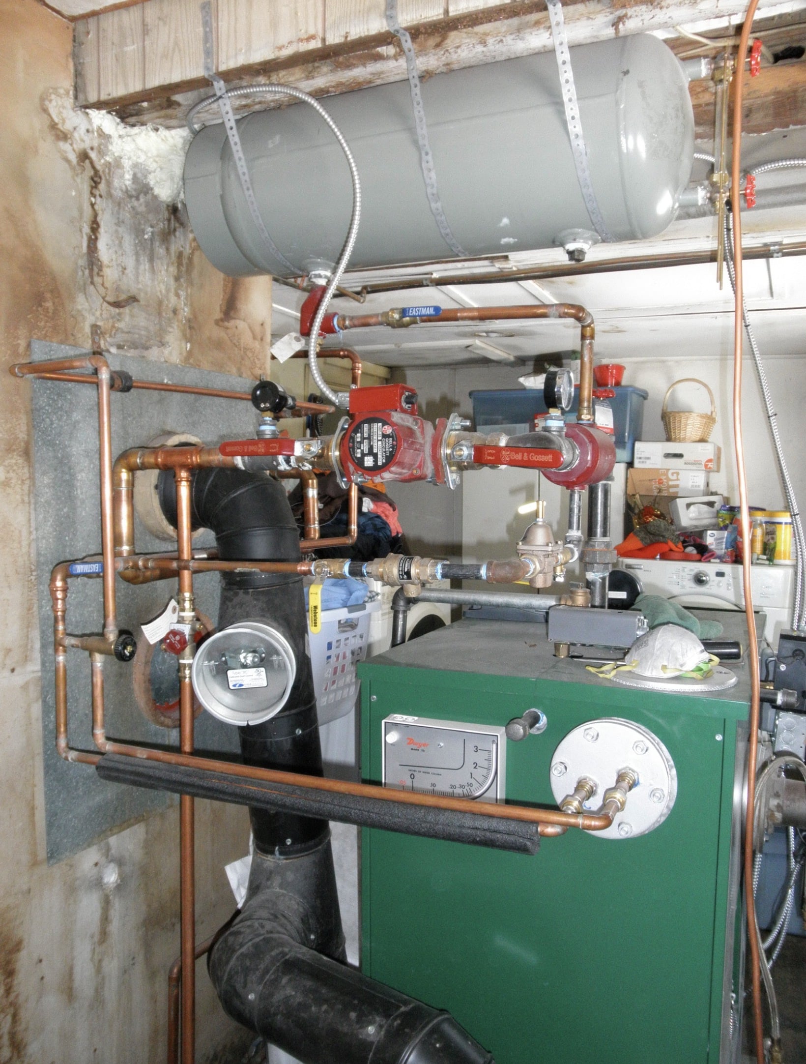

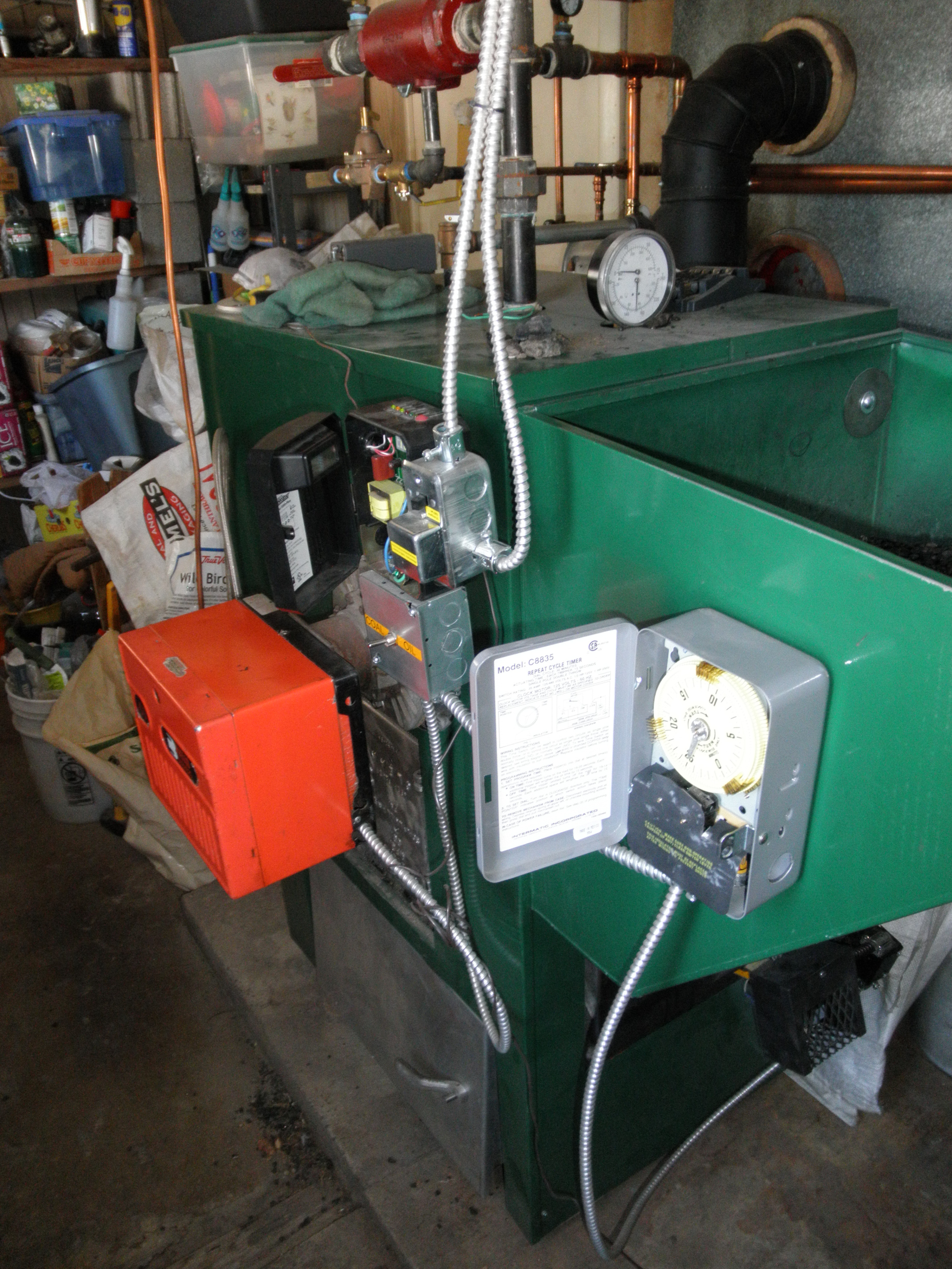

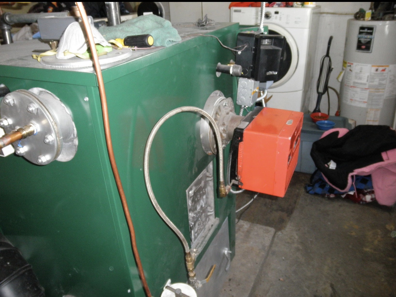

    The 30+ year old riello burner is gone and scrapped, I need a new oil tank and burner with a 2 pipe system if I am going to burn oil again. The oil tank is 32 years old and I would like to replace it with a highland petro hopper if I can no longer manage to burn coal anymore.
    My keystoker KAA-4-1 has an Intermatic 30 minute timer that controls the amount of time the stoker runs to prevent an outfire where the fire dies completely and the ash pail is filled with unburned coal.

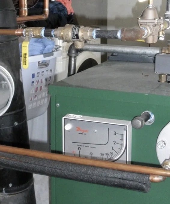

    well it is certainly a clean machine!
    A properly working BFD can spit from time to time, add the vent tube
    Hate to see that Dwyer get hosed

    Hello and good evening to you Bob,
    The last image is almost 11 years old, I moved the Dwyer Mark II to the door a long time ago and it is safe.
    I had the entire flue pipe replaced with new pipe 2 years ago and it makes cleaning the stove pipe easier as I have a Tee with a cap at the flue breech and a single sloped pipe to the chimney thimble which lets the fly ash fall back to the tee.
    I remove the cap and pull the fly ash out with a gloved hand when I hear the CO alarm go off or I check the Tee every month whichever comes first. I have a new roll of high temperature tape to seal the cap off when I take it off the tee at the flue breech.
    I just weighed the ash bucket and I apparently have generated only 6 pounds of ash since yesterday-YAY!!!
    So far so good and we are heating up the house slowly.

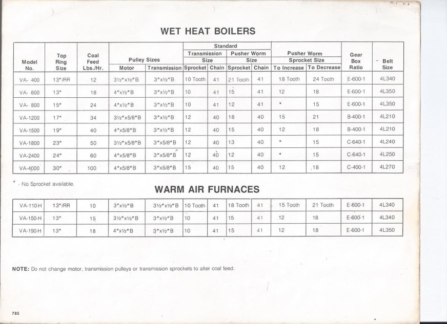

    I should have purchased the VanWert VA400 coal stoker boiler with the internal domestic coil and eliminated burning wood entirely. The VanWert coal stoker boilers and furnaces were underfed tuyere/burn pot stokers. What held me back from doing it was the installed price of $6,000.00 back in 1982. The installation cost of the CWW100 was $4000.00 at the time
    When I wanted to purchase a pot stoker in 2014 the EFMDF520 was $10,000.00.

    Bob, please forgive my ignorance but what is the BFD that you are referring to?

    More on the VanWert and AHS coal stoker boilers;
    I am providing a link to youtube which shows a coal mine strip mine electrician from the State of Montana talking about his S130 Coal Stoker.
    www.youtube.com/watch?v=pLvo3vJxgPs&t=5s

    hot_rod Posts: 28,830
    BFD is back flow device, this component.
    By code, and common sense🤔the vent port needs to be piped down to the floor or near a drain.
    They can spit from time to time if you get pressure variations upstream. With that valve off, less chance of a random spit.
  • leonz
    leonz Posts: 1,998
    Hello Bob,
    Thank you for clarifying that for me. I am so used to calling it a back flow preventer it went right over my head.
    My stoker has been working very well and in the last 9 hours has produced 5 pounds of ash.
    My resetting the hold fire timer in 6 groups of 2 minutes on the 30 minute timer has worked well.
    0-2 minutes, 5-7minutes, 10-12 minutes, 15-17 minutes, 20-22 minutes and then 25-27 minutes on the 30 minute timer.
    The hold fire timer only activates the stoker if there is no heat call so in my case if there is no heat call 12 minutes out of every 30 will cause the stoker to run to maintain the coal fire.
    I honestly think that my chimney being an 8 by 12 tile line chimney 16 feet tall is part of the problem requiring my adding pins to my hold fire timer each pin is equivalent to 15 seconds of operating time.
    When I had the 3 foot stainless steel chimney extension on the chimney making it 19 feet tall the stokers draft/ negative pressure gradient was high and the fire was very high in the fire box.
    If I had an 8 by 8 tile lined chimney 32+ feet tall the draft would be greater of course and my keystoker would not need the extended hold fire time to keep the stokers fire going. With a pot stoker it would not be an issue as the fire would be larger and the hold fire timer would only have to run 2 minutes every half hour.
    It certainly isn't helping. How does the height of the chimney compare to surrounding structures?
    Why didn't you turn the Keystoker 90 degrees and avoid the extra elbows in the fluepipe?
  • leonz
    leonz Posts: 1,998
    edited October 31
    Good morning Robert_25,
    The roof peak is slightly taller than the chimney; the surrounding conifers on both sides of the home and across the road at the Tilton farm house along with the willows and maple trees are almost 100 feet tall now and create the shelter belt that protects the home from high winds from the north and east.
    There was not enough room to allow the boiler to be installed in a direct line with the chimney thimble to do this as an egress point would have been blocked.
    Last year the flue pipe was replaced. The replacement flue pipe is set in this manner:
    The first item is the removable flue baffle in the boiler, the flue baffles job is to hold the flue gasses as long as possible to allow the boilers wet wall which the flue breech passes through and the steam chest to capture as much heat as possible before it enters the flue breech and then the six inch tee.
    The flue breech at the boiler is met with a 6 inch tee with a cap to allow the easy removal of fly ash that collects behind the removable flue baffle.
    The next item is the short straight stove pipe set at about a 45 degree angle. The next item is a 45 degree adjustable elbow, after the 45 degree adjustable elbow a Tee holds the barometric damper and then the short flue pipe coupler allows the transition to a 90 degree adjustable elbow which meets the 6 inch to 7 inch reducer at the chimney thimble.
    The new stove pipe is half as long as the original piping that used 2 fly ash traps. The new stove pipe arrangement is much easier to clean also.

    I am happy to report that the stoker is making lots of heat and with the stoker mechanism at 12 threads out.
    My changing the hold fire timer settings to create six 2 minute hold fires over thirty minutes has made all the difference in how the stoker operates and how little coal I am now burning.
    It is not pushing a great deal of rice coal across the fire grate during a 2 minute hold fire AND the rice coal that is being burned is burned more slowly creating the fine light ash that I am seeing.
    After a 24 hour burn period the 4.5 gallon ash bucket is not full of ash as the rice coal is being burned more slowly creating a light fluffy ash and I have a thick bed of dead ash on the end of the fire grate as tall as the side rails of the stoker.
    The original stoker motor in the stoker now operates at 2 revolutions per minute, the new spare stoker I have operates at one revolution per minute and look forward to burning even less coal than I am now.

    The 30 minute Intermatic timer has become a better regulator of coal consumption for me as the two minute run time has reduce the time needed to make hot water and the summer settings of 140 Degrees Fahrenheit low limit and 160 degrees Fahrenheit high limit are well placed as the boiler quite often reaches 180 degrees Fahrenheit quickly and dumped at 190 degrees Fahrenheit back down to 180 degrees Fahrenheit low limit on the L6006L aquastat.
    So anyway, my Intermatic 30-minute timer is set as follows.
    O-2 minutes on
    2-7 minutes off
    7-10 minutes on
    10-12 minutes off
    12-15 minutes on
    15-17 minutes off
    17-20 minutes on
    20-22 minutes off
    25-27 minutes on
    27-0 minutes off
    The stoker timer will run to hold a fire is there is no heat call and the 3 minute periods when there is no fire the coal on the fire grate is still burning and will reignite the unburned coal being fed across the fire grate.
    If there is a heat call the hold fire timer settings are bypassed until the heat call by the fire burning on the fire grate until the thermostat is satisfied.
    I finally settled on these timer settings in six 2 minute hold fire periods because of my chimney and experimenting because the recommended timer settings will not keep a fire lit and results in an outfire.
