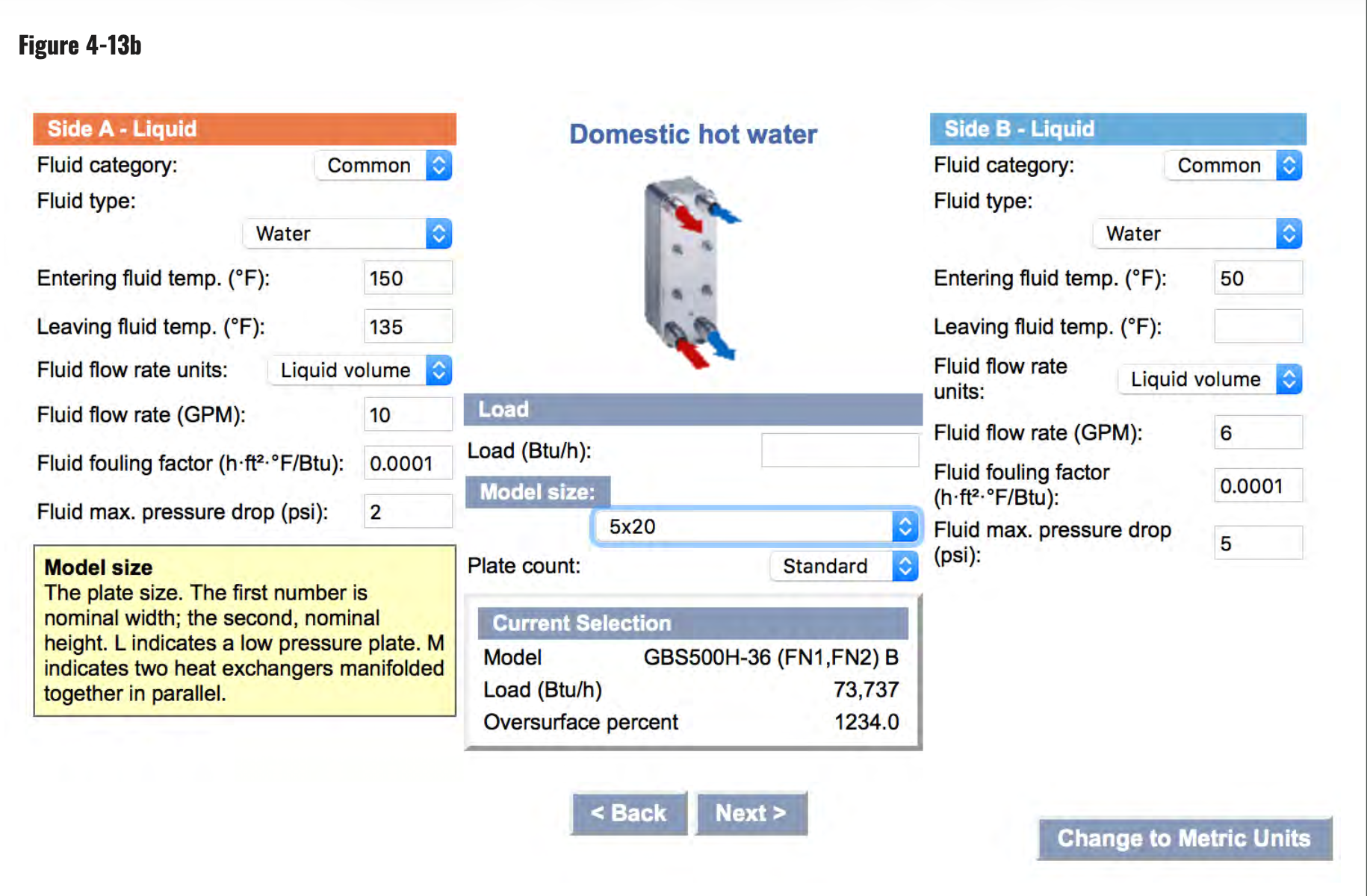

    Or this program will allow you to enter Load BTU/ hr and do flow calcs for you.

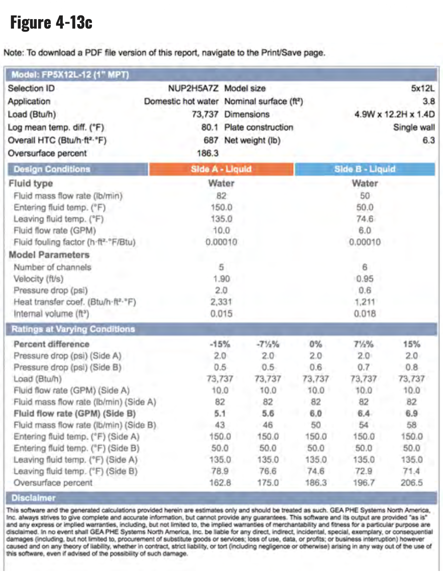

    The print out looks like this
    But I doubt you would find a quality, speced plate HX for that price.
