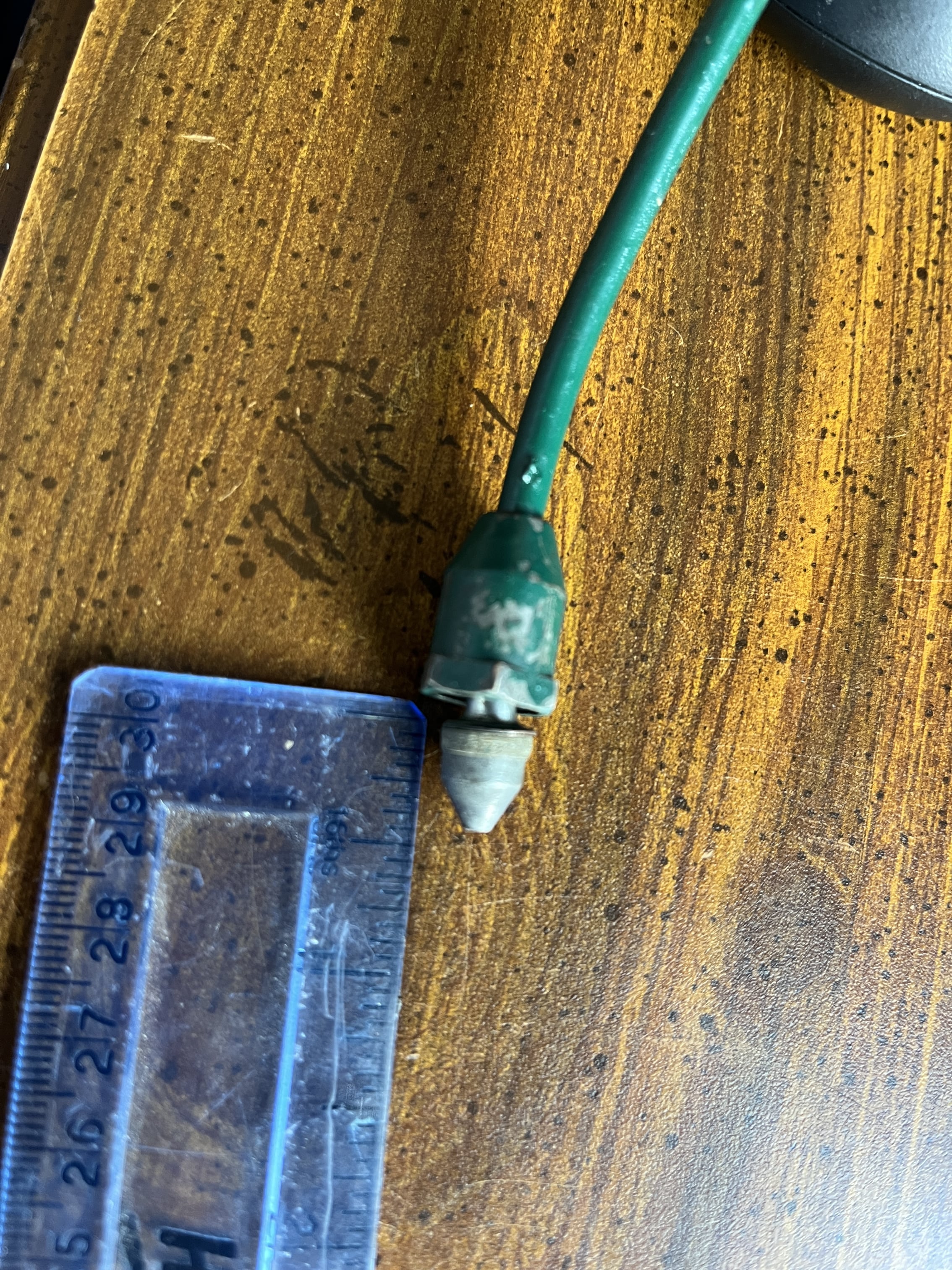

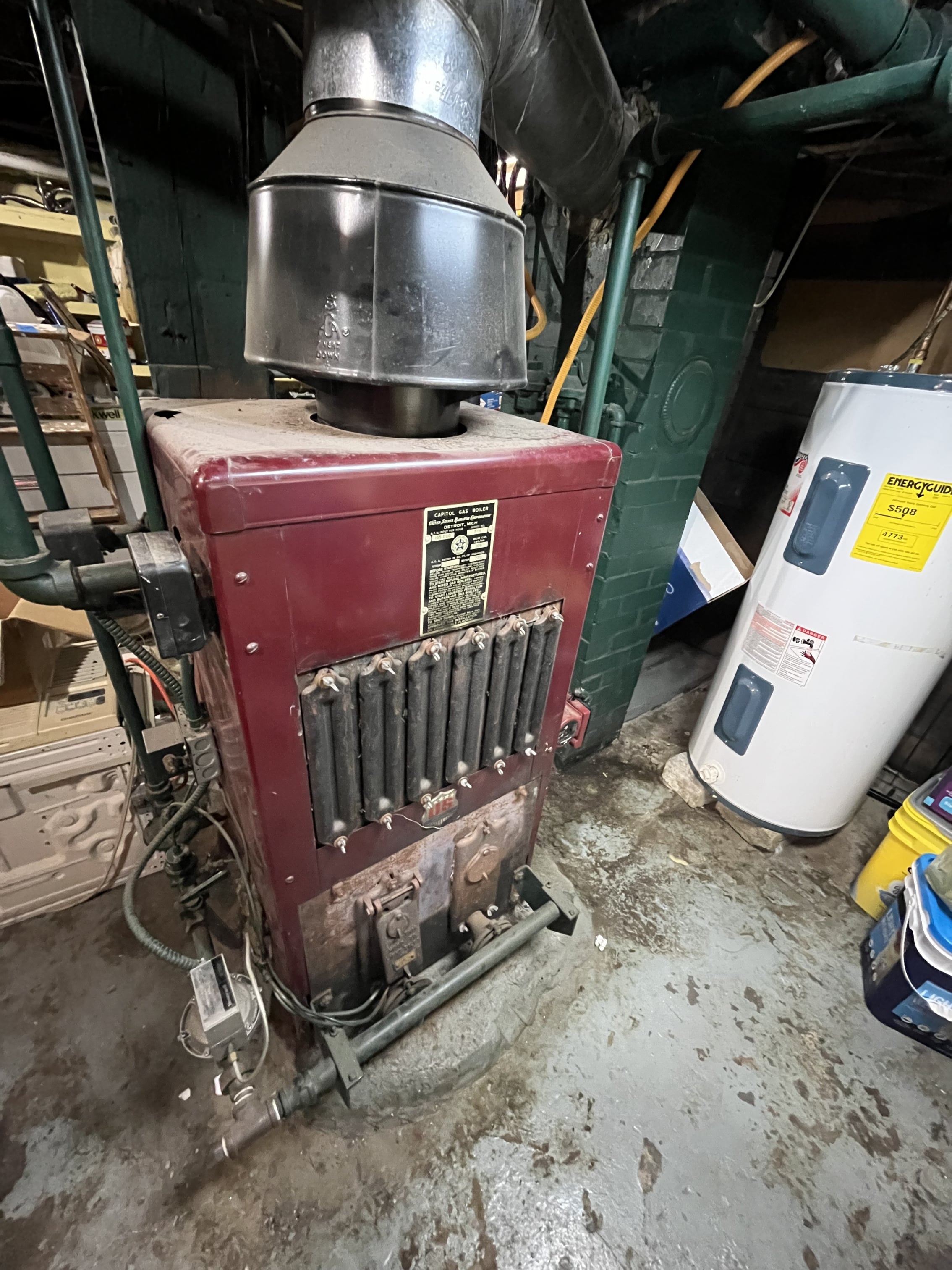

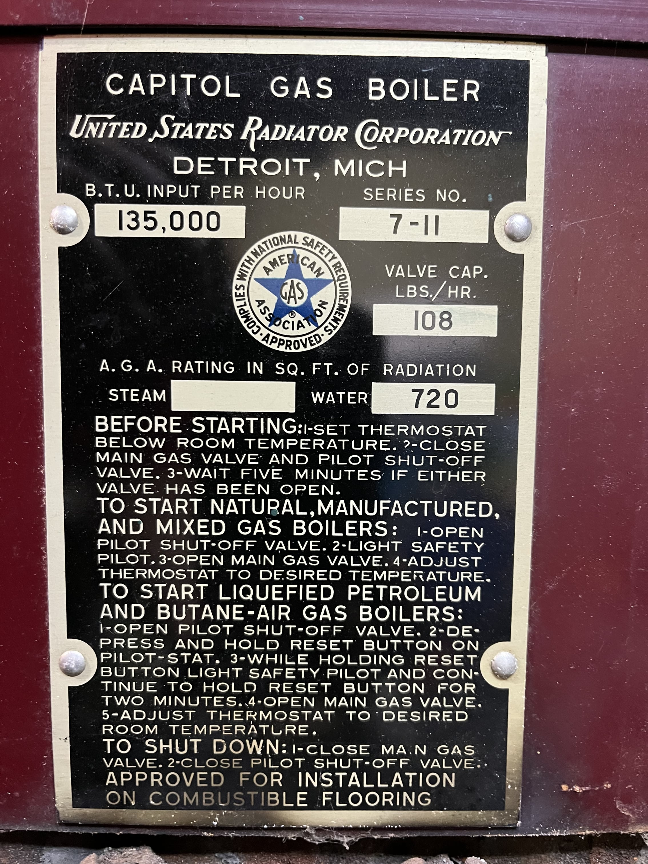

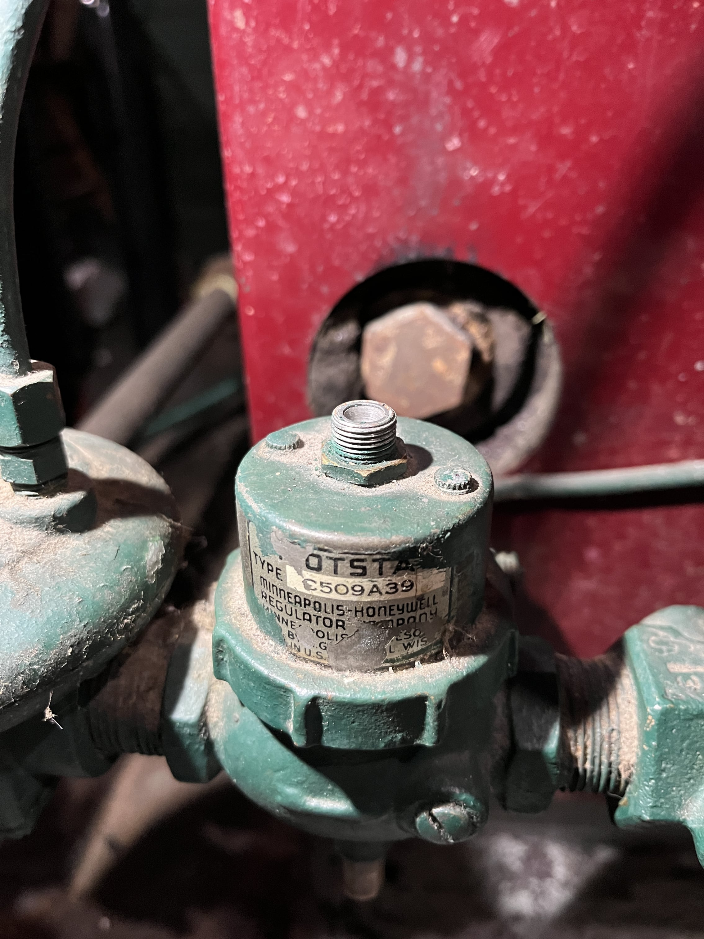

Hello out there! I am trying to track down a replacement thermocouple for my very old boiler. The boiler was made by United States Radiator Corporation of Detroit, series 7-11. Many of the parts were made by Minneapolis Honeywell (Aquastat model L-444, Pilotstat model C509, Gas valve type V88A).
Searching for U.S. Radiator gets me virtually nothing (a company of the same name appears to make radiators for cars now.) Honeywell is a bit more promising, with some info coming up for searches regarding their parts.

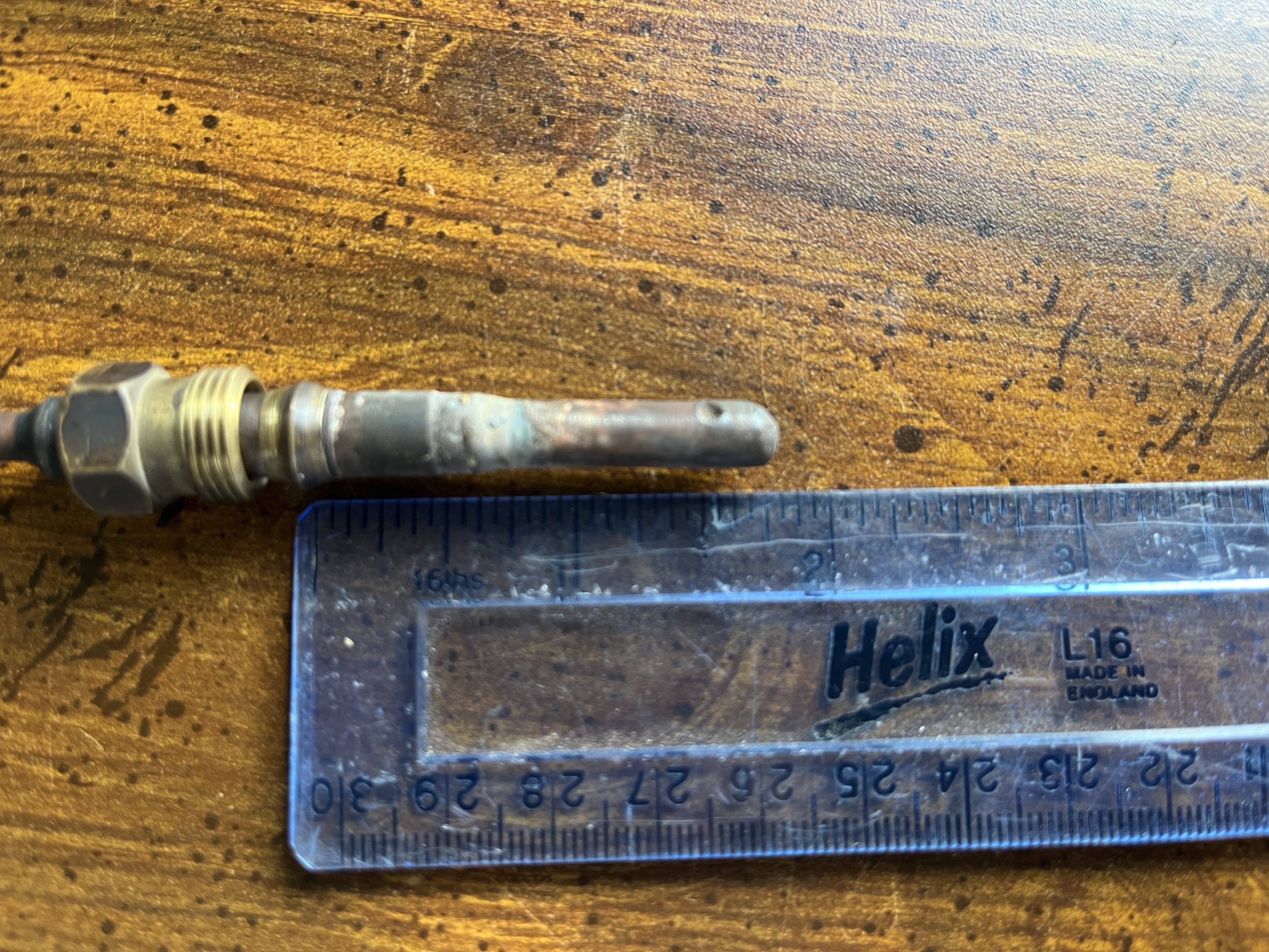

I took my thermocouple to just about every place in town. The general consensus is that it seems large and meaty for a run of the mill thermocouple. The odd shaped end and female threads also raised eyebrows. An old paper for the pilotstat mentions thermocouple models Q234 and Q235, among others. Thickness of mine is 1/4 inch.
Surely I cannot be the only person in this predicament. Has anybody here had any luck with finding one? Seems it would be a shame to replace the whole boiler over one small part.
Not a standard thermocouple. hard to find one of those if at all.
There is/was a thermocouple adaptor that should take the standard Q340A thermocouple and allow you to use it on that male thread. the part number is/was Honeywell 390012C Power Unit Female Adapter. This information is very old and may no longer be available. There was an eBay listing for those adaptors. You can also google the part number and see if you can find them somewhere. Good Luck

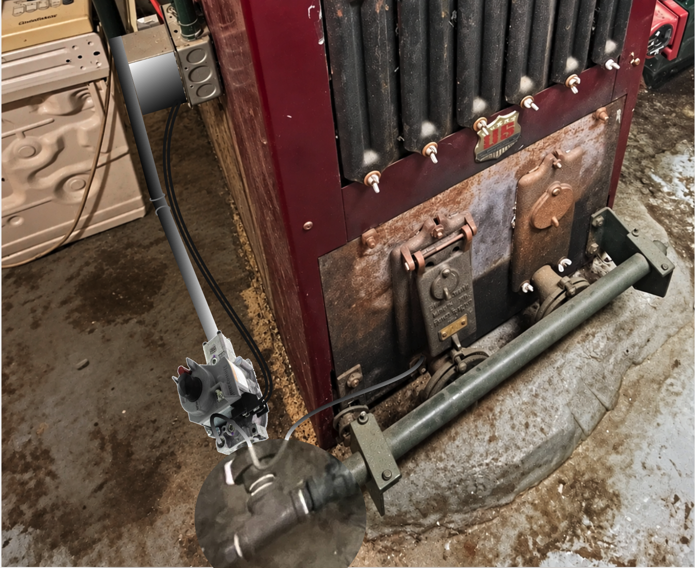

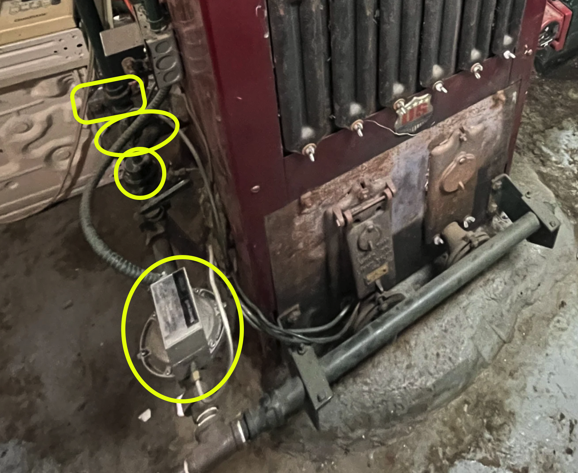

Common practice is to tell you it's time for a new heating system when you have parts that old. But some mechanics may be able to scrap that old gas valve, pilot switch, and pressure regulator setup and, with a few 3/4" pieces of pipe and some fittings, install a new gas valve that has the pilot switch, pressure regulator, and redundant valve all in one modern part. This might be the way to go.
See the 4 items circled in yellow…. all 4 of those components are built into the modern gas valve and you can remove all the old parts and install one gas valve that will do the job.
Here is what your boiler might look like after the new gas valve is installed.

Agree with Ed. Modernize the gas train and pilot assembly if you're not going to upgrade the whole system. If you're going that far and want to feel a little safer, I'd MacGyver a Rollout switch between the burners and install a Spill switch on the bell.
Back in the late 1960's and early 1970's I carried a few of those thermocouples in my service truck. The were made by Penn Baso and listed as a Husky with a model # of K16, if I remember correctly. I recently saw one on E'Bay listed as a Husky K16-060 and was selling for $18.99. However, that said I would highly recommend as the other guys have stated It is time to replace the gas train components to add much more safety to your system.
I’m one of the older techs who much rather repair than replace but at some point it’s time to upgrade to new equipment. I know it probably runs great but alot of that heat is going up the chimney. I love the old stuff but sometimes it’s better to bite the bullet and upgrade for safety, efficiency and resale value.
