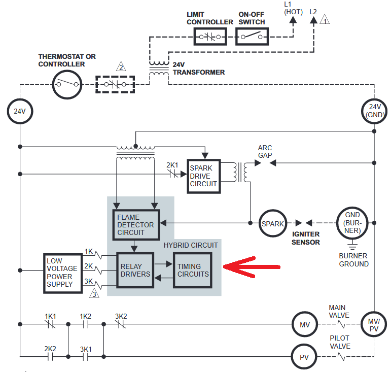

    I suppose since the Ignition module has timing circuits that could have issues. But that does not explain the " The burner flame starts off weak "

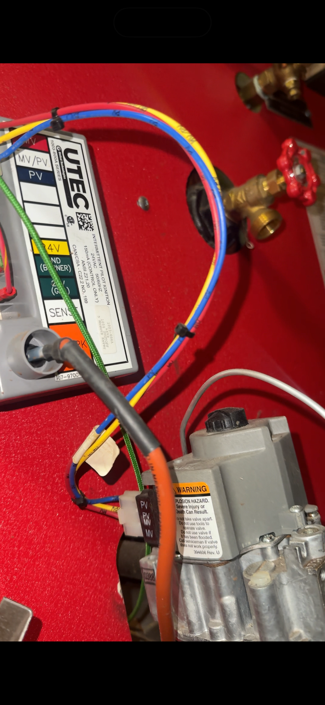

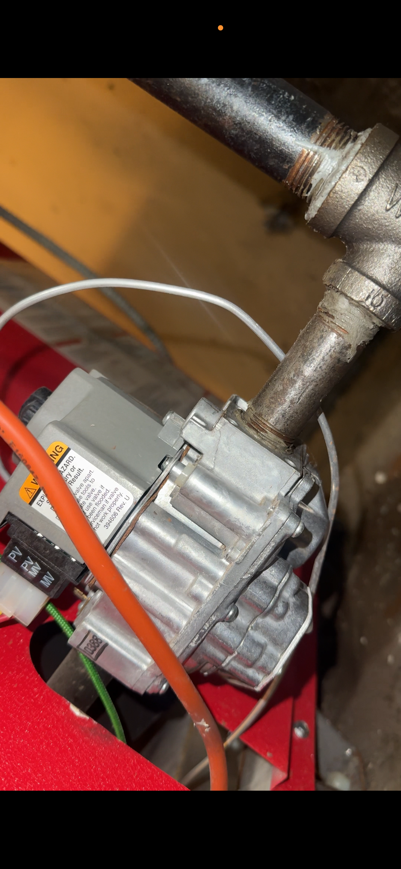

    hello thank you everyone for your suggestions. I do not know how to reply to each response individually so I’ll do it all here. I know from the other boilers with the exact same ignition system, after the pilot is litt the burners fire to regular rate right after. Mine is taking around 1 minute or longer. It begins with a weak fire rate, then gradually fire to normal fire rate. I did not check the gas pressure on the valve, as it was set upon its installation. I will have to buy a manometer to check it.
    I know I have adequate gas pressure coming from the street because the water heater right next to the boiler is working just fine with its burner. And I’m not sure if it’s the pressure because like I said after about a minute or two the boiler fires normally at full fire rate. The ignition panel is a UTEC model. I confirmed that there is 24V being sent to the gas valve on the MV/PV & MV terminals after the pilot fires up. I am also hearing both clicks from the PV & MV in the gas valve. As for cleaning the flame sensor, I did lightly brush it, and the entire pilot assembly and cleaned it. When did that yesterday the pilot began lightly almost instantly, as before it was taking a long time. I’m not home so I can’t get the exact model of valve, but I will attach pictures of the spark pad and gas valve.

    Steamhead Posts: 19,023
    The model number on that valve should be on a sticker on the other side. I'd bet it's a VR8204H or VR8304H.

    Those pictures show that it is not the White-Rodgers mercury flame sensor design I talked about in my previous post. However, there are still slow-opening Honeywell gas valves. I’m not sure that you have one of those.
    I installed that type of boiler, and I don’t remember that boiler using a slow-opening valve.
