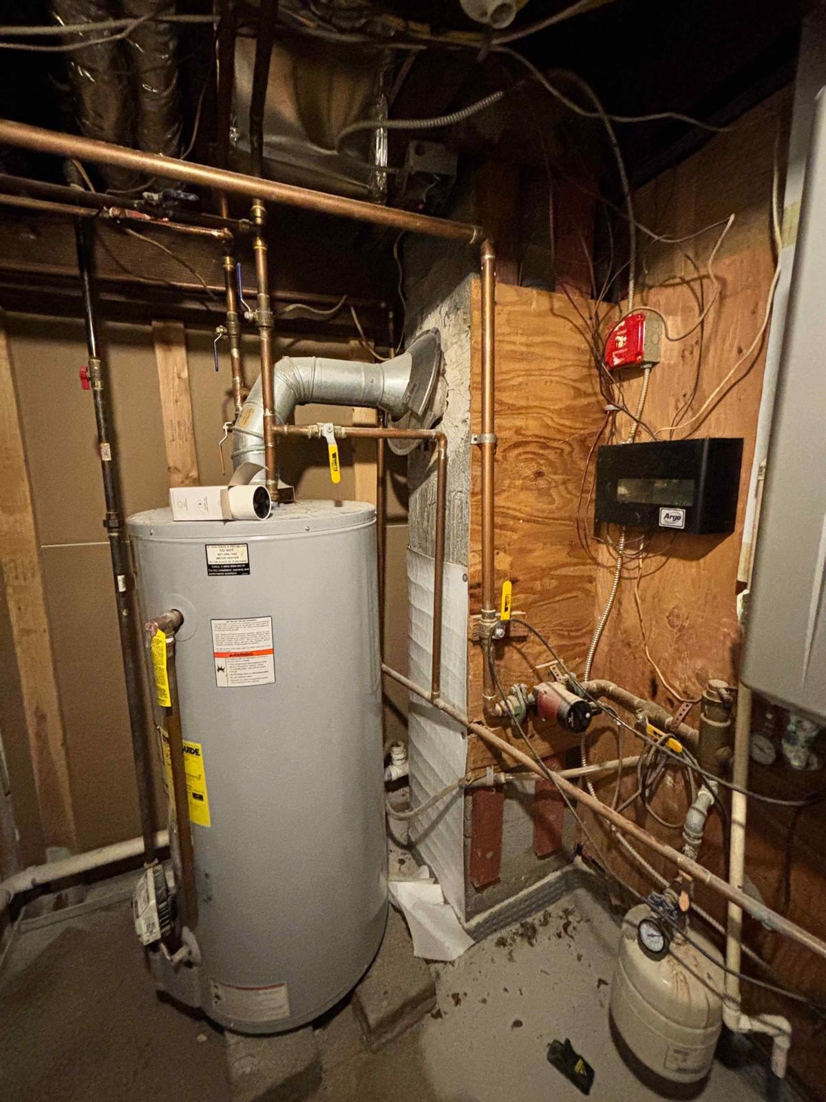

SYSTEM
  • Noritz NRCB199DV, manufactured Oct 2018. Space heating only - the DHW
    ports are capped, domestic hot water comes from a separate gas tank.
  • Rating plate: heating capacity 120,000 Btu/h.
  • Supply setpoint 160-165F.
  • Four zones on an Argo panel - zone valves, one circulator, plus the
    boiler's own internal pump.
    1. Basement baseboard
    2. 1st floor baseboard
    3. Owner's suite baseboard
    4. 2nd floor apartment, forced hot air through a 12x15 water-to-air
      coil in an attic furnace
  • Boiler is in the basement. The attic coil is above the 2nd floor -
    call it three levels of rise.
  • Mix of old iron/galvanized and copper. Municipal water.
  • No record of the heating side ever being flushed, cleaned or treated.
    No real maintenance for many years.

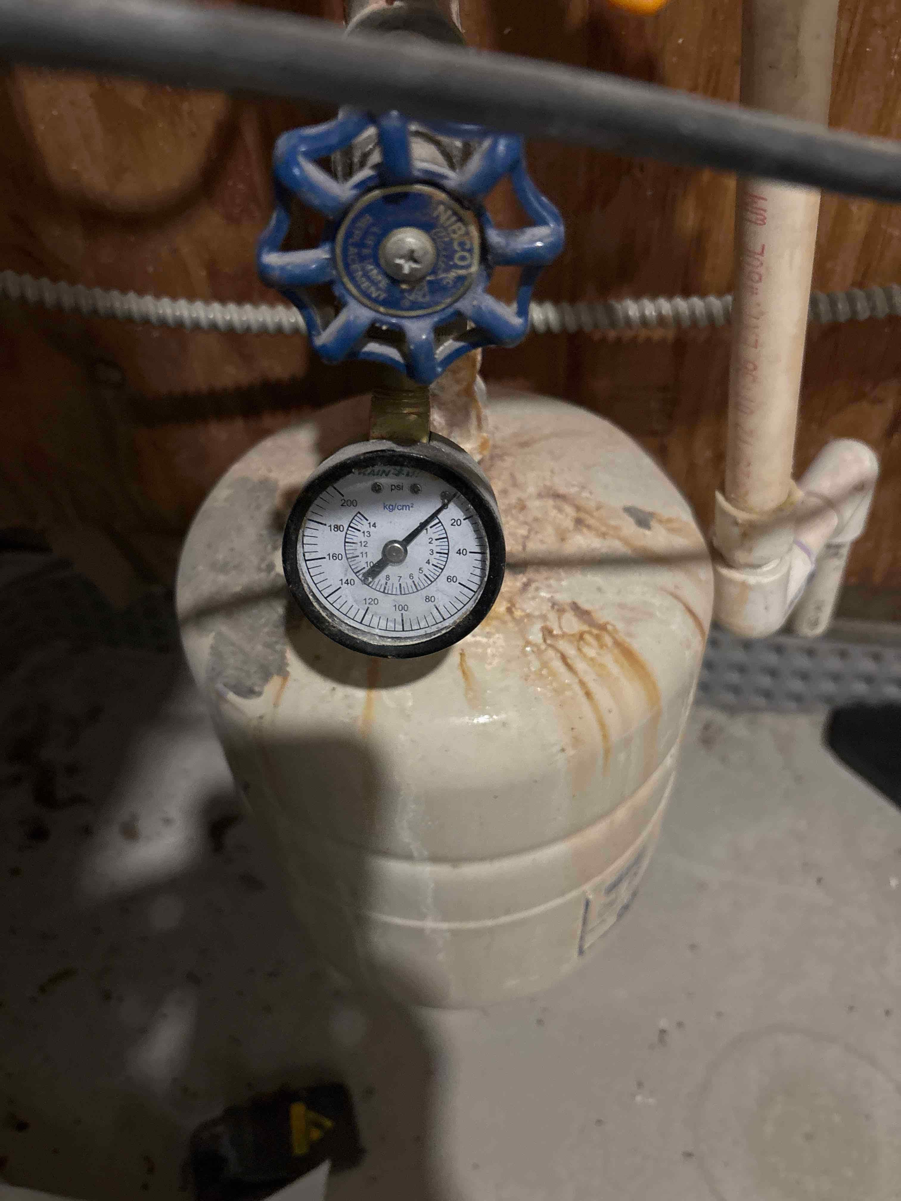

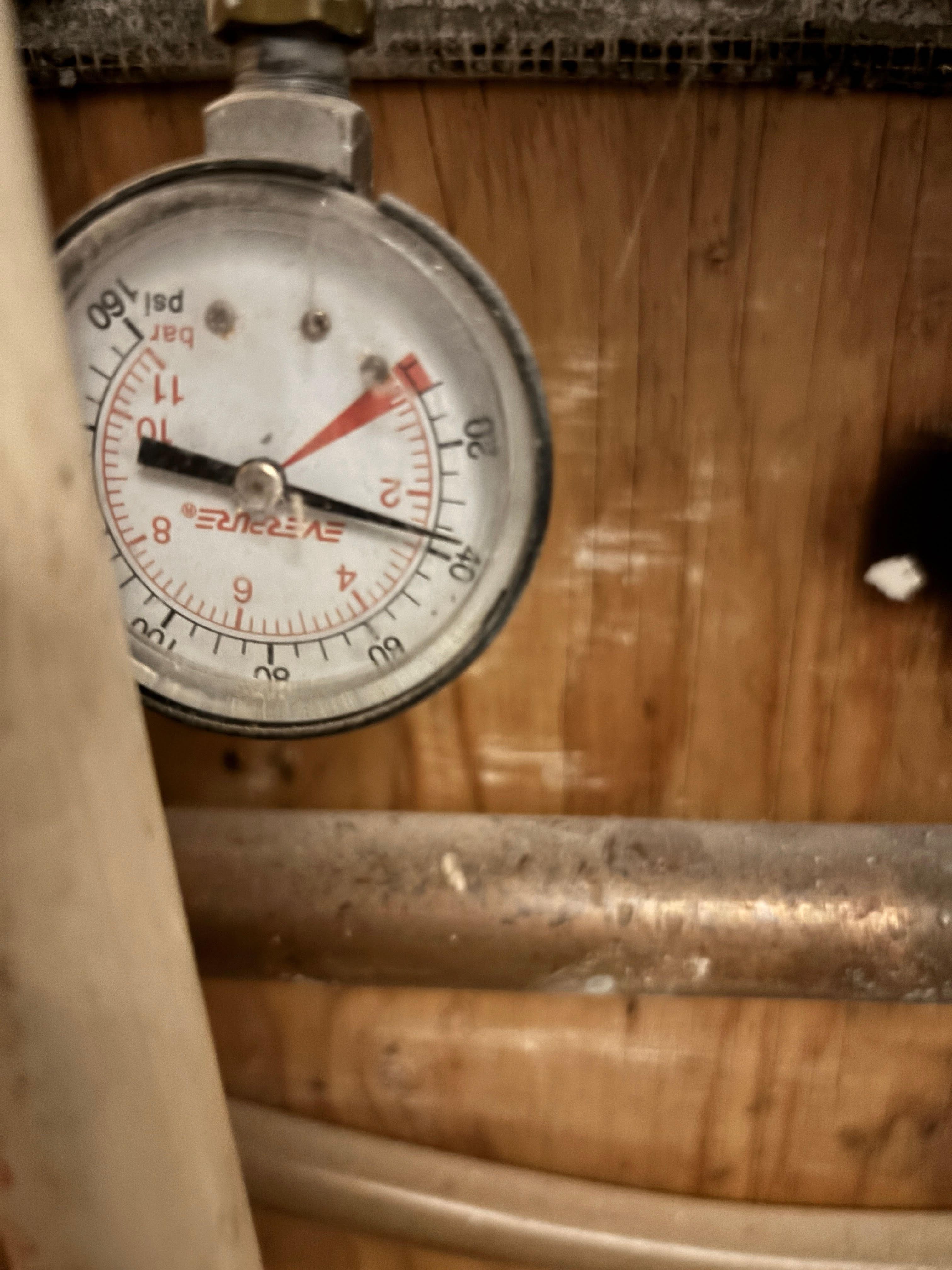

So a DOMESTIC water expansion tank had been sitting on my hydronic loop,
along with a domestic 0-160 psi gauge (photo 4). Both were replaced with
an Amtrol #30 and a new gauge. Nothing on the invoice about setting the
tank pre-charge. The relief valve was not touched.
Less than a year later the E57 timeouts are back.
The expansion tank sits on the floor in the corner, several feet below
the boiler (photo 1, bottom centre). The new one went into the same
spot, just larger.
NO VISIBLE LEAK
Nothing wet, no puddles, no staining on the floor. The only thing I can
see is rust-brown streaking running down the side of the OLD tank in
photo 3.

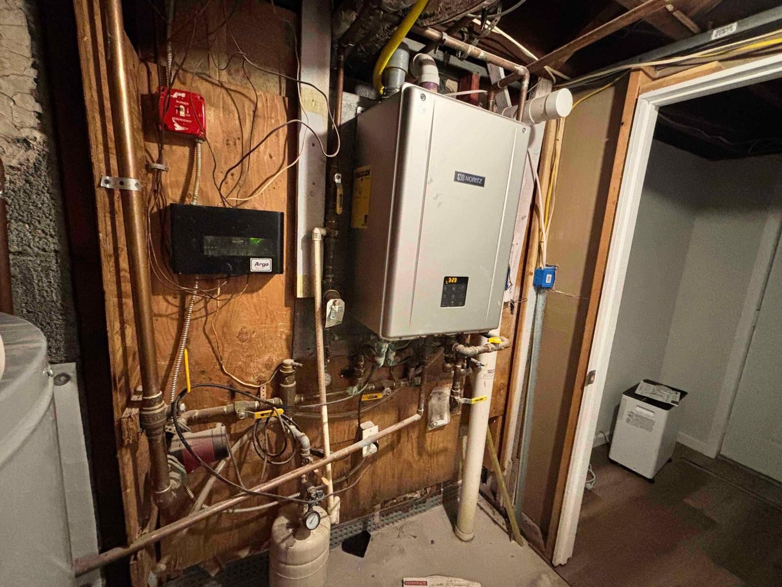

  1. Near-boiler piping. Argo panel on the left, old expansion tank on the
    floor at bottom centre.
    2. Same wall with the boiler's front cover off - taken by the plumber
    during that visit.
    3. The OLD expansion tank, the domestic one. Note the rust staining
    running down the shell.
    4. The OLD pressure gauge. Everpure, 0-160 psi.

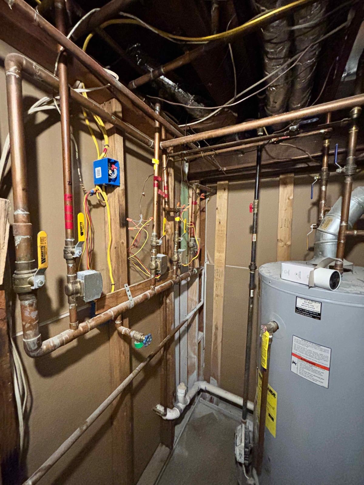

    5. Zone valve manifold, on the wall opposite the boiler.

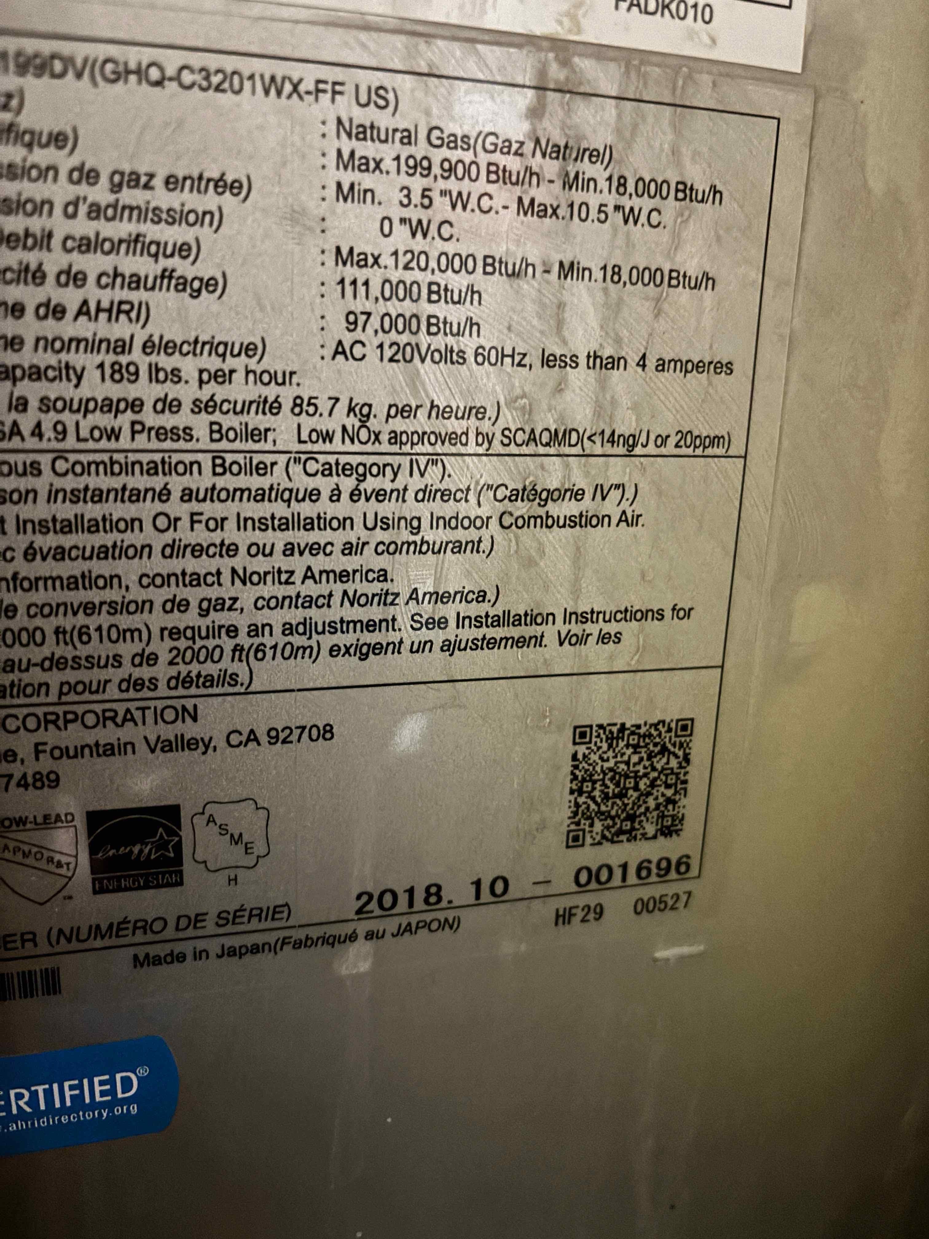

    6. Rating plate.

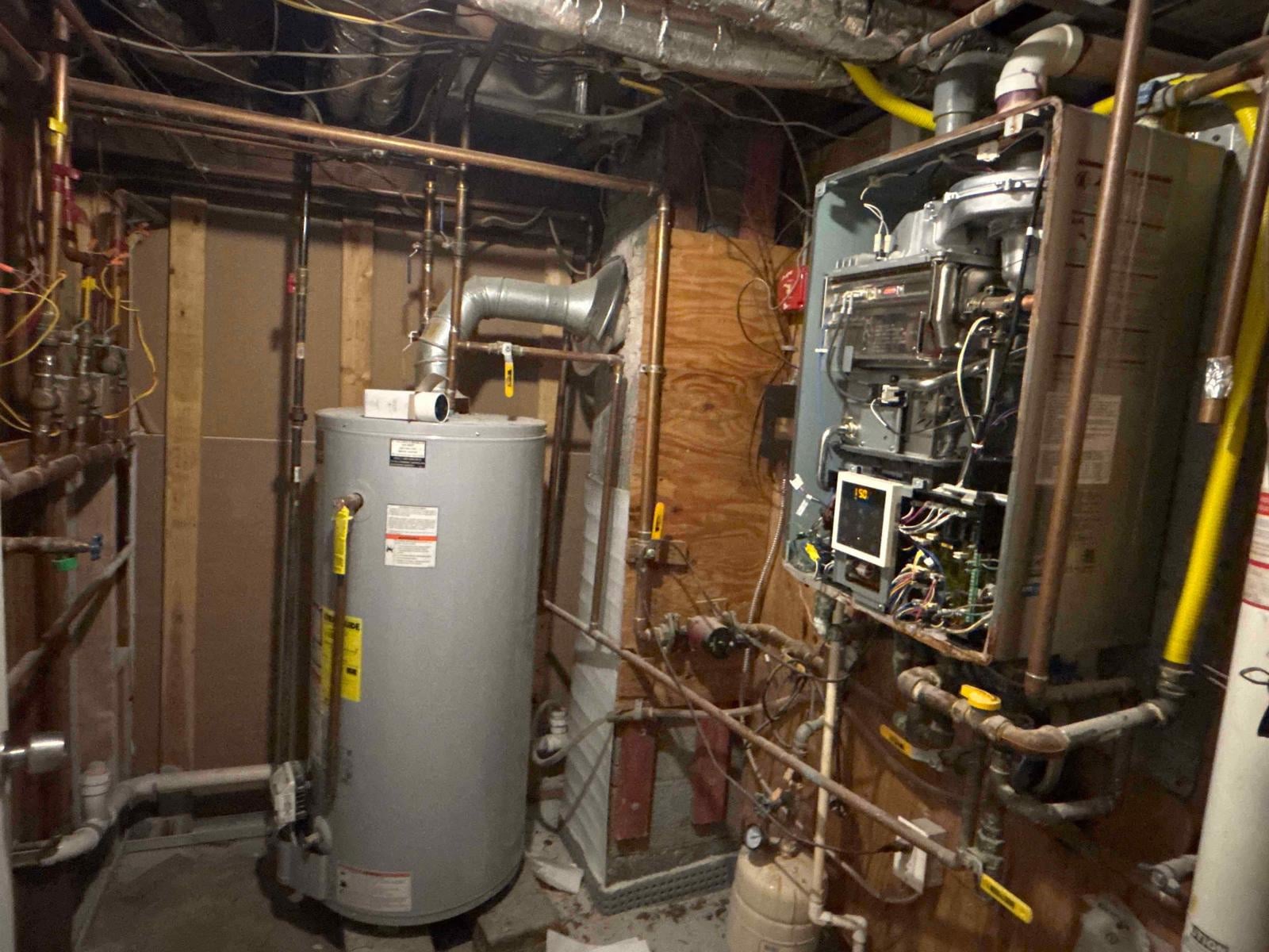

    7. Other side of the room - separate gas DHW tank, Argo panel, the
    circulator, and the old expansion tank on the floor at right. 1-Near-boiler piping. Argo panel on the left, old expansion tank on the%0A   floor at bottom centre.jpg

  1. What makes a feeder screen collapse and turn inside out? I assume
    flow went backwards through it. What drives that?
  2. If a domestic tank (40-ish psi pre-charge) was on a loop running
    15-20 psi, am I right that the diaphragm never moved and I effectively
    had NO expansion capacity for years? And would that have had the
    relief valve lifting and reseating every cycle - dumping water, the
    feeder making it up, over and over? If so, is the relief valve seat
    likely wrecked by now and weeping on its own, even with a correct tank
    fitted? It was never replaced.

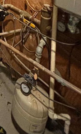

  4. The tank is on the floor several feet below the boiler, and there's
    both an internal boiler pump and a separate circulator (photo 7). How
    do I confirm the tank is on the right side of the pump? If it's
    wrong, could the pump be pulling the top of the system toward zero
    every time it runs?

    On primary/secondary: this is the part I don't know how to assess. There's
    the boiler's onboard pump plus a separate circulator and four zone valves
    on an Argo panel. What should I photograph so you can tell whether it's
    piped primary/secondary or not? I'm at the unit Wednesday and I'd rather
    shoot the right things once.

    Ideally you want the fill valve connected the point of change. So pumps cannot change the pressure at that point.
    Yes it is possible to pull a negative pressure which could allow fill water to constantly enter when a pump runs, whick keeps the relief seeping and even more fill water.
    You have a valve on the expansion tank, drop the tank, add a tee and put the fill/BFD there.

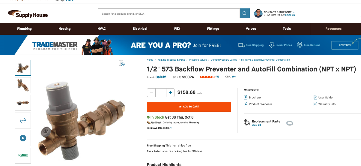

    1. If I move the fill/BFD to a tee at the expansion tank, does that on
      its own rule out a leak, or should I still run the decay test first?
      I'd rather not fix one cause and assume it was the only one.

    hot_rod Posts: 28,799
    yes you certainly want to rule out a leak first off. That is fairly easy to do, with an overnight test.
    A bucket under the pressure relief valve tube tells if it seeps or discharges ocassionally. That is a cheap and easy fix if the valve is seeping
    It takes a few conditions to pull a negative pressure. Low fill, a high head circ and the placement of the circ in relation to the exp tank. It’s not common, but a possibility

    Update, and a sanity check on the plan before I hire someone.
    Correction first: the crystallization I mentioned is at the backflow
    preventer's vent discharge, not a relief valve. The heating relief
    discharge is dry.
    What I measured (NRCB199DV):
    • 7.5 psi cold. On power-up the feeder fills fast to 12, then
      crawls, and throws Error 57 at 600 s. It doesn't open at all
      from 10 or 12.5.
    • Expansion tank pre-charge is 12. Same knee whether I'm filling
      it or heating it from cold.
    • Still losing pressure: 12.5 after filling Wednesday, 10 cold
      Thursday, Error 57 on its own Friday morning. Floor is dry.
    • Feed line sits at 30 cold and climbs to 60 whenever the boiler
      fires. Water trapped between the BFD and the feeder solenoid.
    From the manual (Installer Mode I:14_HPS, default 12): fills below
    8, stops at 14. Going from 12 to 14 is only about 0.3 gal into an
    Amtrol #30, yet mine gained under half a psi past 12 before timing
    out. So flow through the feeder is choked. Noritz's Error 57

    Plan, per hot_rod and Noritz §9.1 / §18.1: drop the tank, put the
    fill and BFD on a tee there, pre-charge = fill = HPS (about 18 for
    the height, I'll measure), switch the internal feeder off
    (I:15_AFA) and cap it, and confirm the circulator pumps away from
    the tank.
    Separately, on the Argo AZ-6P one zone shows green but never red.
    The valve never proves open, so the boiler never fires for it.
    That's the cold room.

    Turns out your test has been running since Friday: after a 57
    this boiler won't fire or feed until it's power-cycled, and nobody
    has touched it. It went from about 7.5 Friday morning to 5 now
    (remote camera, checked against a photo of the dial). Not zero,
    though the house has been unheated, so some of that may be
    cooling. Last time it sat at 7.5 for days.
    Could the leak be above the gauge, so it stops once the pressure
    up there hits atmospheric? 5 to 7.5 psi would put it roughly 12
    to 17 ft up. I'll keep watching it another day.
    On the zone valve, that matches the Argo manual and a local
    contractor, so I'll have the wiring and power head checked. He
    also recommends the fill at the tank under the air eliminator,
    pumping away, and an ECM circulator on the secondary.

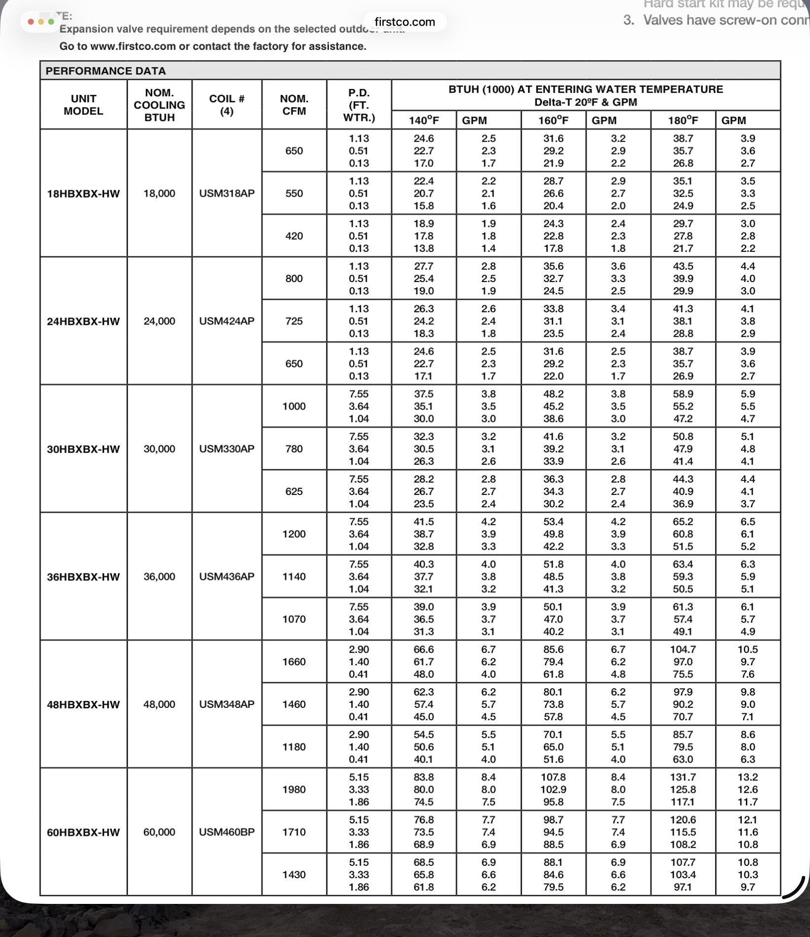

    Last question, on the second-floor hydro-air zone (coil in the
    attic air handler, about three storeys up). The proposal was 180F
    for the baseboard zones, with a mixing valve and circulator
    taking the hydro-air down to 145F. Does that make sense for a
    hydro-air coil, or does it need the hotter water? Its supply pipe
    also only ever seems to get warm, never hot like the others. Not
    sure it was calling at the time, but if it was, would that point
    to low flow or air?

    It's late for me and I got a bit lost, so maybe my comprehension of the exact situation is a bit low.
    Anyway, kind of wondering if the boiler's electronics is incorrectly reporting the pressure (Error 54 (low heating water pressure)). So the need to add water is actually erroneous and the inability to fill is because the system pressure actually matches the pressure regulator setting. So nothing corrective is actually happening for 10 minutes, so then it locks out.
    Kind of explains why you have not found any leaks, and why the issue went away only to return some time later. Intermittent electrical / electronics do things like that, especially if things are moved around indiscriminately.
    Do these gauge readings differ ?
    Maybe get another pressure opinion here.

    As for the hydro coil question. The spec sheet will indicate the required supply temperature and gpm flow rate for the BTU output you need for the application. Also the air flow in CFM.
    The lower the supply temperature for all your emitters, the higher the efficiency of you mod con cooler.
