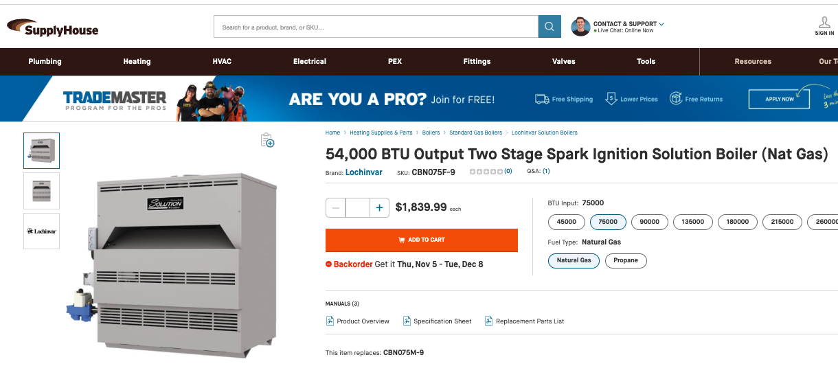

You can find small copper tube boilers for under $2,000. For a one zone system a copper tube works fine, properly piped.

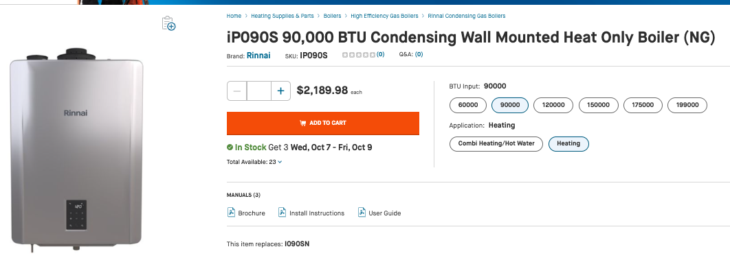

Shop around, you should find a small mod con boiler for around 2 grand.
Sell the Rinnai on FB marketplace for the price of a new boiler
