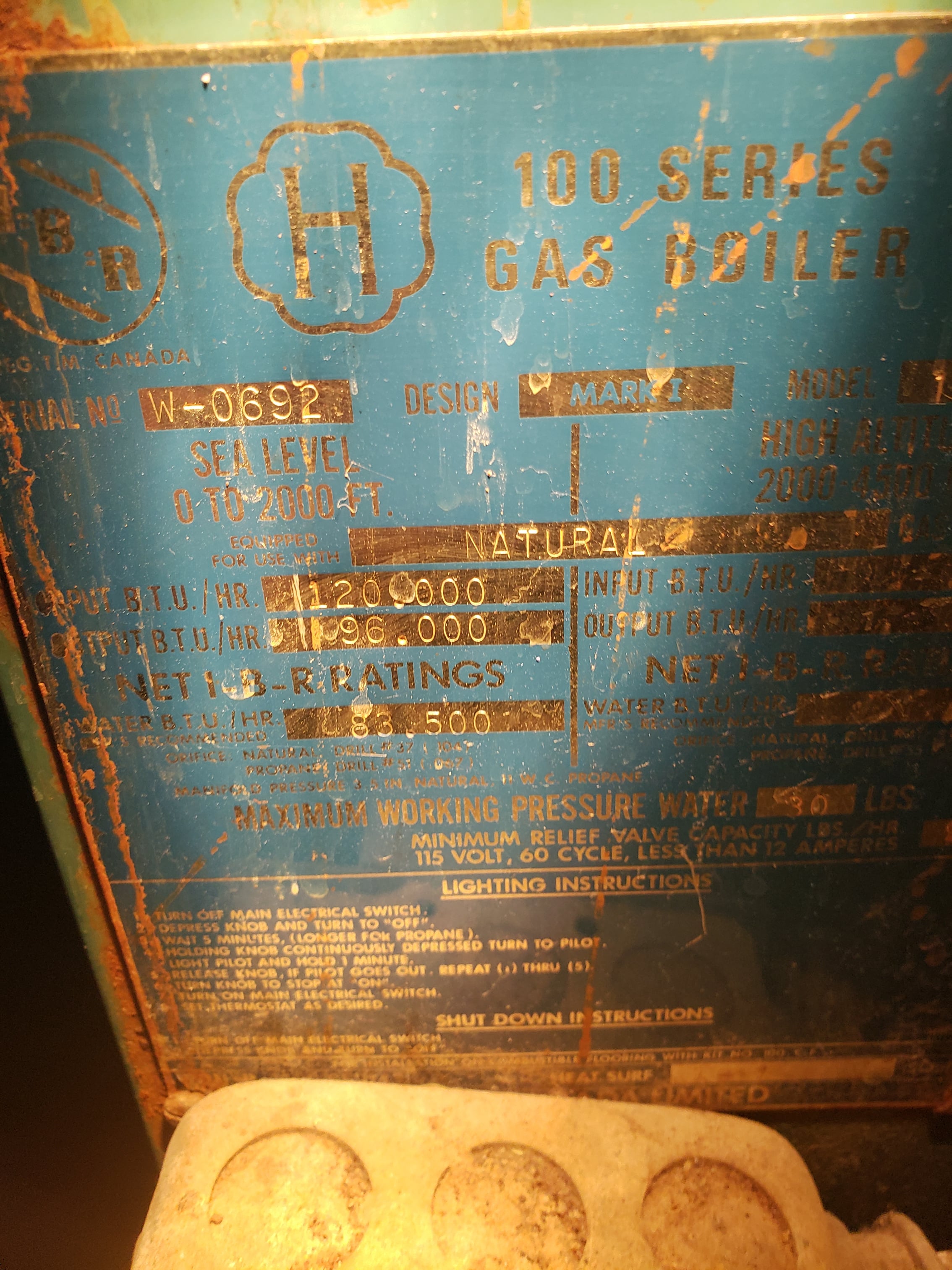

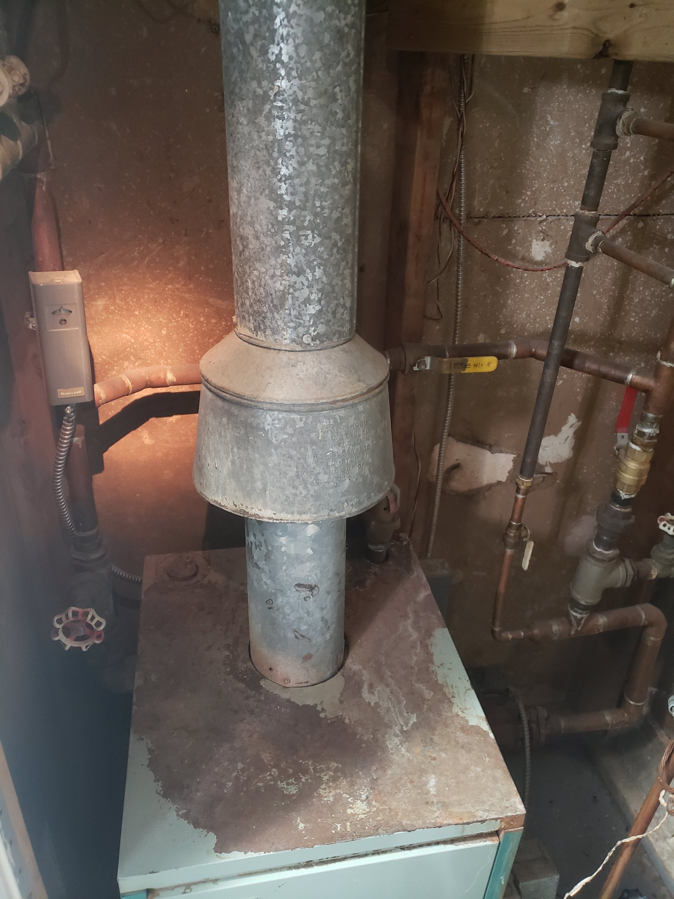

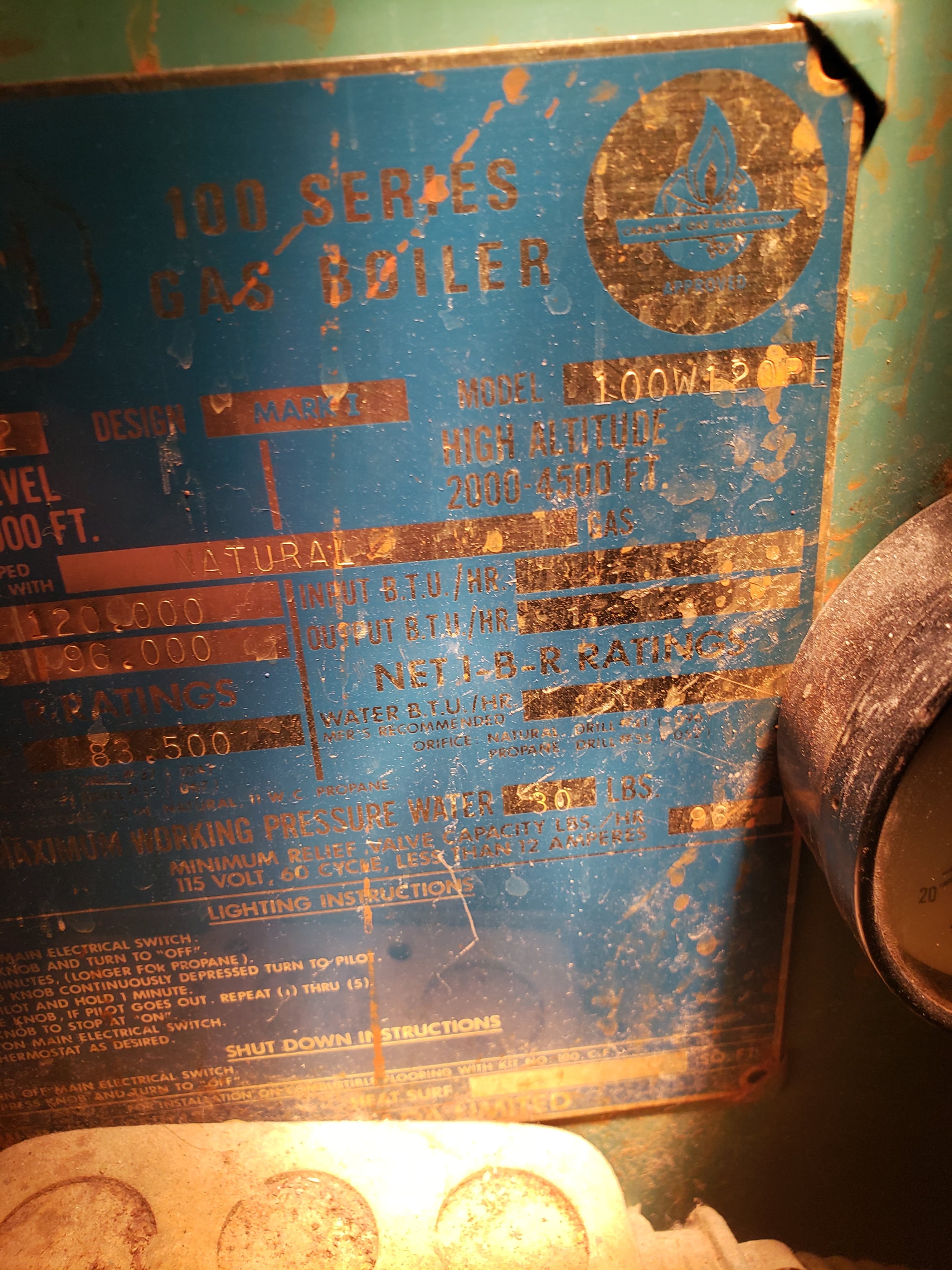

Hi I need to find the year manufacture of this boiler made by Crane boiler. Model 100W120PE Serial W-0692. Do all hot water boilers need a low water cut off and air scoop and flow switch. Tbis boiler is missing a low water cut off. It has ran close to 40 to 50 years.
Who do I contact for any tech support. I know it is old and might need to compare to another make of boiler for setup.

  • they were manufactured between 1959-1972
    Boiler should have a LWCO, most modern ones come with one factory installed but some areas required a second one to be installed on the piping.
    And Air Scoop or some form of air elimination should be installed as well
    EBEBRATT-Ed Posts: 21,328
    Back when that boiler was installed LWCO was not required. You choice if you want to add one or not. Those were good boilers I had the exact one in my house. Crane is out of business they were taken over by Burnham so most of the information is long gone.
    but those are simple boilers. There is really no information that you need. Flow switch not required. An air scoop or a microbubble vent is a good idea.
    Steamhead Posts: 19,007
    Actually, Crane sold their boiler operation to Slant/Fin (R.I.P.). American-Standard sold theirs to Burnham. That thing is built like a tank!

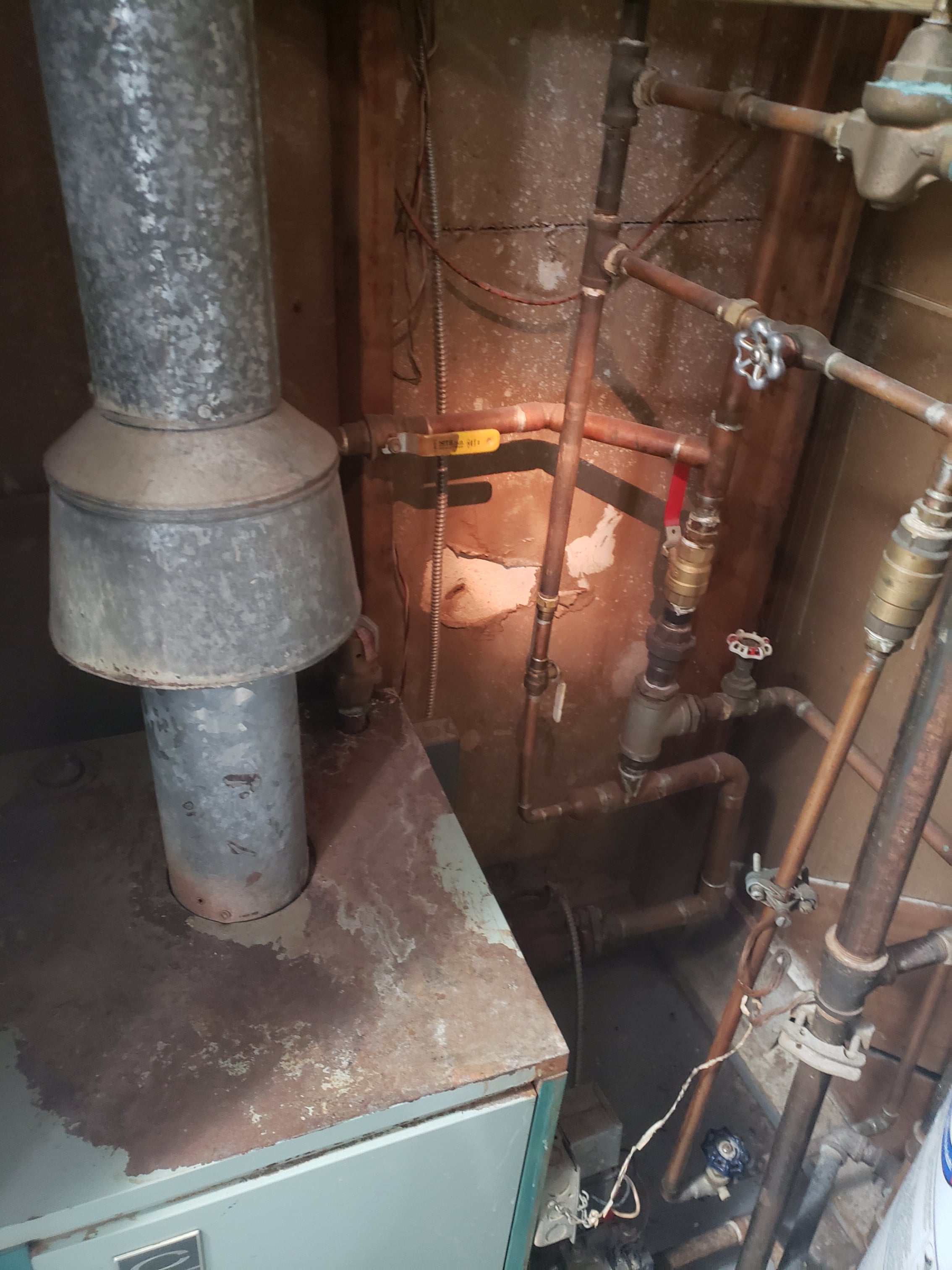

    Can the circulator be replaced without draining the whole boiler? I see valves upstream. Is there a valve at the inlet?
    I don't see a button on the aquastat so its not a manual reset High limit. Is it an auto reset high limit or is it the operating control?

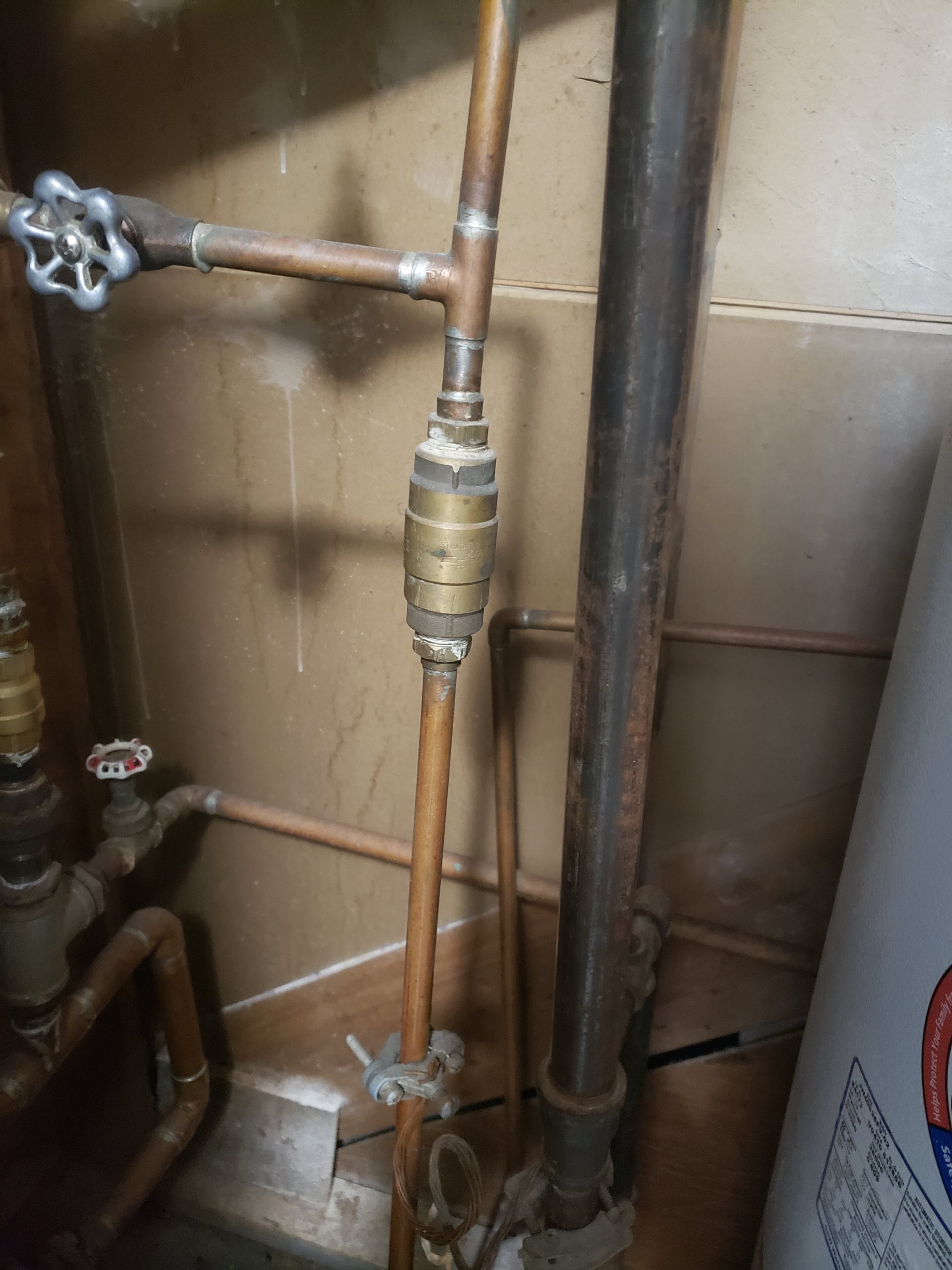

    I was there for service and inspection and I want find the year made and add necessary safeties missing. It has a dual check valve only instead of dual check valve with open port or back flow preventer. I need to know what safeties to add. There is no low water cut off and no air separator but there is an air float vent on the boiler. I need the serial number decoded and manual. The circulator pump works fine.
    The high limit is surface mounted and not sure if resetable and aquastat installed in boiler.
    Boiler needs to be drained to change circulator pump
    House built somewhere around 1980 to 1982. Located in Biggar Saskatchewan Canada

    There's no air separator because it would need one that could pipe into the steel compression tank in the rafters?

    The expansion tank is not in the rafters. It is connected on the return side above the circulator pump higher up at around 7 feet. I couldn't get a picture of it. I would add an air separator on the hot supply side and leave the expansion tank where it is. Yes it shouldn't be on the cold return side but there isn't a lot of room. Is there a problem leaving the expansion tank kn the return side. The original installers in the 1980s just never bothered to put an air separator. I guess they bleed the air at each radiator section. There is only 3 zones

    You can't use air separators much with glycol. If you leave the vents open they just spit foam most of the time and then corrode the vents.
    When the boiler was new it was legal with no LWCO and it only needs an auto reset hi limit aqua stat and a room thermostat.
    What you put on it now is up to you.
