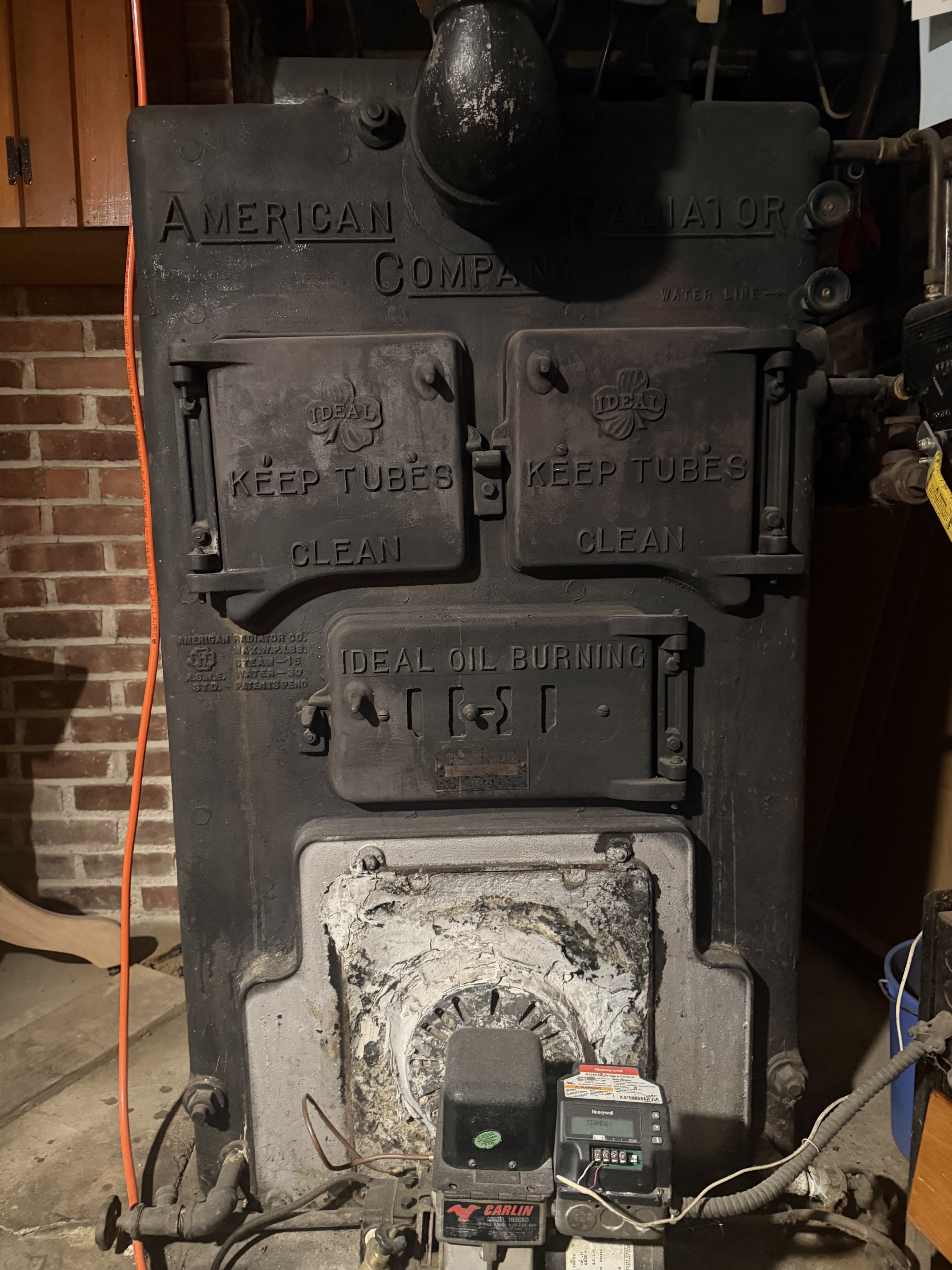

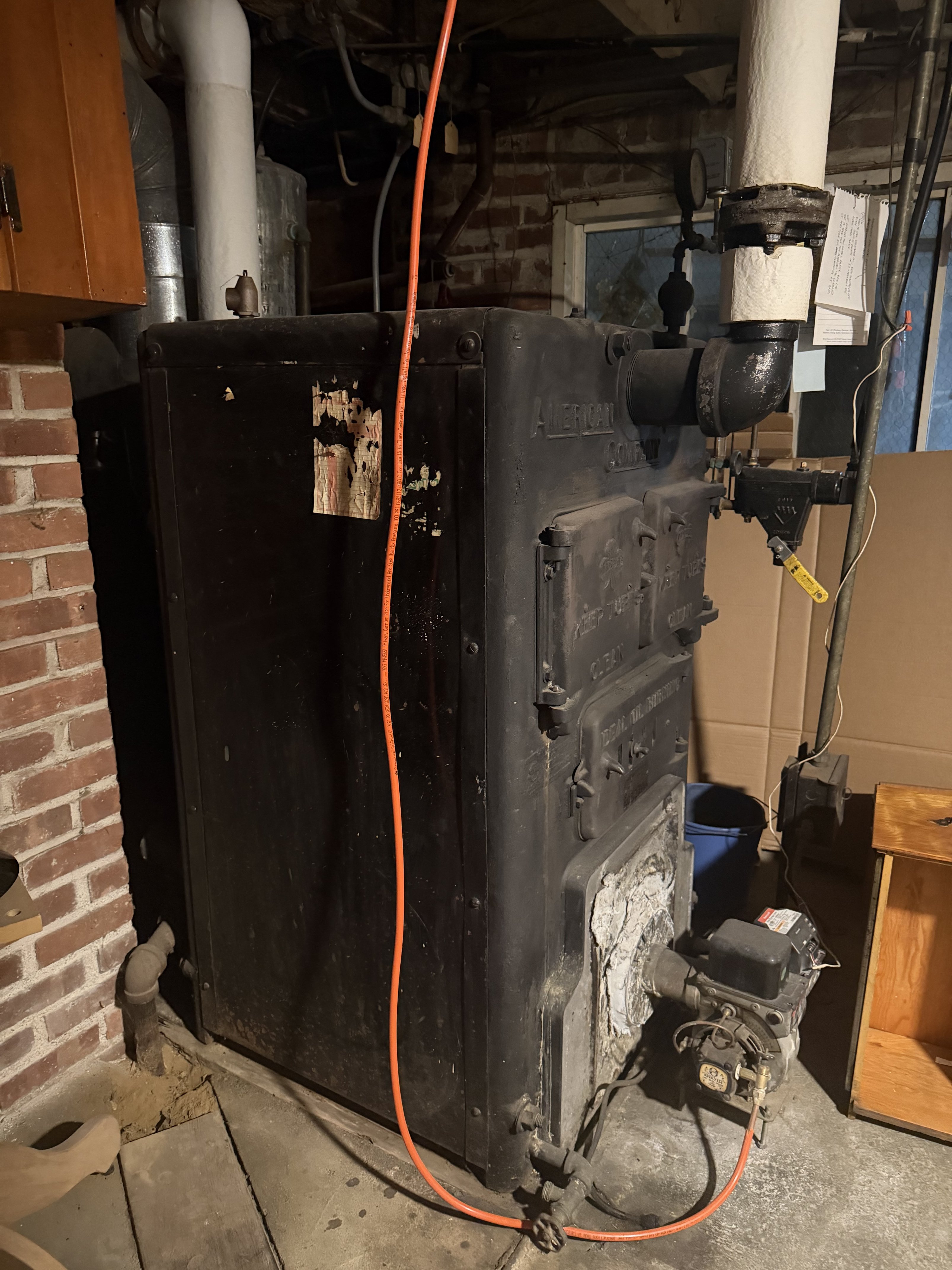

We bought a 200 year old colonial with this big boiler still intact. Works well but looking for any advice to keep this relic running well for as long as possible! Could get a new one but this thing is awesome
. Use’s about 750-800 gallons of oil a year to heat 2,000 sq ft.
Any feedback is greatly appreciated!

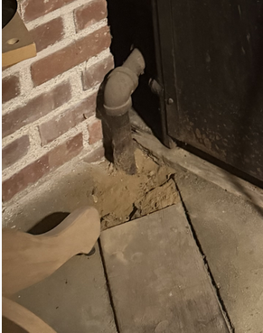

    I'm guessing this is a wet return, if there ever is any evidence about excessive water use, make sure the wet return is not leaking.
    Wet return looks like it may have been dug up and replaced already.
    I would buy one of Dan Holohans books available on this site to learn about steam. there is a lot you can do if your handy and own a few tools.
    I would have your oil company service it yearly.
    Then learn about the safety controls, low water cut off and pressure control should be serviced every year. Checking radiator air vents and go on a search for main air vents at the ends of the steam mains. You may or may not have any.
    You should install a blow off pipe on the safety valve that is on top of the boiler. I would also check the rating of that valve (IN BTUs) it could be undersized.

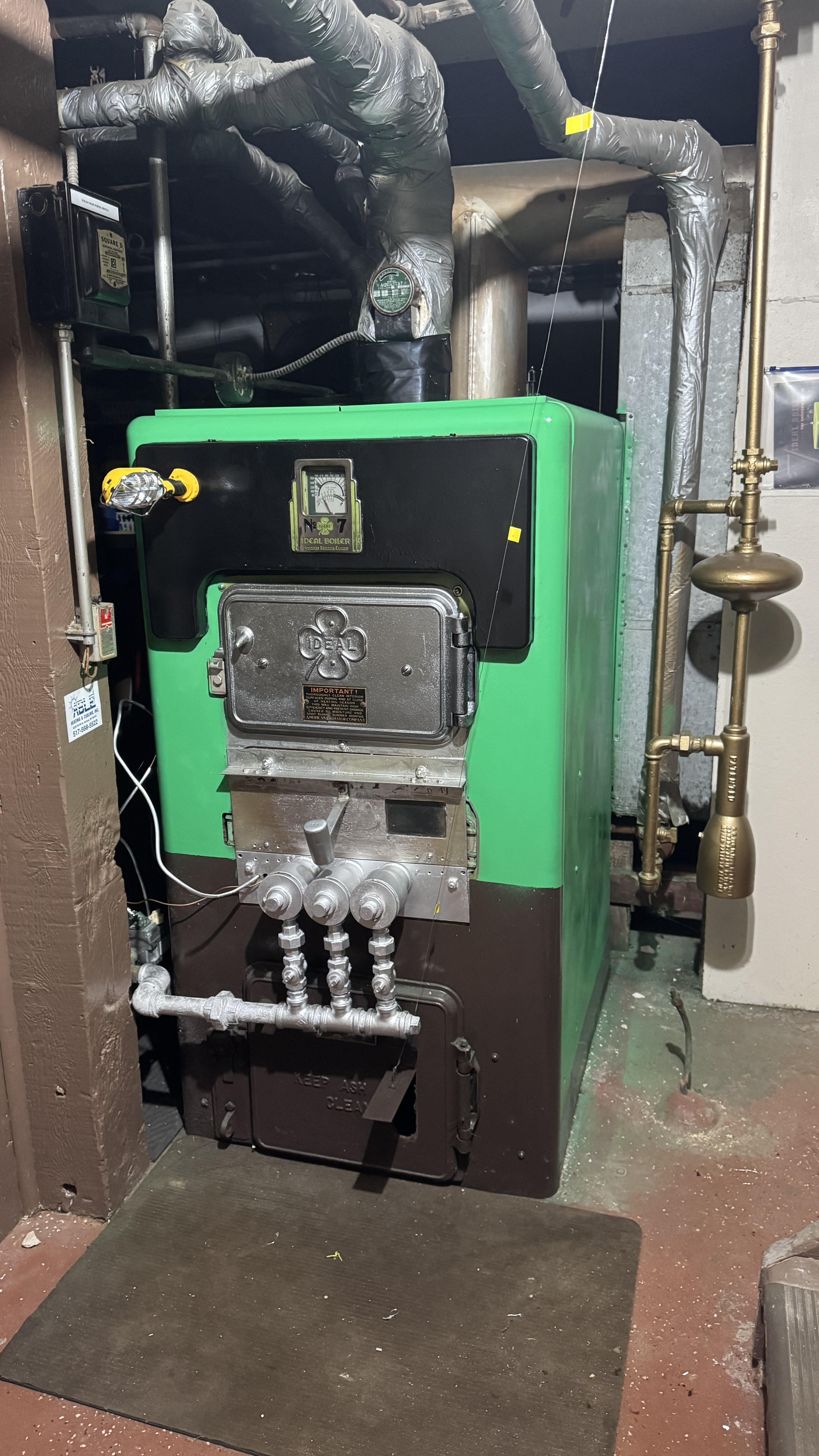

    If you think THAT'S awesome, you should see the MegaSteam.

    I think that's American Radiator's "Water Tube Boiler" which was one of their better units. It's built like a tank, as all the old ones were. Can you see the model number on the tag?
    The Carlin burner is a good one, probably a 100 or 102 CRD. Any reputable service organization should stock parts for it, this will mean they can fix it quickly if it malfunctions.
