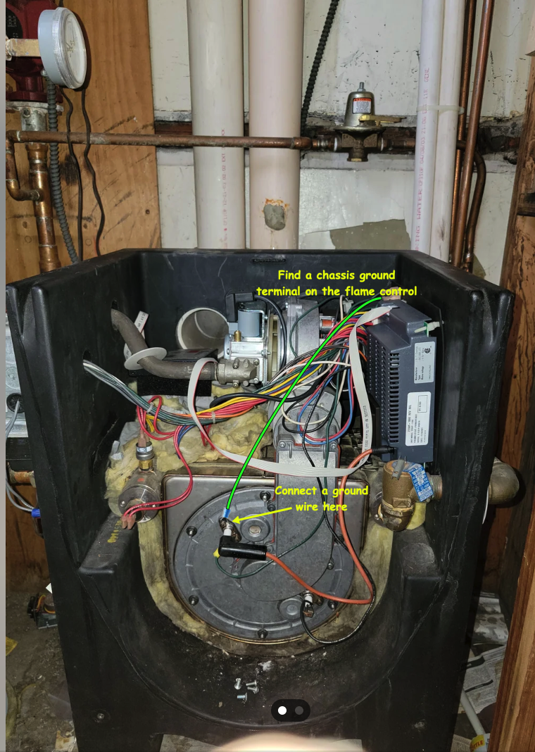

So what do the nuts and bolts and sheet metal screws look like that are connecting all the parts around the burner and the flame sensor? If they are a little rusty there may be a problem with the chassis ground that is the main conductor of electricity from the flame to the control module ground connection. That flame signal is not all that powerful and a little corrosion can certainly make that path a higher resistance than it was when it was brand spankin' new.
I have fixed this by fixing a copper wire (green ground wire) directly on one of the screws that hold the flame sensor rod in place, and running it to the ground connection on the ignition control.
If you look close at this boiler, someone has already done that on the other screw that holds the electrode/sensor.

The spark electrode and rectification probe screws look good. It doesn't hurt to run an additional ground. Had that kind of issue on my sons Burnham boiler. The pilot ground would corrode and wouldn't prove the pilot. Without doing anything it's working right now. For how long who knows. I will go in and clean up everything to sure. Thanks
