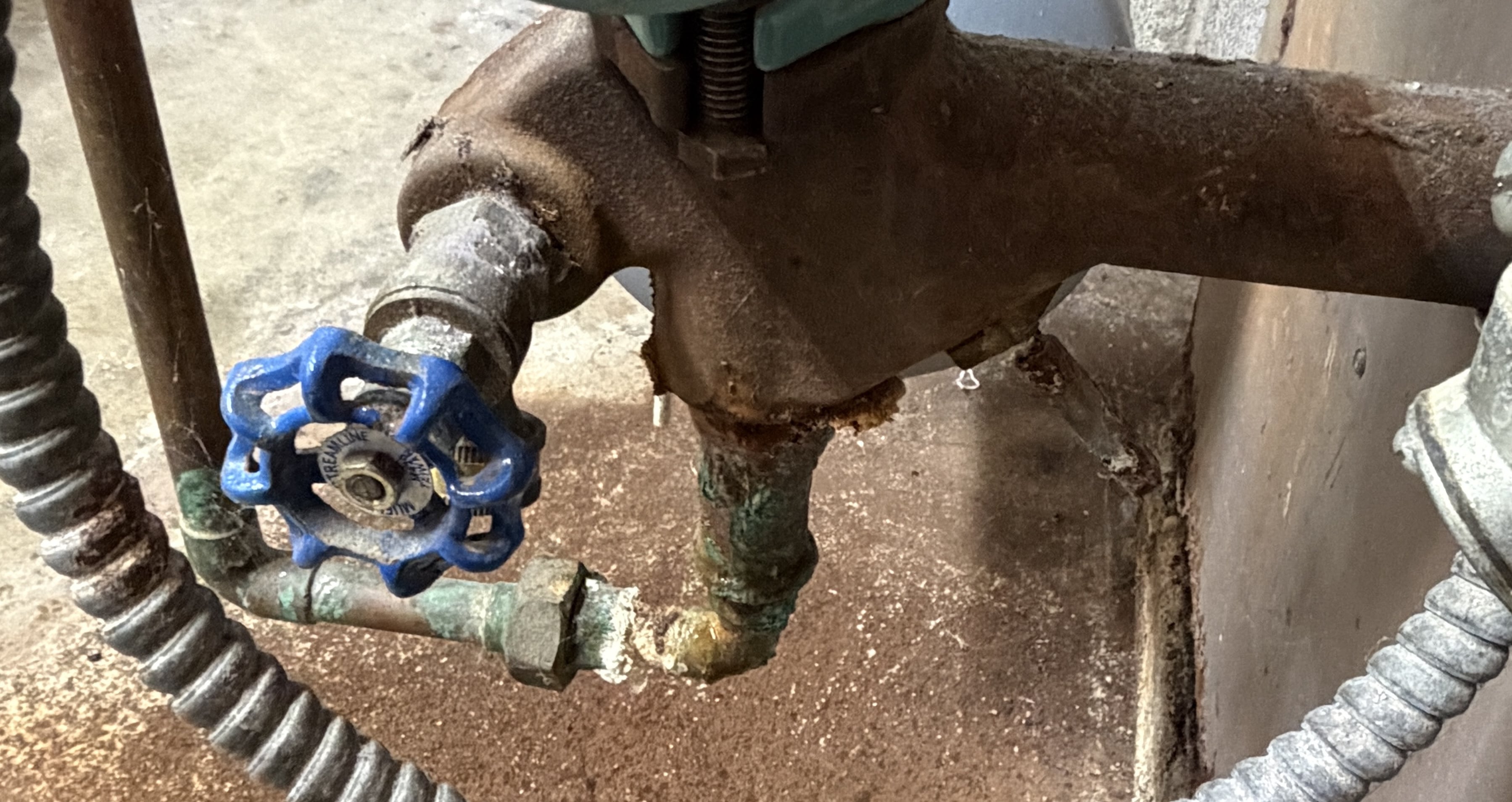

looking for this American standard boiler part.
It’s a cast iron (tee) with a pump flange attached.
Please help

Link not working. Is this the photo you were trying to display?
You may never find that fitting, but you can certainly make one with a couple of tee fittings and a pipe nipple.
What is in the boiler—a female tapping or a welded pipe nipple?
From what I can see here, you need to raise the circulator pump an inch or so to accommodate a 1-1/4" tee and a close nipple to a circulator flange.
On the third opening of the tee, you can add the 1/2" copper pipe and the drain valve using a bushing and a 1/2" tee fitting.
if that is just a nipple and some fittings threaded in the bottom i might try cutting out and replacing that first and see if resealing that fixes the problem.
