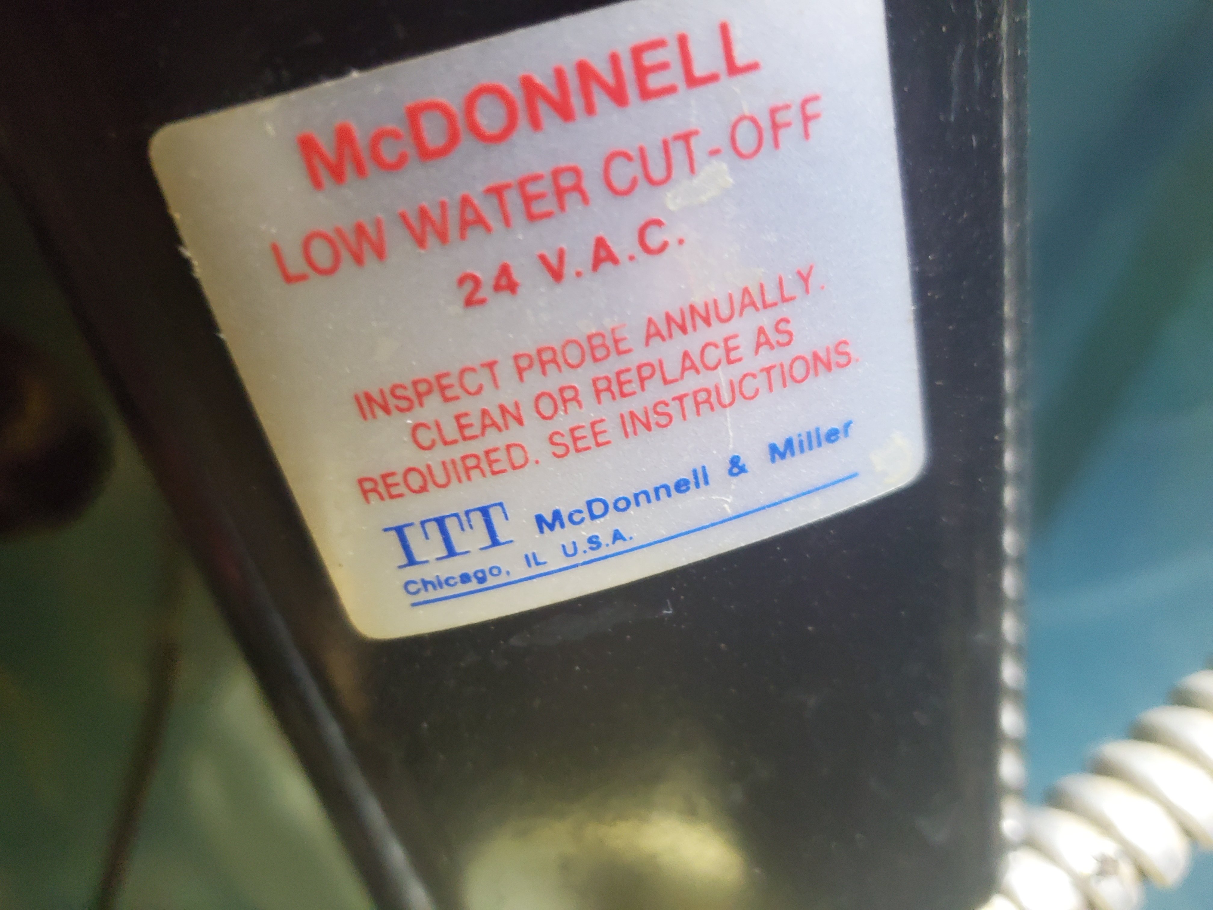

Last year I became a proud owner of Burnham PIN5SNC-ME2 manufactured in 2003. I cleaned the combustion chamber and burners, preemptively replaced thermocouple and removed and checked the pigtail for obstructions. Everything is good here.
It has McDonnell and Miller LWCO with no model number that I can see on the housing that also controls the automatic water feeder.

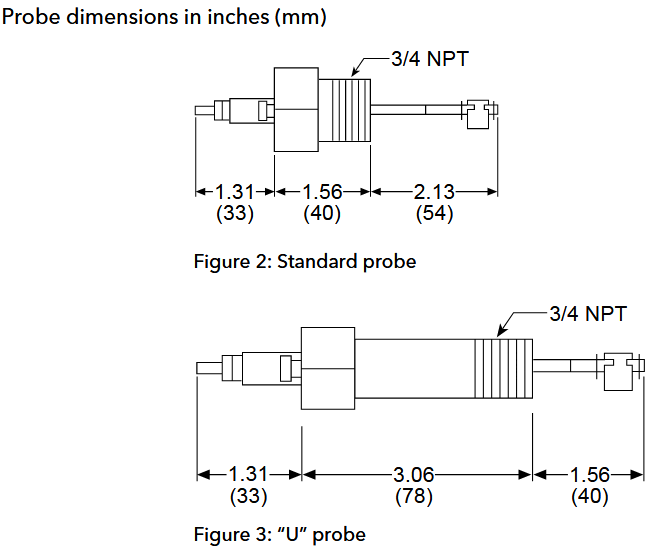

Several times during the winter months the LWCO was malfunctioning i.e. red and green light were flashing and the relay was clicking while the water level was well above the probe. Power cycling the boiler was bringing it back to normal operation. I want to replace the probe and see if that takes care of this problem. Judging by the condition of the burners, I suspect it's never been replaced.
What's the correct probe for this application?
Also, several times I noticed the LWCO making repeating ticking sounds, kind of like a mechanical clock, with no other symptoms. Usually a light tap or two on the housing made the sound stop. Is it something to be concerned about? Maybe it makes sense to replace the entire LWCO together with the probe? If yes, what's the proper replacement?
    109A_5 Posts: 4,620
    "Usually a light tap or two on the housing made the sound stop."
    Maybe a loose connection inside.

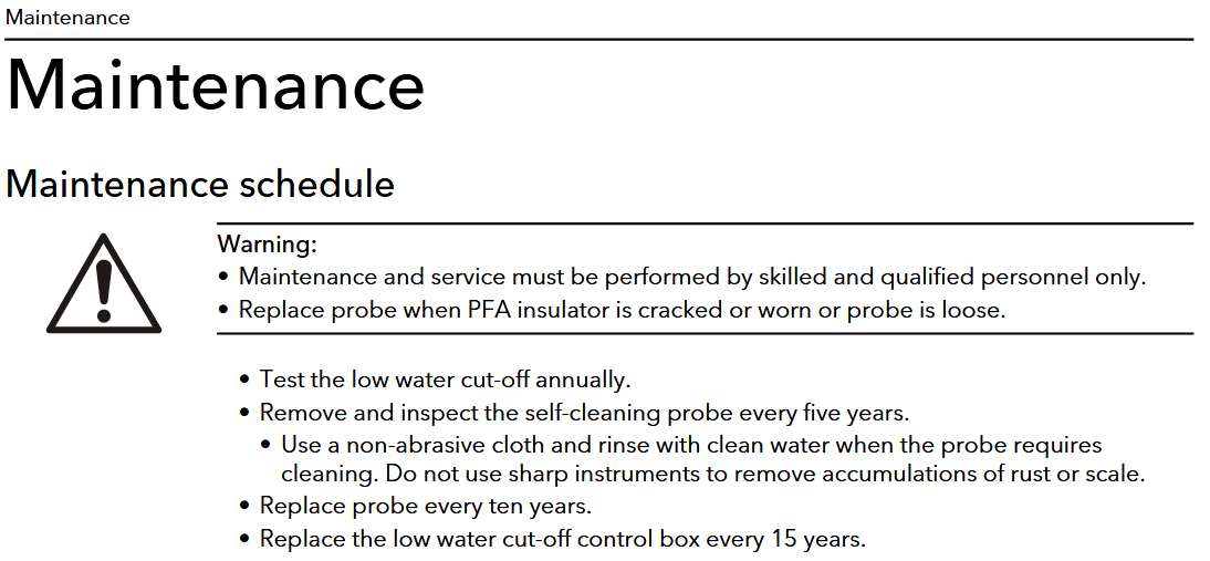

    Very unlikely that the probe is the cause of the problem. I would suggest replacing the whole water cutoff. It's a pretty important component!!!!

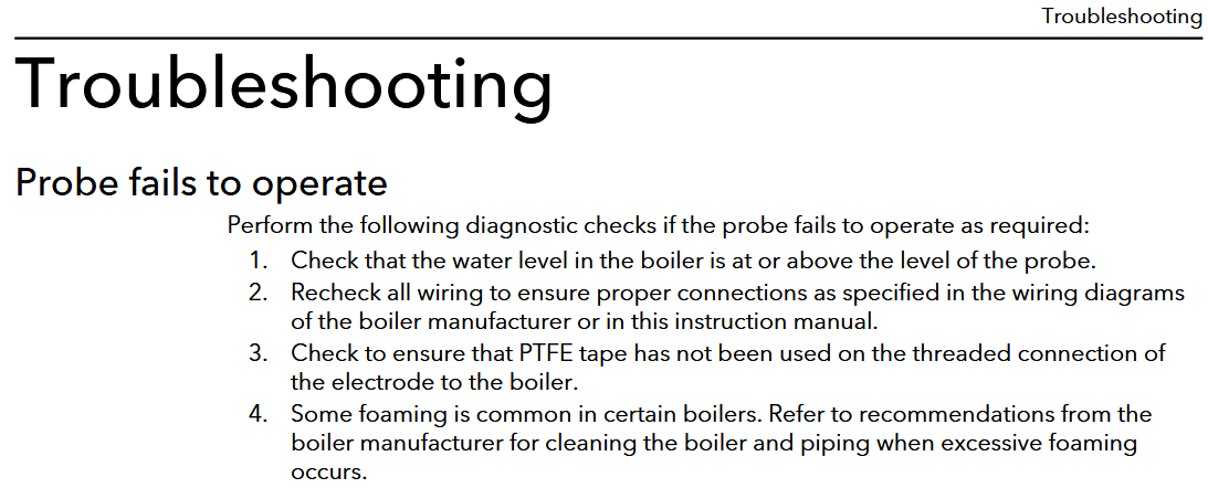

    i would be worth it to pull the probe and make sure it and its connection to the inside of the boiler is clean. it isn't by any chance doing what it is supposed to because the water in the boiler is surging or something like that?

    Boiler water surging, is unlikely to cause the low water to cut off to click. And certainly would not be resolved by pushing the body of the low water cut off. All signs point to an electrical issue

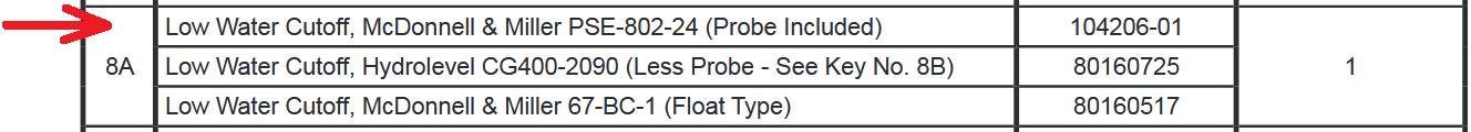

  • Thank you gentlemen. I guess I'll be replacing the entire LWCO.
    Is PSE-802-24 what I need?
    Is it plug and play?
  • STEAM DOCTOR
    STEAM DOCTOR Posts: 2,671
    No longer manufactured. Might as well get a hydrolevel safegard.

    Did you at least take the cover and inspect the wiring ?
    You stated "Usually a light tap or two on the housing made the sound stop."
