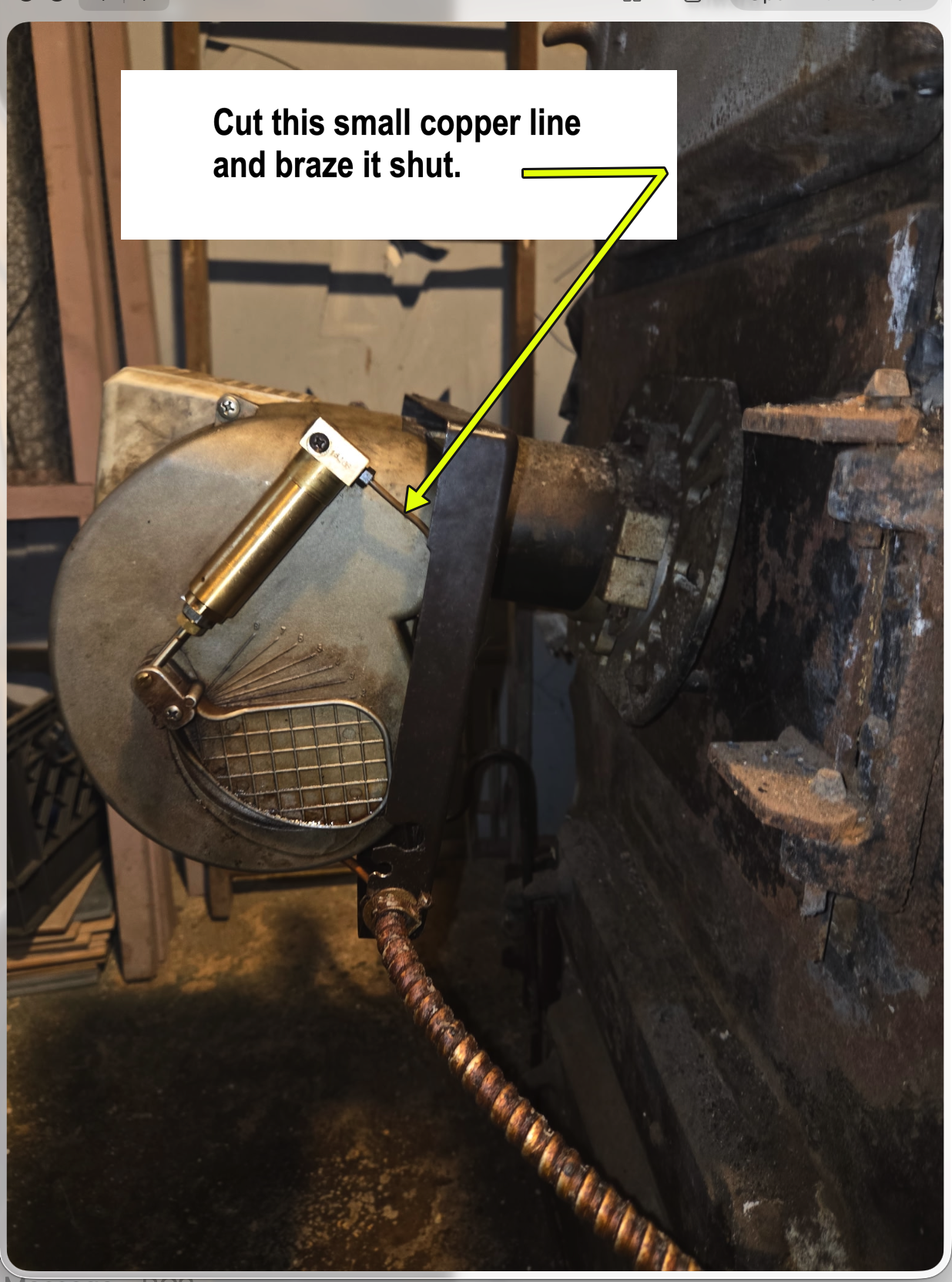

My son is looking for an old Riello chassis.The 40-F3 electric motor air gate is preferred. There is a burner-through-the-door job that has a leaking oil piston. This is the third oil piston over the last 25 years.
This assumes that the old Mectron M3 fire tube bolts up to the new 40-F3 burner.
Since the through-the-door fire tube is secured to the door with a block of castable refractory cement, it would be easier to use the same blast tube. We considered a pre-owned Beckett, but that would mean making another fire door with another castable refractory door brick.

    I have had a lot of those pistons leak over the years. Instead of hassling with them I just get rid of the piston and braze the tiny oil line shut.

    Better to reinstall a new pump plug.

  • I never thought of that. great Idea. I just sent this photo to my son.

    That is the old style piston , 35 years old ?
  • I think if you’re not replacing the piston, the metric plug is way better than the electric air gate, which also gets bypassed instead of replacing.
  • Mectron and F series air tubes are different, not interchangeable
  • I was afraid of that. So I think we will just plug off the oil piston port from the pump and set the air gate accordingly.

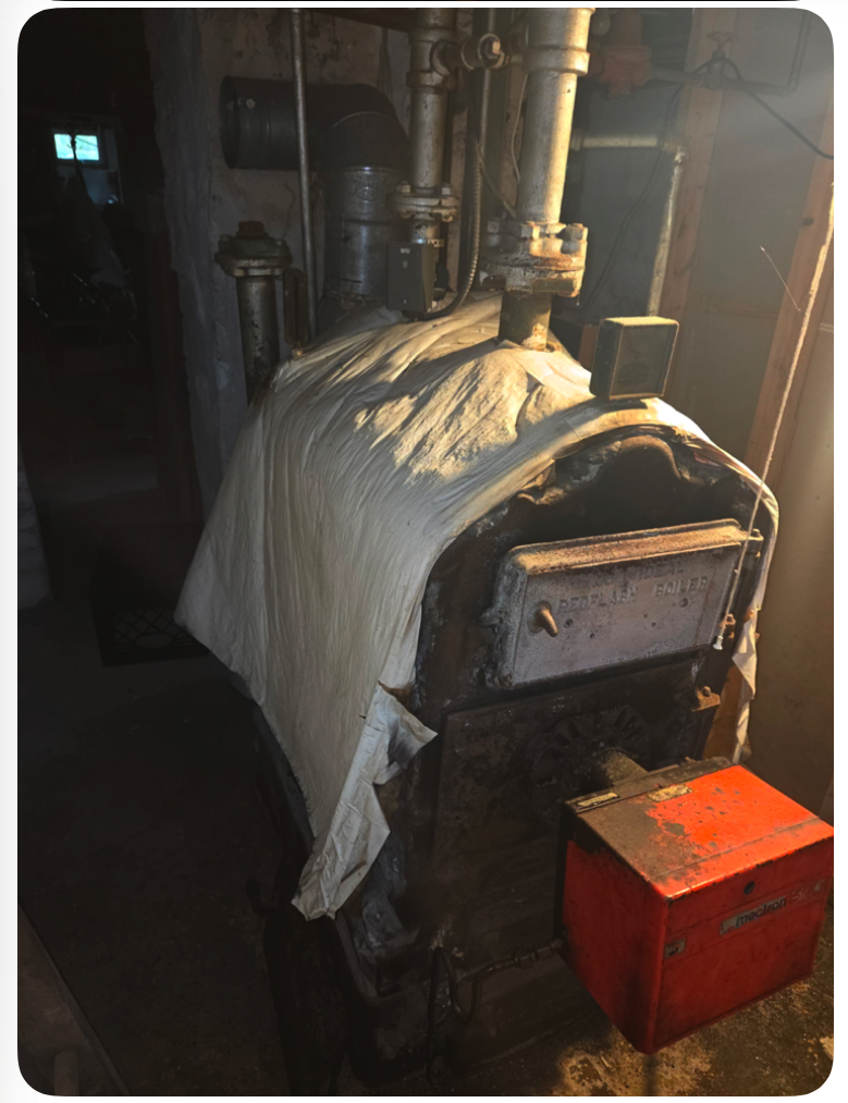

    This person has limited funds and owns the home outright. She will probably live the rest of her life there with a boiler that she is used to. No circulator pump or relay to worry about — just a system that keeps on going like the Energizer Bunny.
    The company I sold my business to told her that she needed to get a roughly $20,000 new system because the old one was dangerous. My son went there, did the tune-up, and it is working perfectly. The only problem is the small drip from the piston.
    Thirty-five years ago, this boiler was wasting oil big time. Someone had removed all the insulation from the boiler sections, and the old burner was tucked down in the ash pit.
    After adding this water-heater insulation blanket and moving the fire up to the original design location, where the coal grates used to be, the fuel usage was cut in half. It has been working as a Riello should — trouble-free — for more than 30 years now. That water heater blanket has no soot residue after 35 years.
    Two oil pistons are the only parts I remember replacing over that time.
