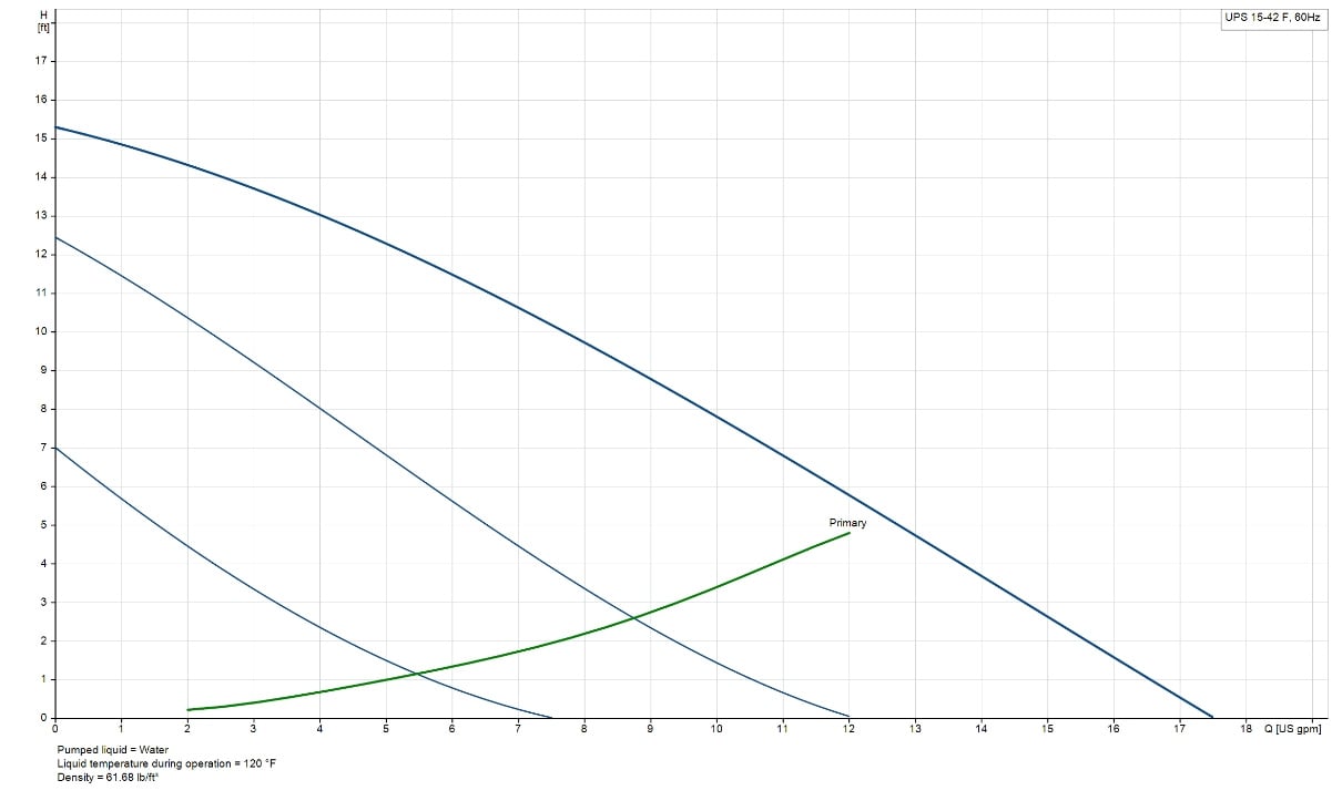

I used the Grundfos tool to plot my primary loop circ ( a 15-42 3-speed) vs the head loss in the loop.
The IBC boiler has a flow/head table, as does the Dirtmag. For the 1" pipe I used an online calculator for 8ft of equivalent pipe (buffer tank will be beside boiler and the main notable is the 3/4" port restrictions going in and out).
It looks like on Med speed, the primary loop would be flowing ~ 8.7 gpm , on Low it would be around 5.5gpm. The boiler's stated min flow rate is 2 gpm.
The secondary loops would be flowing anywhere between ~ 0.5 and 7 gpm I suspect.
It seems to me that, for normal day to day secondary flow, the circ will flush thru the buffer tank even on low speed.
I would like to reuse this 15-42 (recycling it from my existing oil system) but maybe it's just too fast ?
Can I help the situation by increasing the buffer tank delta, or turning down the Ramp on the boiler ? Introduce more head on the primary loop ? (a valve partially closed ?)

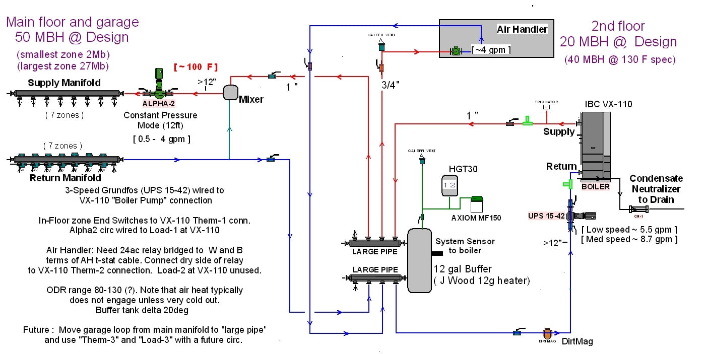

New system diag for ref
  • Now with coffee instead of evening refreshments I wonder, am I overthinking it ?
    Is there even an "ideal" gpm for the primary loop when the secondary loop is variable flow ?

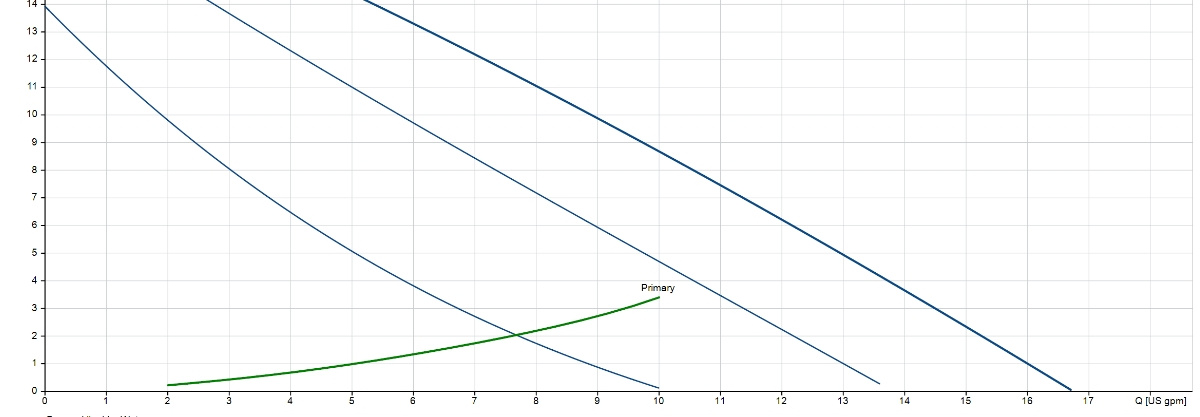

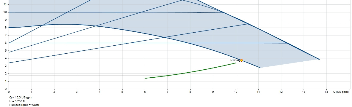

  • Im thinking of going new circ for the install but having a hard time finding a fit.
    I seem to need approx 7gpm (in the 6 to 8 range would be nice) but the head is only 1.4 - 2.2 ft.
    The Grundfos UPSe 15-58 that the rep suggested would send me to ~ 10.2 gpm unless I could come up with a bit more head. 10.2 gpm is getting pretty close to 4 ft/sec in the 1" pipe.
    Is there just no demand for a slow circ like speed-1 or 2 on the 15-42 ?
    I looked around on the Taco site but didnt find anything yet.

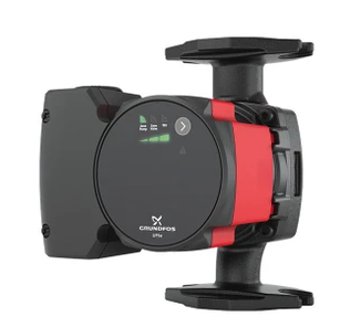

    Curves for a UPSe 15-58

    You might need more coffee. The piping to me looks almost completely wrong, in almost every way.
    The way the boiler is connected to the buffer.
    The 2 manifolds off the buffer.
    The placement of the piping and mixing valve going to the radiant zones.

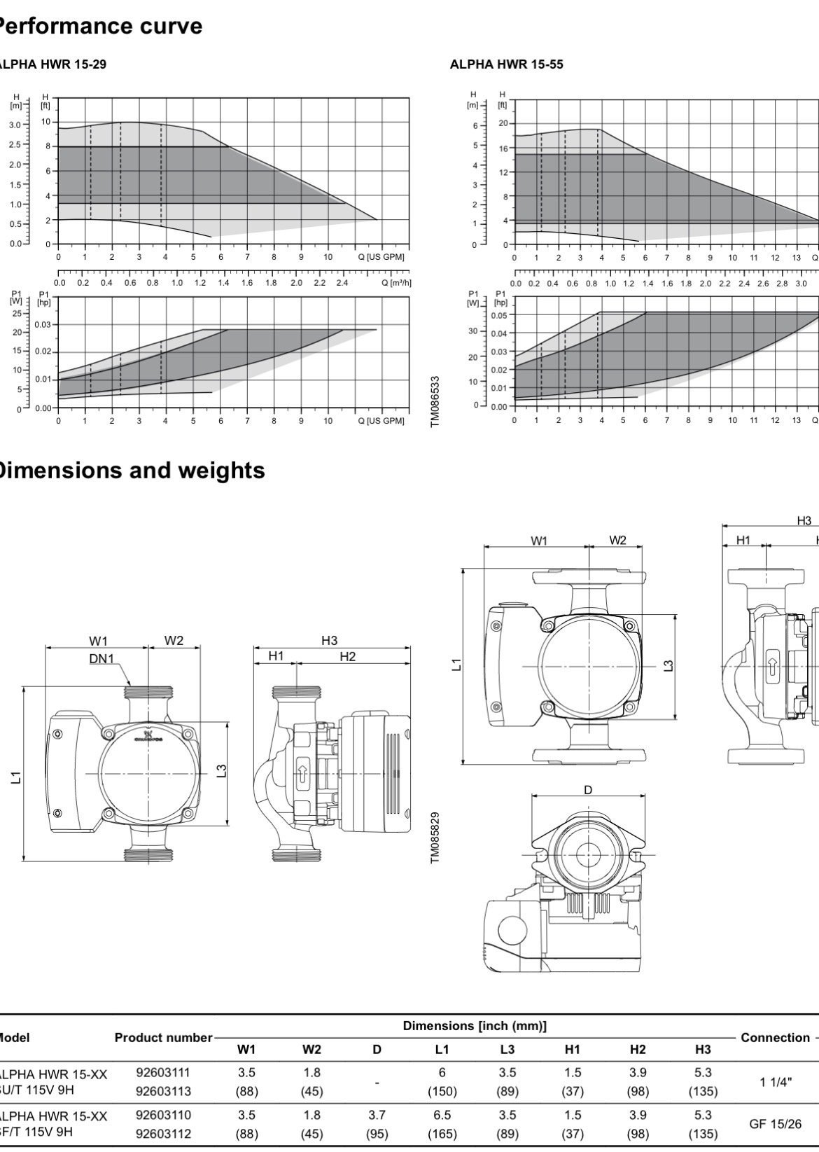

    If you shop around you can still find the Alpha 15-55 and 15-29
    In the Grundfos model the last two digits are the head in decimeters
    So the 55 and 29 are a bit smaller circs than a 58
    I think the Grundfos offering will be all Alphas going forward

    If they had the -29 with the regular Alpha display on it instead of the HWR, that would be sweet. In any case, I dont recall seeing the HWRs on my vendors site.

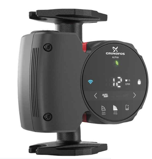

    It only just occurred to me to check the curves for my existing Alpha2 ( a 15-55) that I was going to reuse for the in-floor. If I instead use it for the primary, on speed-1 curve it should flow 6.6 gpm ! (21f rise to meet my peak btu needs). ( 70000 = 500 x 6.6 x 21 )
    I'll get a new Alpha 15-58 to use on the in-floor (constant pressure mode). Its a +$75 to add the "Alpha" display/control but you get logs and data via bluetooth/app that I might find interesting ?
    hot_rod Posts: 28,699
    The 15-58 has two versions, a basic model and one with more features. I think one is the UPS 15-58E and one the Alpha 15-58. Maybe?
    Screenshot 2026-10-03 at 8.53.02 AM.png Screenshot 2026-10-03 at 8.53.33 AM.png

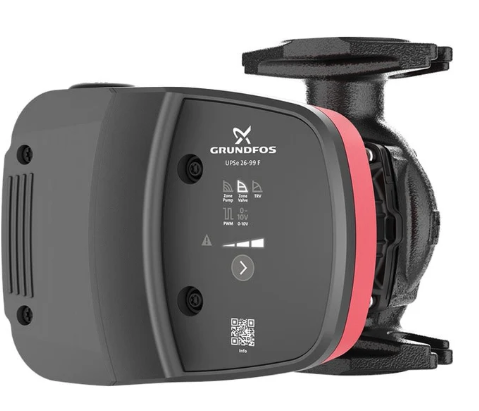

    The Alpha 26-99 is just hitting the shelves
