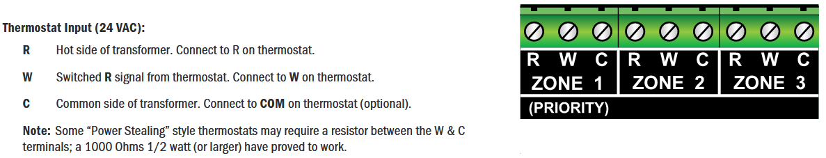

    Some two wire t-stats need the resistor connected to the W-C terminals. Easy way to confirm if you take away the R-W from the Taco ZVC t-stat terminals and "jump" the R-W with a jumper. If it sends the signal to the zone valve, then that confirms you need the resistors.

  • Hmmmm. Won’t a jump between R-W always signal the zone valve to open regardless of whether the thermostat needs a resistor or “C” wire?
  • @chippy2 Every tekmar stat I’ve seen needs power.
    If your ZVC has a metal cover, Taco doesn’t give you a marked “C” terminal. You have to steal it from the unmarked transformer terminals on the board and have to figure out which one is the “C” wire.
    The newer ZVC’s with a plastic cover give you a “C” terminal for every thermostat, right next to R-W.
    chippy2JohnNY

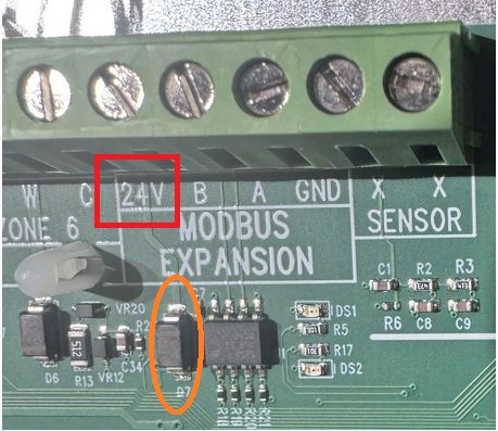

    Thanks. Unless I’m wrong the C terminal is common and the Tekmar still requires 24v. There is a 24v tap on the Modbus connector that I can use.

    Alan, on the metal cover ZVC controls. See below.
    -2 ZVCs Wiring
    White= Left “T”
    Red = Right “T”
    Common = # 1 Terminal for each zone valve terminal
    @chippy2 if your current t-stats do have a common, then just wire to the C terminal at the t-stat terminal on the ZVC control. Always between R-C is 24v.

    109A_5 Posts: 4,759
    It would not surprise me if this 24 Volts was 24 Volts DC, not AC.

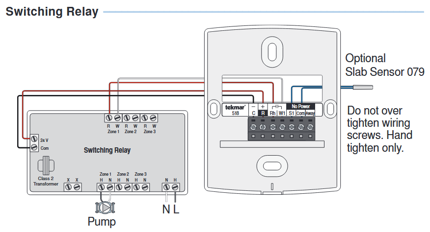

    And / Or
    Looks like the Tekmar 518 is compatible with DC power.
