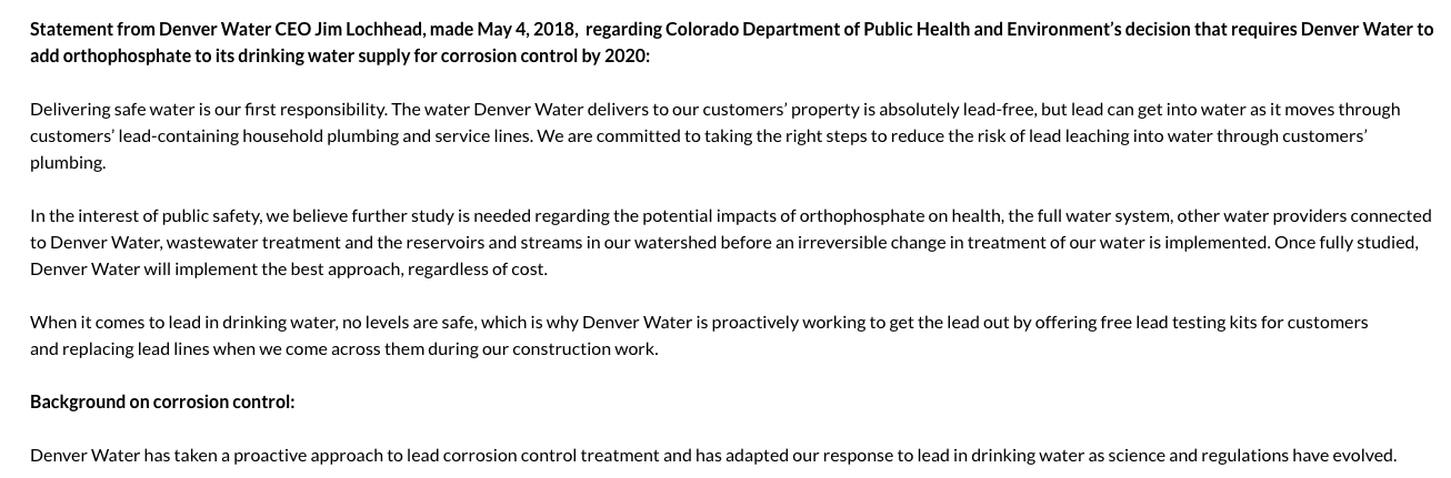

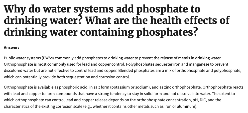

    my city and many other cities add corrosion inhibitors that are designed to coat the pipes to keep the lead and copper from leeching from them. this might be worse than your well water. a deionizing cartridge on your well water might be just as effective and much cheaper than transporting water. i'm pretty sure the anti corrosion additives were what welded the check ball to the seat in my prv assembly.
  • PC7060
    PC7060 Posts: 1,980
    Interesting, just looked up the typical inhibitors that are added including phosphates and sodium based. compounds.
    Do you know what your municipality uses?
    hot_rod Posts: 28,699
    I think Denver had some issues with over-treatment with phosphates sludging up some systems.

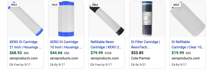

    You can buy single use DI cartridges. What size is your house filter? How many gallons you get depends on the condition of your water.
    I'd guess a 10" cartridge would get you 80 gallons or more

    don't use softened water unless you deionize it. the chloride content is too high. those deionization cartridges with the hose thread are great for producing final fill water. the well water is fine for flushing and running the cleaner. could fill it from the water heater and at least werm it up some then use the corcutors to circulate the cleaner.
