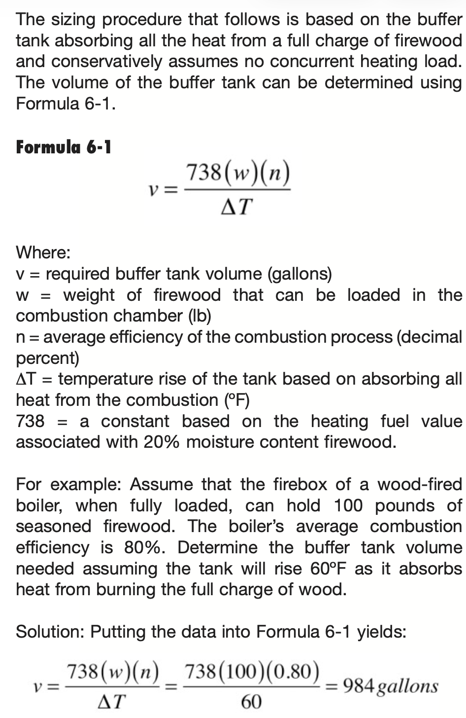

    Here is a formula for sizing a buffer.
    Basically this shows what size tank to take the boilers output if there are suddenly no heat calls. You want to save the firebox worth of heat, not pop a relief valve and blow it out.

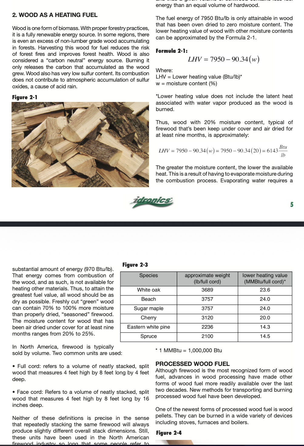

    The worse operating condition is to jam the firebox full of wood and expect the boiler to behave. So use this formula with a realistic load of wood you might fire up on the average day. Maybe 30- 40 lbs? Depends on the wood species.
    You really, really want dry firewood to avoid creosote problems.
