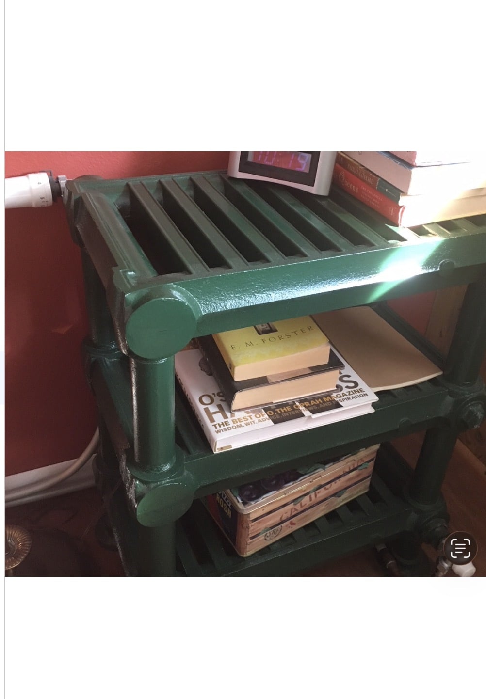

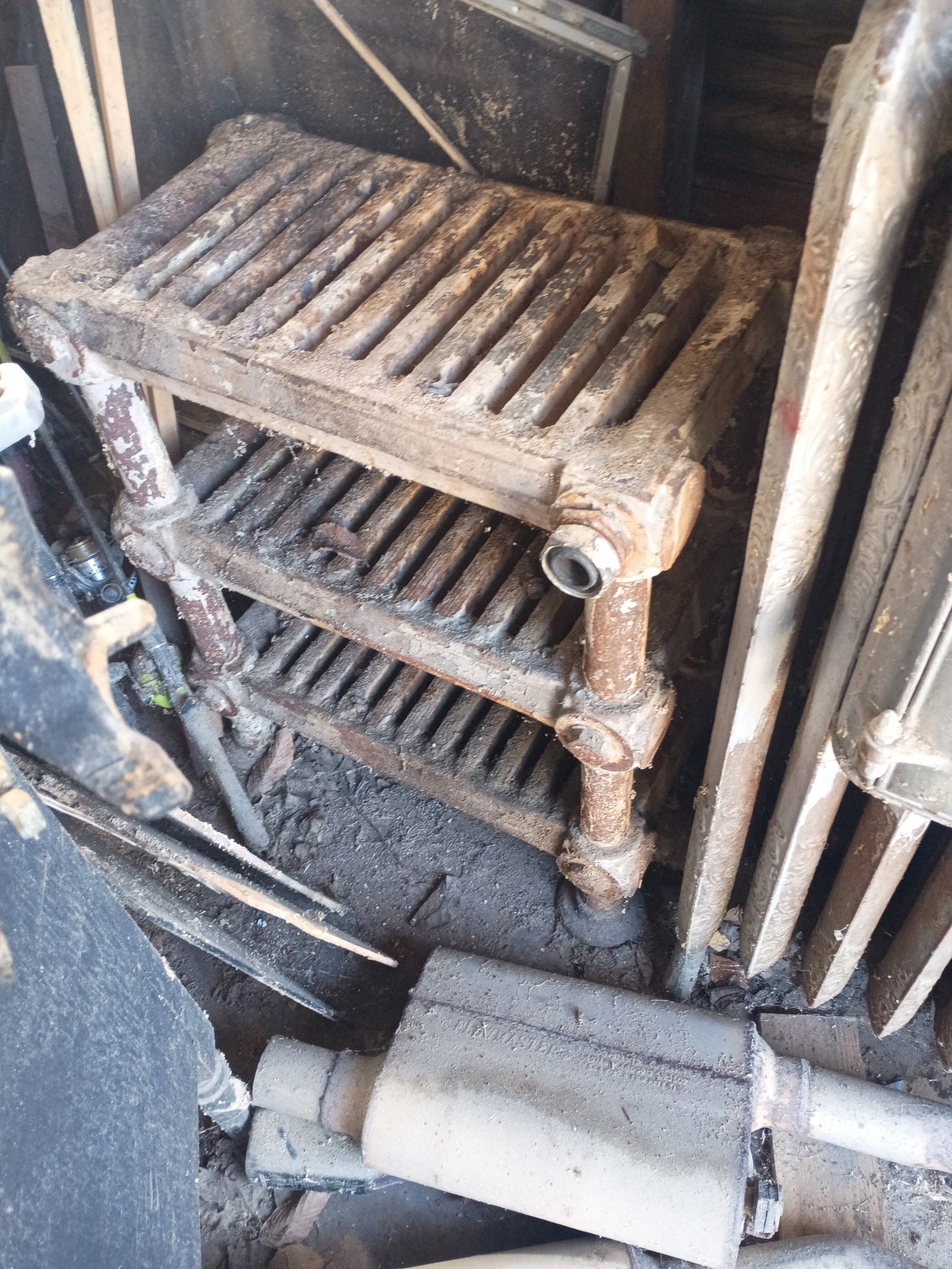

The boiler is an NTI Trinity 150, and the initial setup will be very small: 2-3 radiators, all of the classic cast-iron type. One of them is very rare (I am told), a "pantry" or "butler's" radiator with horizontal orientation of the fins. Image attached. I am struggling to use the various guides out there to figure out how many BTUs the thing will emit. 13" tubes, 23" wide, and stands 28" tall.

    I think that is called a pantry radiator.
    I installed one next to my bed. 1/2” Pex. A TRV for temperature control
    The Btu output will depend on the flow you move through it and the temperature.
    With 1/2” Pex 1- 1-1/2 gpm, so around 10- 15,000 btu/hr with 180 supply water.
    What sort of output are you looking for? What temperature supply?
    With 3/4 Pex you might get close to 40,000 btu/hr

    mattmia2 Posts: 18,262

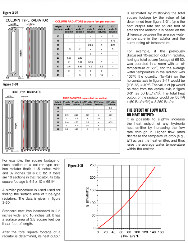

    the cliff notes version of how you figure the output is you find the edr either from an old catalog page or for standardized radiators from a radiator chart then you can calculate the output from the edr and the average water temp. maybe @hot_rod has the catalog page. there is the book on this site called edr: every darn radiator that has many of the old catalog pages. probably using any wall hung radiator of that style the size of those sections would get you close enough.

    Steamhead Posts: 18,981
    According to the 1925 "Ideal Fitter", it's 23 square feet.
    Semi-retired
    hot_rod Posts: 28,562
    Here is a derate formula for column type radiators. I thik you will get close with this, now that you have sq foot number.
    If you supply 180° to the radiator, room temperature of 65 at radiator, (170-65) 105 on vertical= 160 btu/ sq. ft./hr. 160x 23= =3,680 btu/hr.
    Quite a bit smaller than my above guesstimate. A small computer muffin fan mounted below would increase output, turning it into a forced convector.
