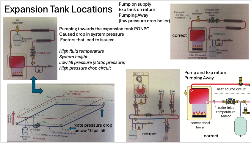

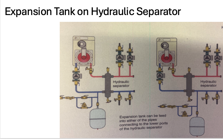

expansion tank connection, incorrect and correct options
hot_rod
Posts: 28,704
Pumping into the return of a boiler IF the expansion tank is upstream, suction side, of circulator
