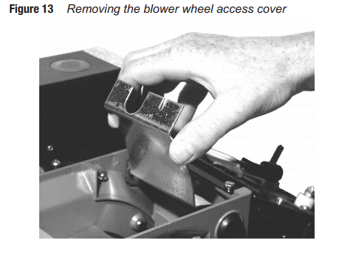

Does anyone know how to get a replacement for the baffle that needs to be removed to pull the nozzle assembly. The Carlin residential oil training guide and EZ manual refer to it as a "blower Access Cover" I've also seen it referred to as the "blower Shield"
I don't see the part listed at any of the usual suppliers and the carling burner manual does not call it out. It just shows it attached to the burner housing.
I recently had to use the one I had on an old housing and want to replace it, for when some knucklehead leaves it out and the homeowner throws it away 😪

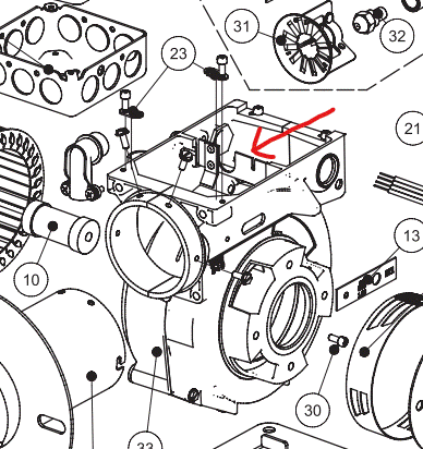

Doesn't show up on the EZ-Gas parts list either, though it is shown on the diagram. Guess you'll have to call Carlin. Lat us know what they say.
Item 33 is the housing and it lists part number 84939 for the access cover.

Interesting! Here is the EZ-Gas one, wonder if the part# is the same?
1 -
My download of the manual I posted was from July 2019, so I guess they revamped part numbers.
