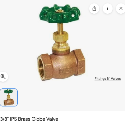

When I plumbed my steam boiler’s automatic filler, I used ⅜” NPT pipe for the whole loop, including the bypass valve that’s used to manually fill the boiler. At the time I used a ⅜” FIP gate valve, but it started leaking, as gate valves do, which is very bad because it would flood the boiler unless I shut off the supply valve, but if I shut off the supply, the autofill won’t work. So I need to replace the bypass valve with either a new gate valve or, preferably a globe valve, but I can’t find either one anywhere*. The only ⅜” FIP valves I can find are ball valves, which will work, but it’s not the right valve because it’s a throttling application, not a shutoff. But my bigger concern is: whiskey tango foxtrot happened to ⅜” FIP valves? Has the whole industry just arbitrarily decided they’re obsolete? Are ⅜” ball valves going to suffer the same fate in a few years? What about ⅜” NPT pipe and fittings?

    hot_rod Posts: 28,704
    Google 3/8 globe valve, plenty available from10- over $100.
    A globe is better for throttling.

    I should have been clearer. This valve stays closed most of the time. The throttling only happens while you’re filling the boiler. Sometimes you want to add water gradually. Since you only open it a half dozen times a year you’d think a gate valve would be okay, but apparently not for long. The more I know about gate valves the less I like them.
    3/8" is fine but less common. You're not supposed to throttle with a gate valve anyhow. A ball valve will last longer and is fine or a globe valve which will probably be more expensive than a ball valve.
    I would like to see a picture of this 3/8" auto fill.
    Most are 1/2"
    Most gas dryers used to be 3/8" pipe at the dryer connection but I haven't done one in a while.
    Supply House.com has plenty of 3/8" IPS ball valves (no lead) in stock

    much to my surprise. we have 3/8" threaded gate valves in stock up in Michigan. We haven't sold any in over 2 years, I imagine thats why they aren't stocked most places. apparently we have 17) 3/8" globe valves, no sales in over a decade!
