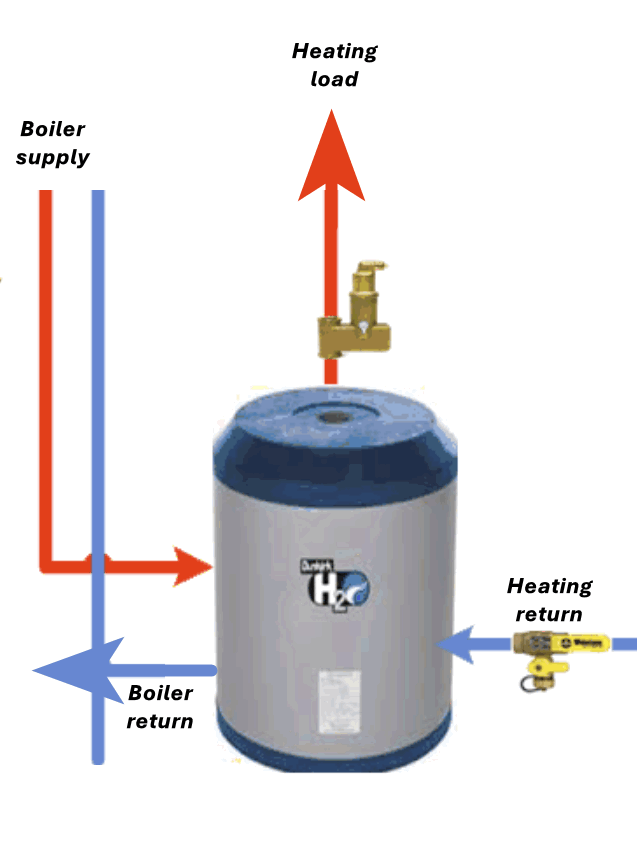

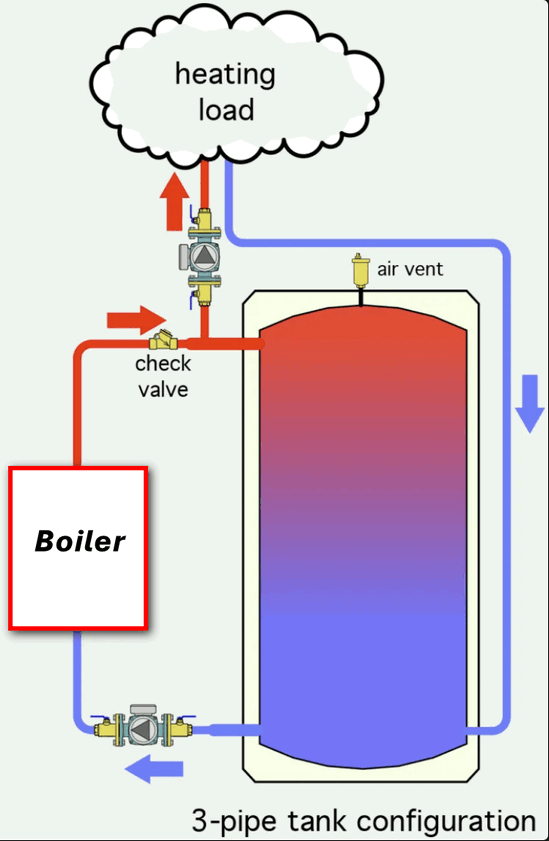

I just got a 40 gallon ECR International buffer tank, H2OBT402. This thing has seven pipe connections! Five two-inch and 2 one-inch (instead of just the five they show on the cut/installation sheet). I piped my old buffer tank like the illustration at the bottom, using the top side inlet for boiler supply. But I've been reading that best practices encourage using a 3-pipe configuration. That's going to really increase my install costs (new Tee, air vent, etc. and that still leaves me with the 2 one inch top openings feeding an internal coil that looks like it's feeding a repurposed DHW or solar tank. I would be interested in your thoughts.
what is the application or intent of the buffer?
There are cases where a 2 or 4 pipe arrangement are a good choice.3 pipe brings the lowest temperature back to the boiler or heat pump, and still engages some of the tanks lower capacity.
The upper or these two examples has a more direct route (direct to load) from the boiler to load without passing through the tank, I doubt you would notice much performance difference between the two piping options .

Thanks, Bob, that's what I was hoping to hear. The intent is to reduce short cycling and improve air elimination which my current buffer tank has done much better than the hydraulic separator I started out with 20 years ago.
