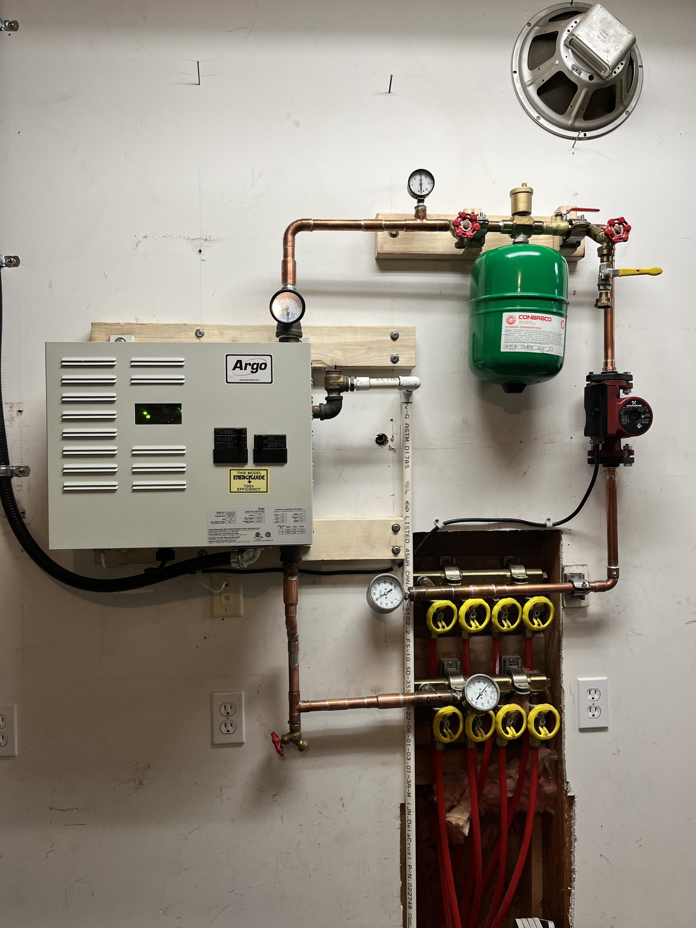

I have a shop floor heat system. Wondering if my installation is ok . It is 4 runs of pex connected to single manifolds. The out water temperature is only about 80Degree Farhenhite to maintain room temperature at 58 degrees. Any changes I should do ?

    Honestly, sounds like it's running great. 80° water might sound low if you're used to baseboard or radiators, but for a radiant shop slab maintaining 58°, that's pretty much spot on.
    Since the slab has so much thermal mass, you only need the floor a few degrees warmer than the room air to hold temperature. Plus running water that cool keeps your fuel costs way down, especially if you're running a condensing boiler or heat pump where low return temps keep it in peak efficiency.
    A few quick things worth checking just to be sure:
    Check the temp difference between your supply and return manifolds. You want to see around a 10° to 15° drop across the loops. If return water is coming back way colder than that, your pump flow might be a bit slow.
    Also make sure your PEX loops aren't over 300' each for 1/2" line, or friction starts killing your flow rate.
    Lastly, what kind of heat source are you using? If it's a standard non-condensing cast iron boiler, make sure you have mixing/protection installed. Returning water that cool directly back to a cast iron block will cause flue gas condensation and rust it out over time.
    If the shop stays comfortable at 58° on cold days and your loop lengths are balanced, I wouldn't mess with it much. Sounds like a solid setup.

    The picture looks like a wall hung electric boiler @Tom_at_NBS but I could be wrong.

    Ah, I completely missed the picture on my end earlier! Good eye, you're dead on.
    That's an Argo wall-hung electric boiler. No gas lines or exhaust venting to worry about, just that heavy electrical whip on the bottom left. That yellow sticker on the front boasting '100% Efficiency' is the dead giveaway for electric resistance. It's doing exactly what it's supposed to—just quietly feeding that 4-loop radiant manifold with the help of that little Grundfos circulator.

    Thanks for the replys . I wasnt sure if the low output temperature was a problem for the boiler tank as far as rust . I am assuming that it is a closed system that corrosion shouldnt be an issue. Just a note … the shop is 1000 sq ft, 4 -250' runs of pex making it single zone. 18 deg differential between in and out temps.

    With 80 SWT, 62 return , assumed flow of 2 gpm, (1/2 gpm per loop) you are delivering 18,000 btu/ hr to the space.
    The differential is just an indicator of the heat being delivered at that point in time. It may be wider on cold start and could tighten to 10 or less as the thermostat satisfies. Residential radiant designs around a 10-15 delta, for example.
    Is 58 warm enough for working in the shop?
    Was 58 on a cold day, or design day?

    58 is warm enough when i am working in the shop in the winter. Winters here only hit about 34 F, some times 28F

    Sounds like it's operating perfectly. Electric boilers don't care about return temperatures so the only reason to change the temp would be if it weren't keeping up on a nasty cold day.

    If it works, don't mess with it.
    I generally like to put my pump down low pumping up. This generally self primes and much easier to purge plus avoid the issue of air locking the pump in case any air is still in the system. I find it works the best like this:
    →return→(exp tank/fill/air sep)→pump→boiler→high point auto air vent→supply.

    you have some unusual pressure readings
    15 up top 70 & 80 below?
    Or are those potable water pressures?
