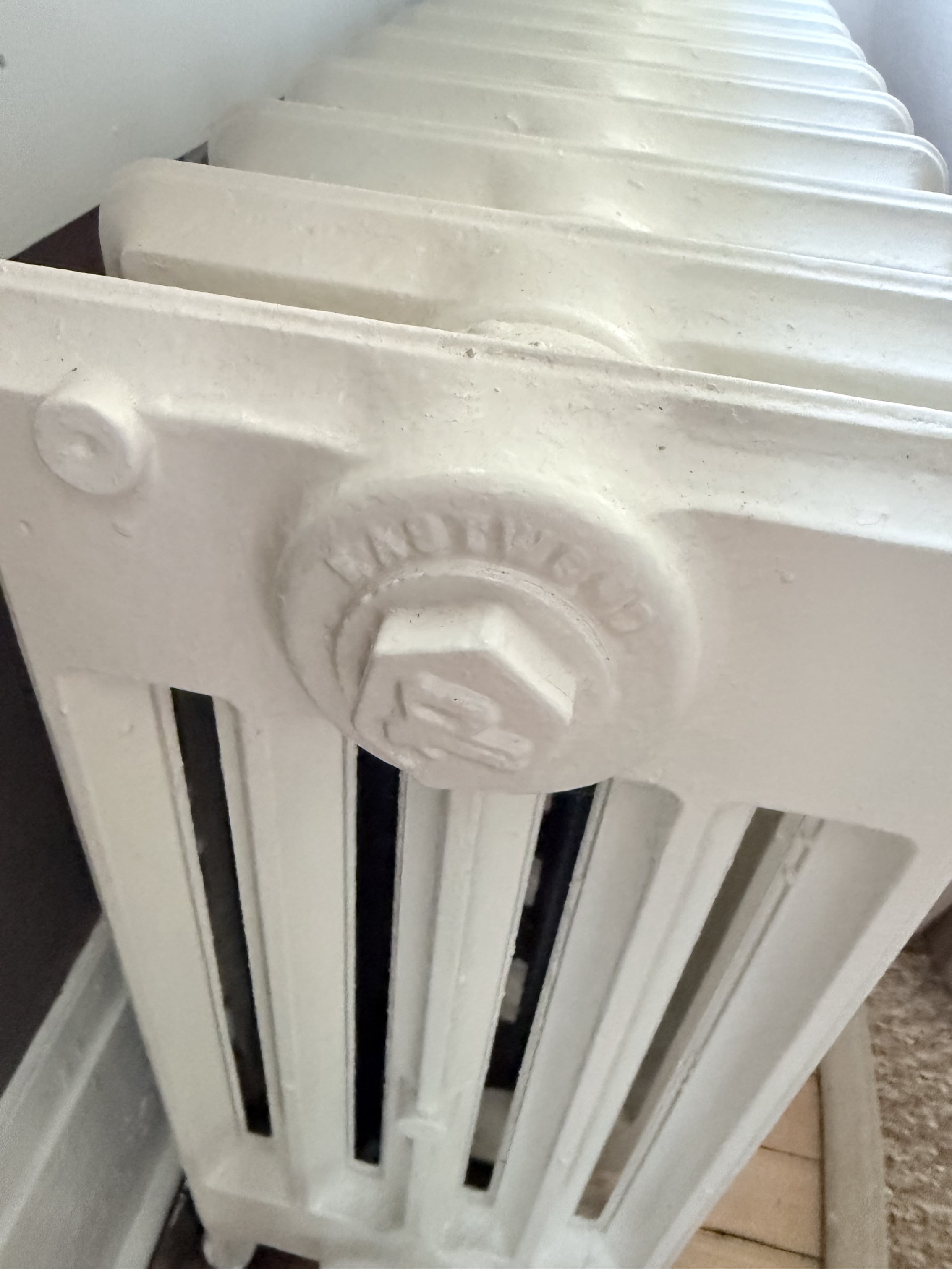

i’m currently trying to size a boiler to radiator sizes /edr. I have every darn radiator book and I cannot find these radiators in it which really surprises me. It seems like it’s an East Wood radiator. I’m going to attach a picture.
The Eastwood was made by Pierce, Butler & Pierce. It's a standard large-tube type. You can use any similar chart such as the American Corto or National Aero to look them up.
