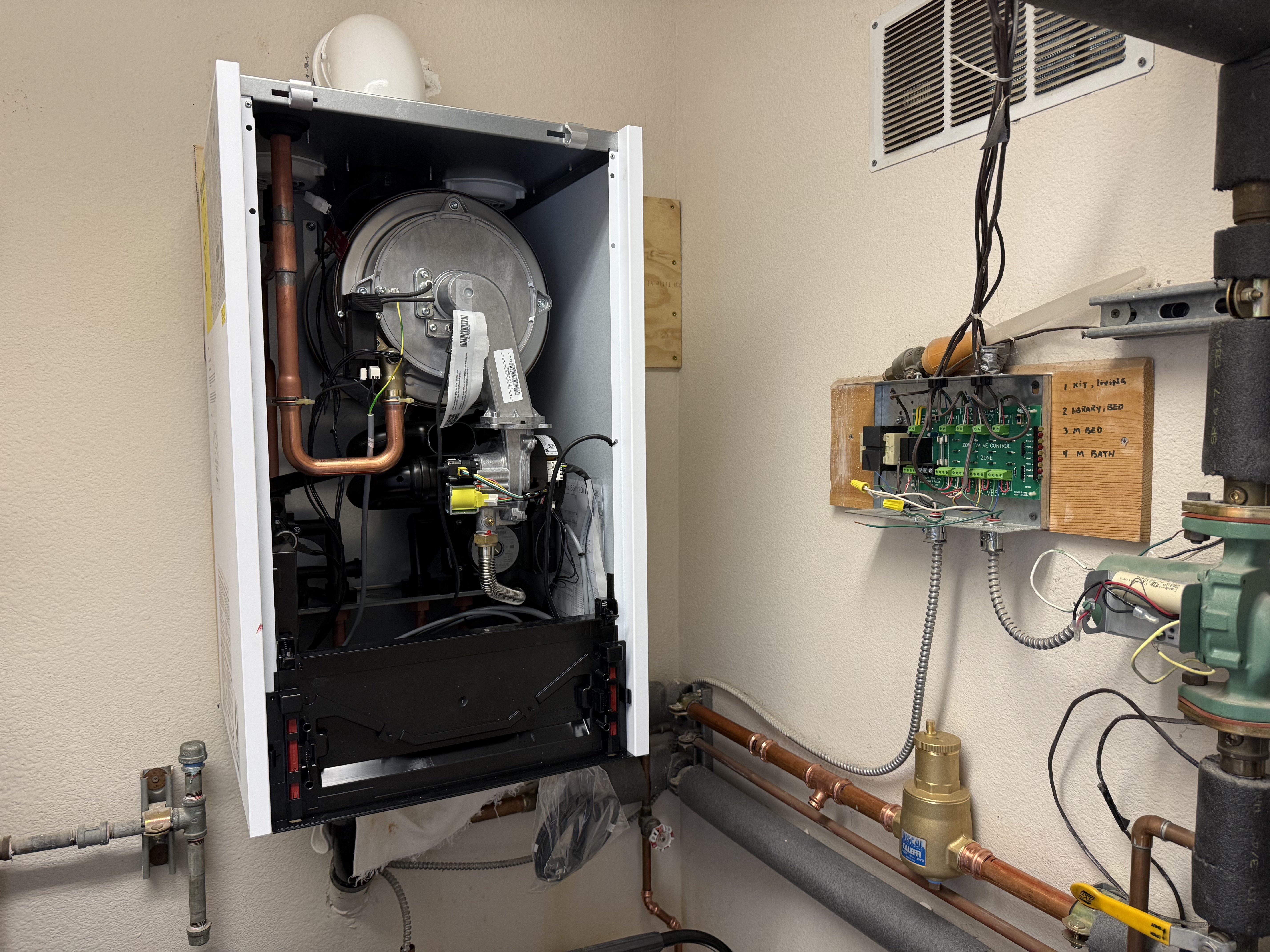

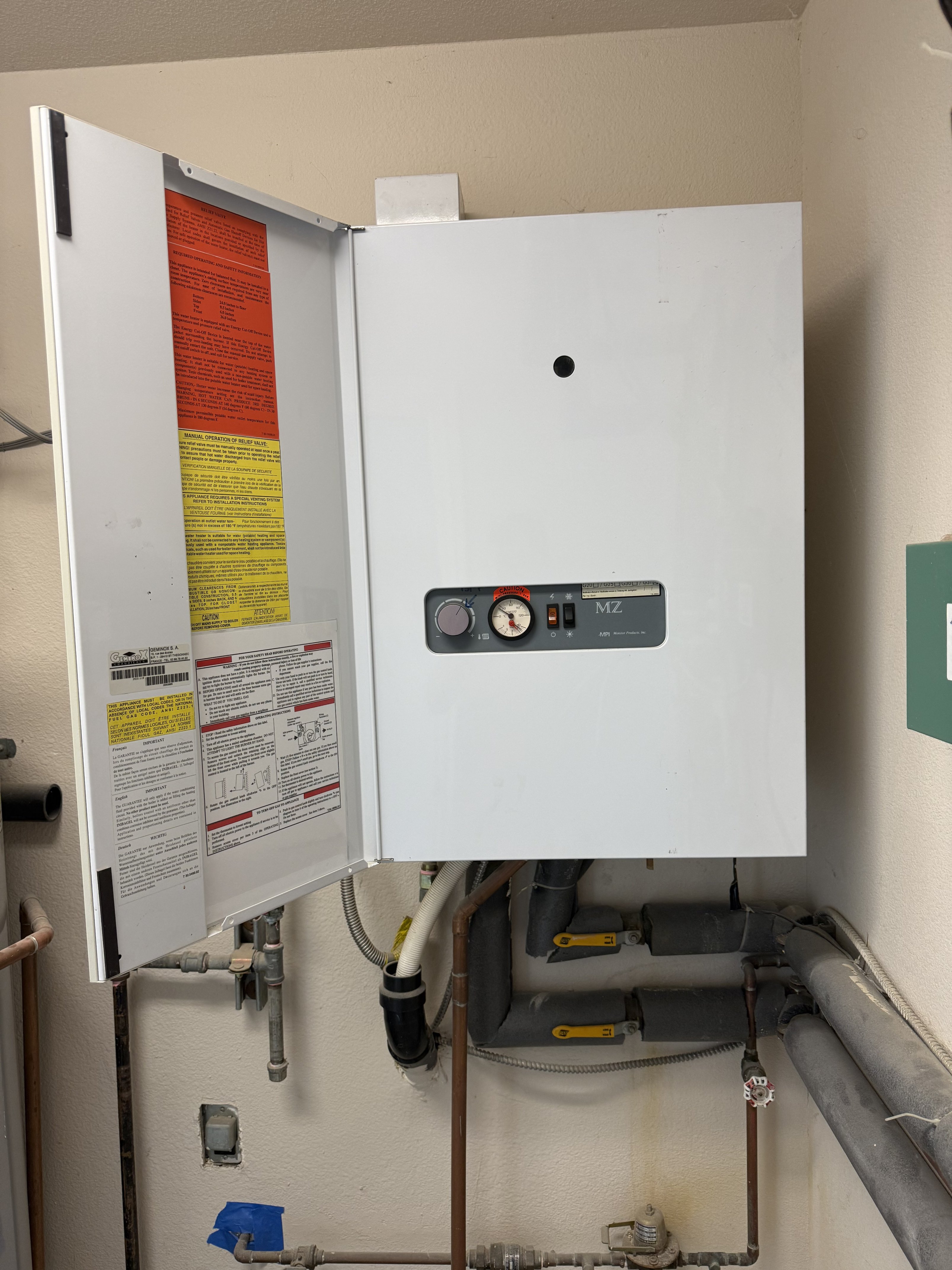

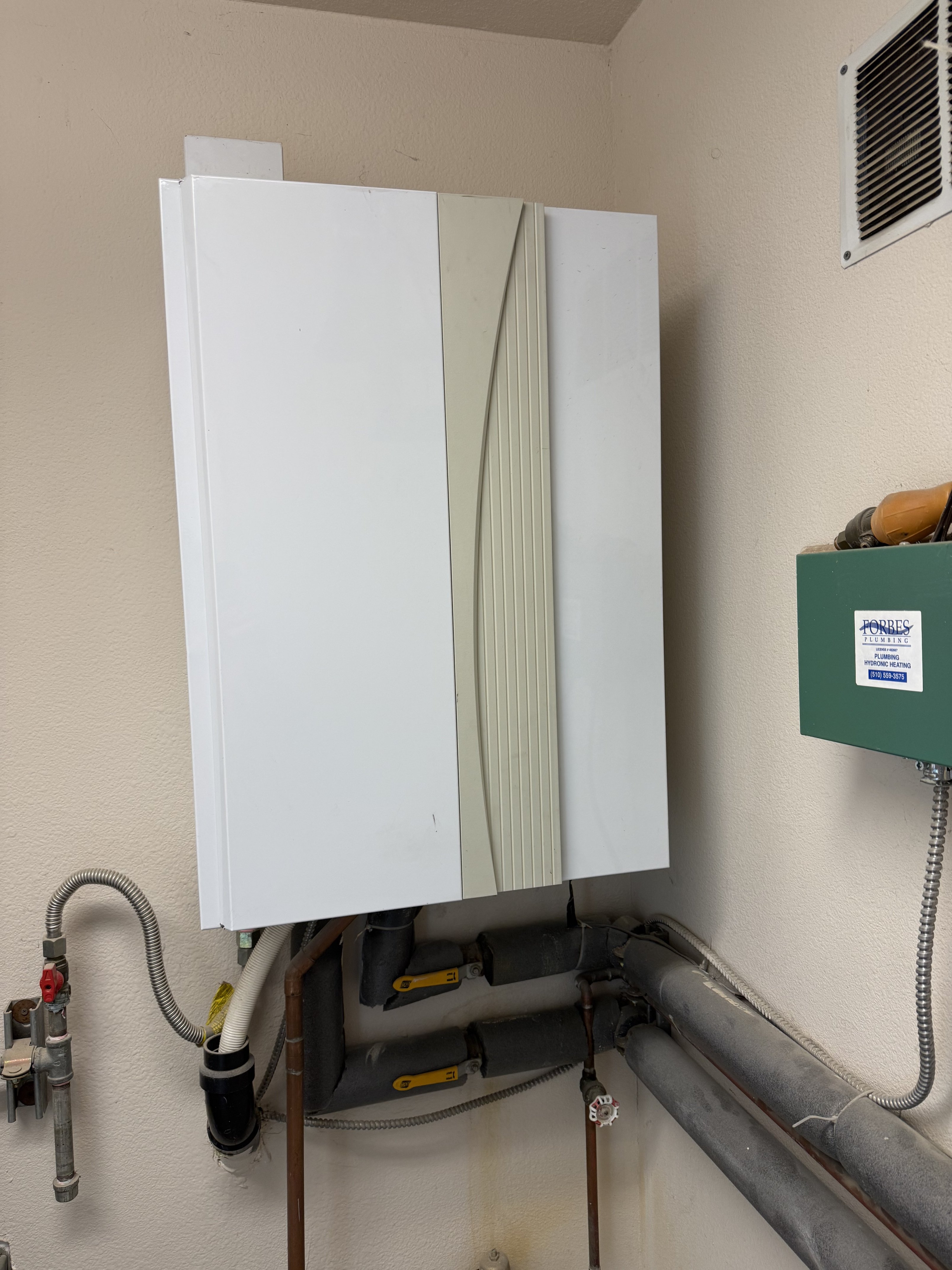

My Last Monitor MZ
Out of 6 we installed between 1999 and 2001, this was the last one that was still in use up until yesterday. They were one of the only decent condensing boilers that were available back then.
We are replacing it with a Viessmann B1HE.

    25 years is a good run for a mod con I guess. Some CI boilers won't do that now.
    hot_rod Posts: 28,699
    Original expansion tank also?
    Did it develop a leak in the hx?

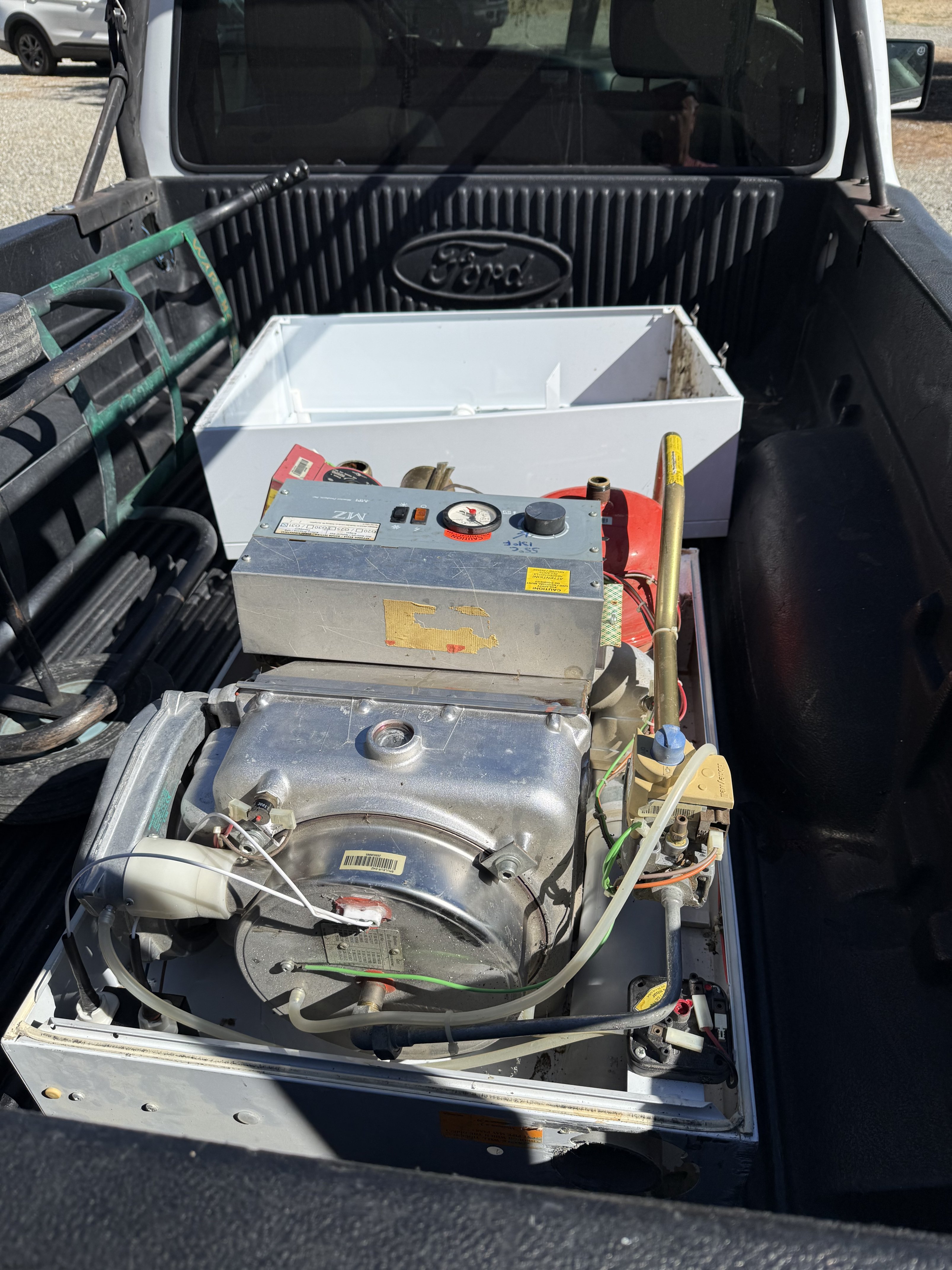

    Yes, same tank. I never tested the charge. It seems like a benefit to have an on-board x-tank, but you have to drain the boiler to test the charge on the tank. Also, it’s a proprietary part and not something I carry on the truck.
    The boiler was still sound, but the owners are getting older and thought it was time to upgrade.

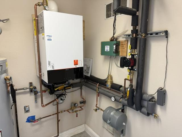

    Commissioning the Viessmann was all through the app. Even the gas type - this one is propane - is selected on the app. No mechanical adjustment on the gas valve.

    but you can plug it and put another tank somewhere else…
    Put that MZ on e-bay or FB marketplace. Could be a good parts boiler for someone.
    Search MZ here at HH, there have been a few folks looking for a door boiler over the years.

    Finished product. We changed the pump to a Grundfos Alpha, added an air eliminator, the expansion tank and gave them a new fill valve. We kept the safety high limit aquastat even though placement is wrong.

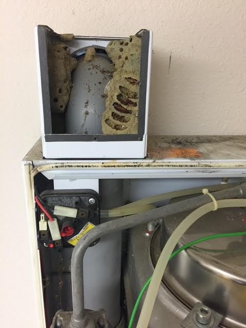

    Years ago, the old Monitor MZ boiler was acting up with loss of flame and we found mud wasp nests had clogged the air intake.
