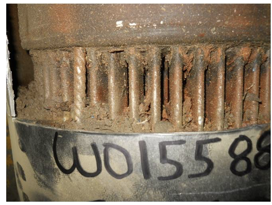

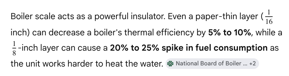

    hot_rod Member Posts: 27,913
    Even a thin scale coating starts hitting the efficiency also.

    "how often are you finding problems that trace back to poor system water rather than the boiler itself?"
    I almost NEVER trace a problem back to the boiler itself, for every no heat call that is due to a boiler part failure there are 10 that are due to system related issues. Poor water quality won't be the cause of the bulk of no heat calls so "how often" isn't a great metric, we would need to lump them by cost. How much does a failed zone valve motor cost VS the cost of a whole new boiler? Water related issues rarely manifest themselves in simply a minor symptom, they manifest as catastrophic failure (see above photos)
