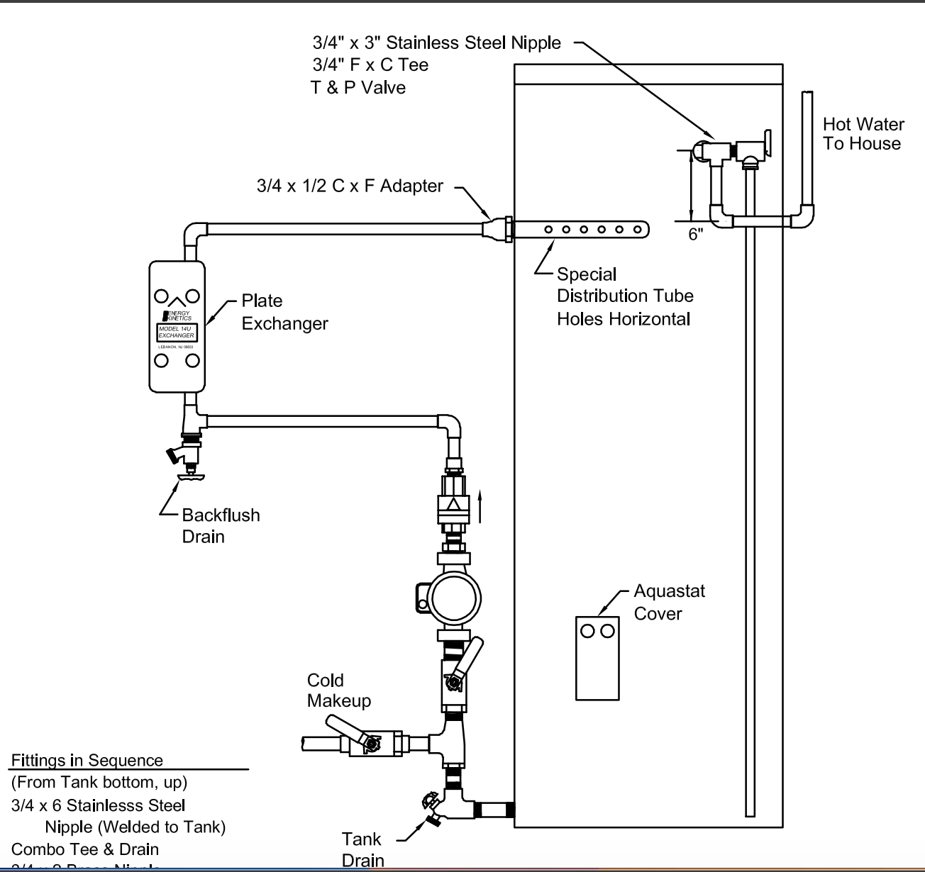

Hello all,

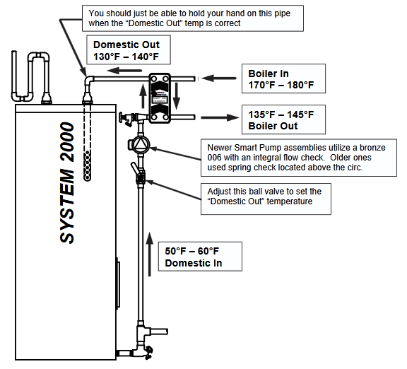

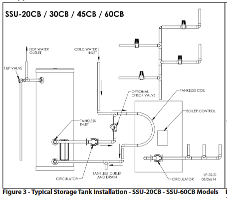

I have an EK-1 standard rear clean-out with heat exchanger that needs a new hot water tank.
I have a brand new HTP superstor SSU-45CB tank (no indirect coil) that my folks didn't end up using when they switched over to whole house heat pump setup.
Question is how best to plumb it since EK's diagram is pretty much opposite of HTP's diagram. EK wants a cold draw off the bottom and a dip tube into the top for hot return. The HTP only has side ports at bottom and maybe 1.5 feet up and shows hot return on bottom of tank.
My thought is to pipe the hot return into the top side port on the HTP to maintain a little stratification and or maybe add a dip tube into the top port but I'm not sure if a horizontal dip tube would be beneficial.
Thoughts on piping this tank? Thanks!

    Hello gentlemen, For the record I sent a Pm to the poster with a drawing i quickly scratched out in between classes I was teaching today. I believe we have handled this for him.

    Here is a better version of the drawing.

    Thanks for the responses. Per RobertW's PM I should plug the top side port and T into the top most port for hot return from the heat exchanger and feed to the house with a mixing valve. Cold feed to remain off bottom tank port.
    The drawing posted shows differently though with a horizontal dip tube in a side port but much higher in the tank than the HTP side port that I have which is maybe 20 inches off the bottom of the tank. The hot water feed to the house is shown separate which aligns with the current tank top port.
    not clear which to follow?
  • Robertw
    Robertw Posts: 95
    The Ek drawing i posted here would be the ideal way of piping. The drawing not shown has the output line of the plate exchanger tied into the hot out-line at the tank. It is recommended to install a tempering valve either way on the hot water line to protect from scalding.

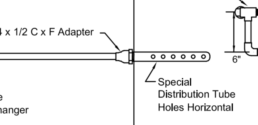

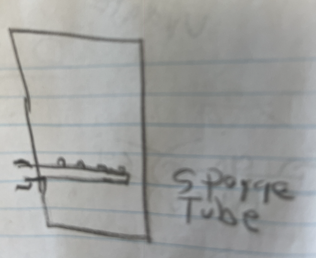

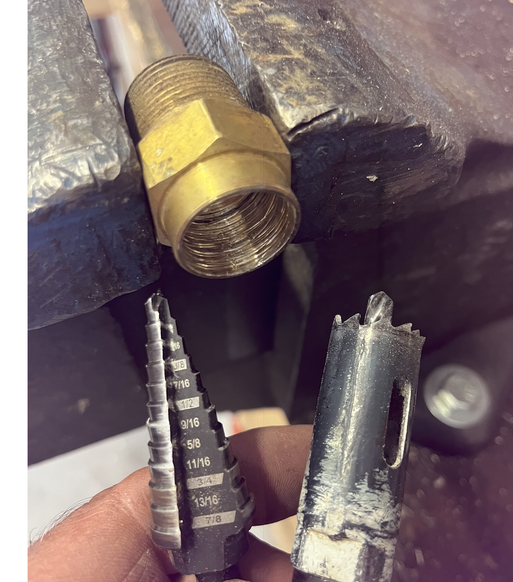

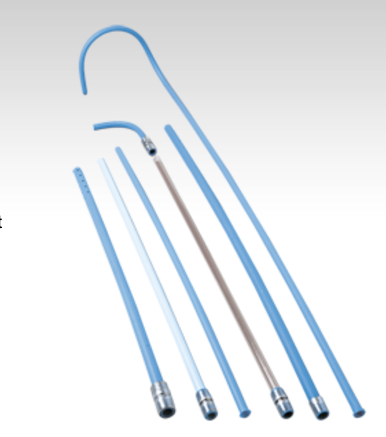

    That is sometimes referred to as a sparge tube.
    If it is worth the effort you can drill into a 3/4 copper to male adapter and add a tube to go into the tank. Cap the end and drill a series of 1/4" holes to divert flow to the top of the tank.
    I think this is part of the post purge function to load that extra "purge into the top of the tank.

    The picture hot rod posted shows the connections I have B/C/D. Port B will be cold out to heat exchanger and drain.
    Per Rob's message he suggested plugging port C.
    Port D would then be the heat exchanger return and domestic hot supply. I will be using a mixing valve to keep tank temperature higher. So should I install a dip tube in port D and T everything off this port?
    Would it make sense to put the dip tube in port C with holes facing up given it is only 14.5 inches up the tank? Then use D for the domestic feed? Seems like C may be too low in the tank.
    I plan to give Rob a call over the next few days but figured I would post these questions anyways for future reference for others.

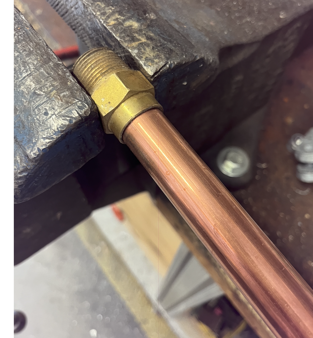

    I have drilled out compression connectors so copper tubing will slide through them to make a dip tube. Used them on top of oil tanks to get the suction line to the bottom.
    never tried it with a sweat fitting though.
    And no, don't tell me about compression fittings on oil. The duplex tank bushings you by for oil tanks come with compression fittings for that use. I just didn't have any on that job.

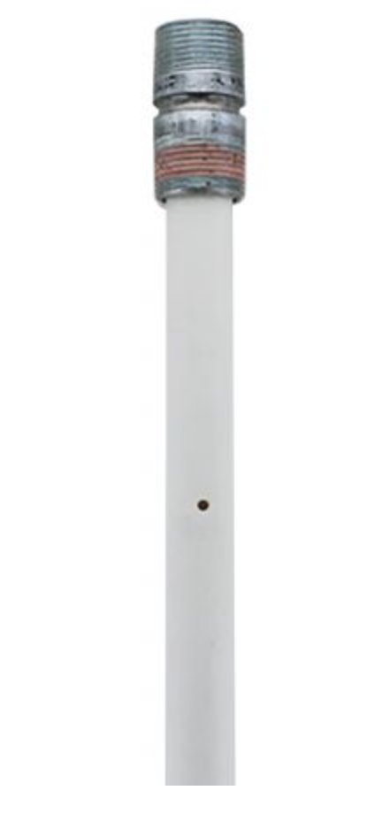

    You can find sparge tubes from the manufacturers that make dip tubes. Camco and Apcom, for example.
    I have not found a non ferrous double tapped bushing or duplex ? I suppose easy enough to build one from a bronze bushing.
