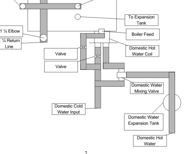

    Their schematic drawings with regard to the installation of the PH-5 expansion tank leave a great deal to be desired.

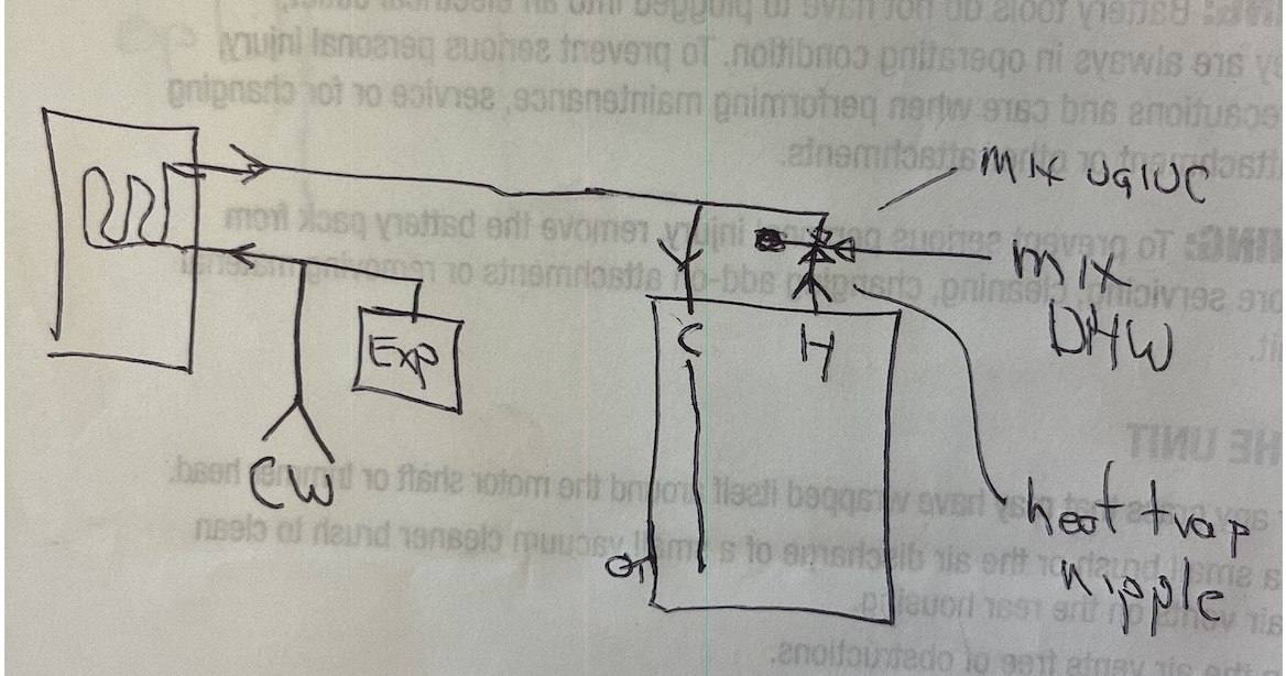

    hot_rod Posts: 28,776
    Ideally the thermal DHW expansion tank would be on the cold feed in this pic. (domestic cold water input) As long as tnere are no check valves between the boiler DHW coil and the expansion tank connection.
    No harm in oversizing the thermal expansion tank, the 8 gallon DHW tanks are not so common, so a #5 or #12, 50 or 120 gallon tank size, should be adequate.
    Corrugated copper flex lines rarely fail, braided EPDM probably a safe option, although they do have a temperature limit. Another reason to have the tank on the cold inlet, keep it operatig in a cooler temperature water for extended life.

    thank you for your comments, they are most welcome. What bugged me about the whole thing is my external domestic hot water coil that was mounted on top of the Switzer CWW 100 had a huge 3/4" copper coil that served us for 33 years before this with no issues.
    My initial plan was to use a 5 gallon domestic expansion tank for this new installation attached to the wall with 3/4" K copper pipe and fittings.
    I will mount the new 5 gallon tank on the wall and connect it to the cold side of the domestic hot water coil per your suggestion.

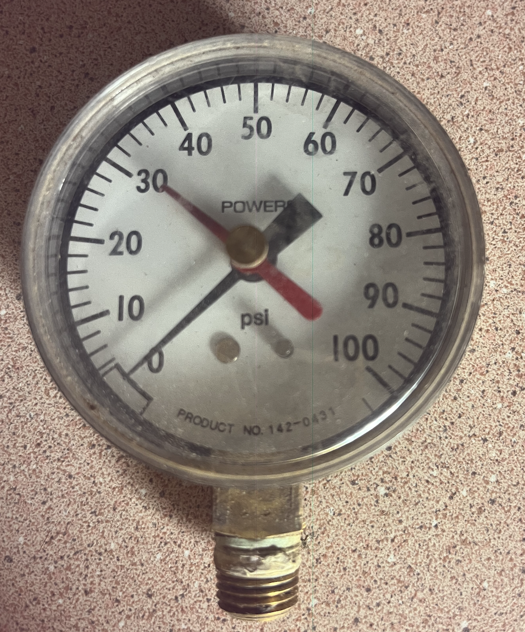

    You could always install a "lazy hand" indicator gauge like this to see if you get expansion related pressure increases. It's really the only way to know IF and how much pressure increase you are getting.
    Spring checks without some good differential are not a "bubble tight" seal, so some expansion could slip by.

    The hot and cold swing check valves have no springs. I am going to assume the check valve in the 3-year-old Bradford White water heater has a spring.
    You are right Bob, installing a pressure gauge in a tee with a lazy hand would be a good idea, I have more to think about before changing the piping.

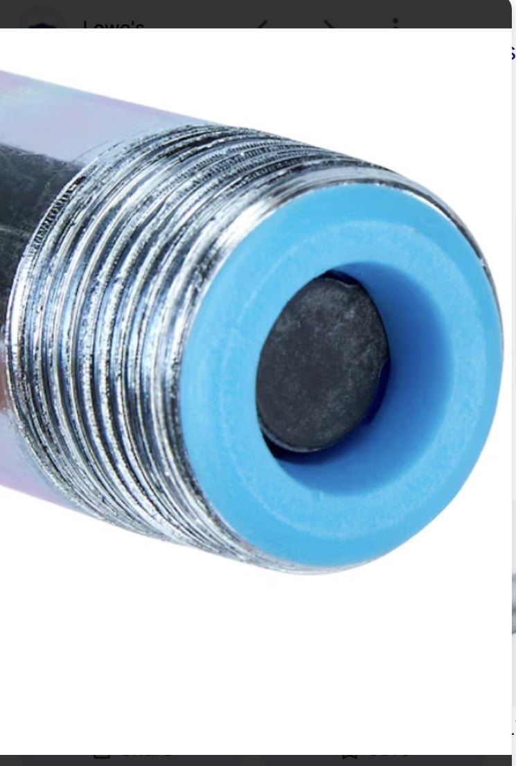

    I don’t know that the BW tank would have shipped with any check valves?
    It probably has heat trapper nipples which have a rubber flapper, sometimes a plastic ball. The intent is to slow any potential thermosiphon, keep the hot water in the tank. These are not a tight sealing check valve.
    They are also the dielectric nipple for the tank connections.
    A swing check is intended to be closed and sealed by pressure differential
    Think of a sump pump that pumps water out of a pit. When it shuts off, the water flowing back closes and seals the check. So pressure on one side only.
    In a hydronic system or domestic recirc, when the circ shuts off, pressure is the same on both sides of the check. So a swing check is not an ideal hydronic check.

    Is this what you have? No circulator puymp, just flow through the coil to the tank?
    With a boiler tankless coil it is wise to have a thermostatic mix valve. AngleMix 520 is an excellent valve for tankless water heaters or coils.
    The tank most likely has a heat trap nipple on the hot discharge, no need to add another check
