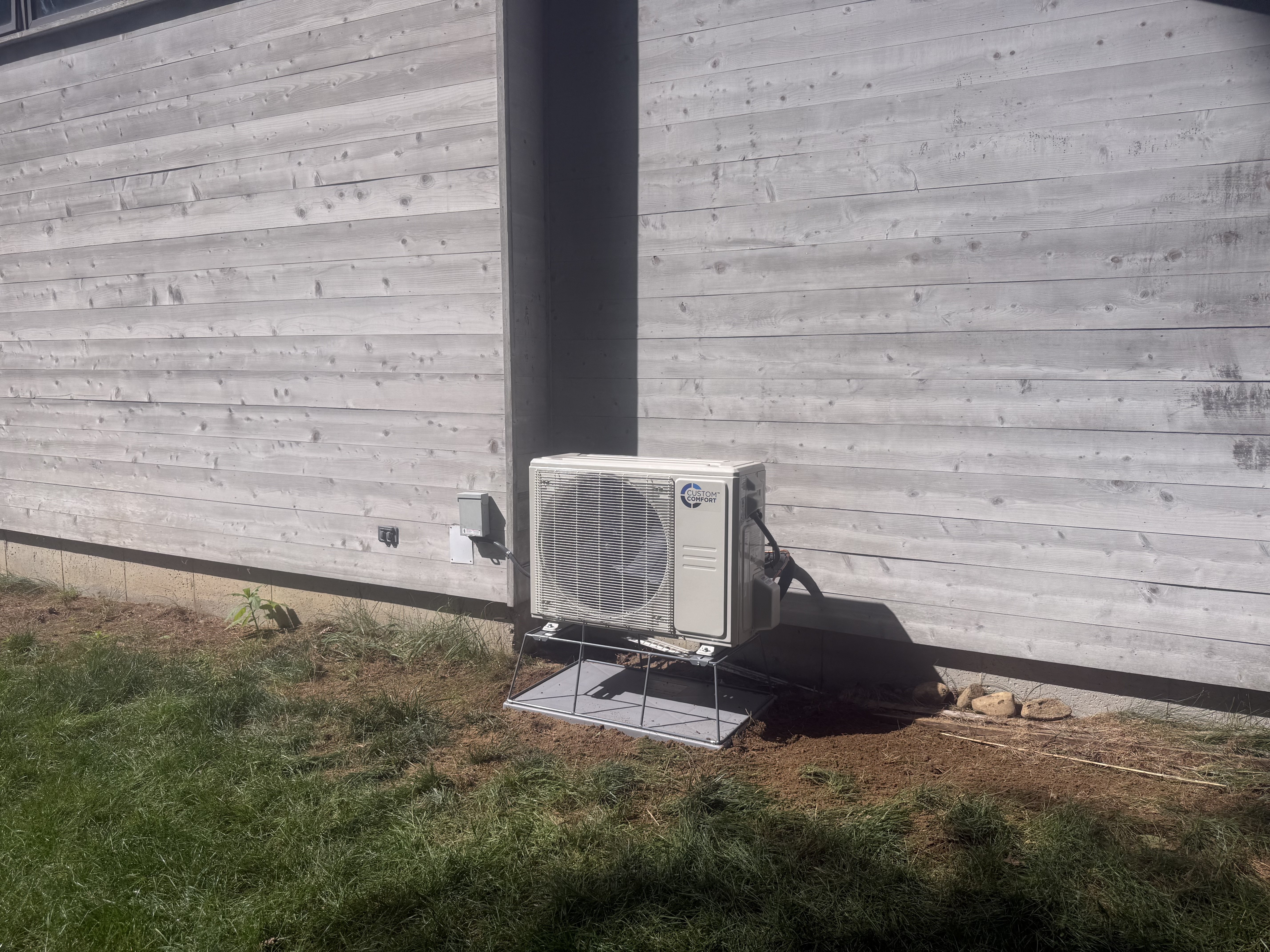

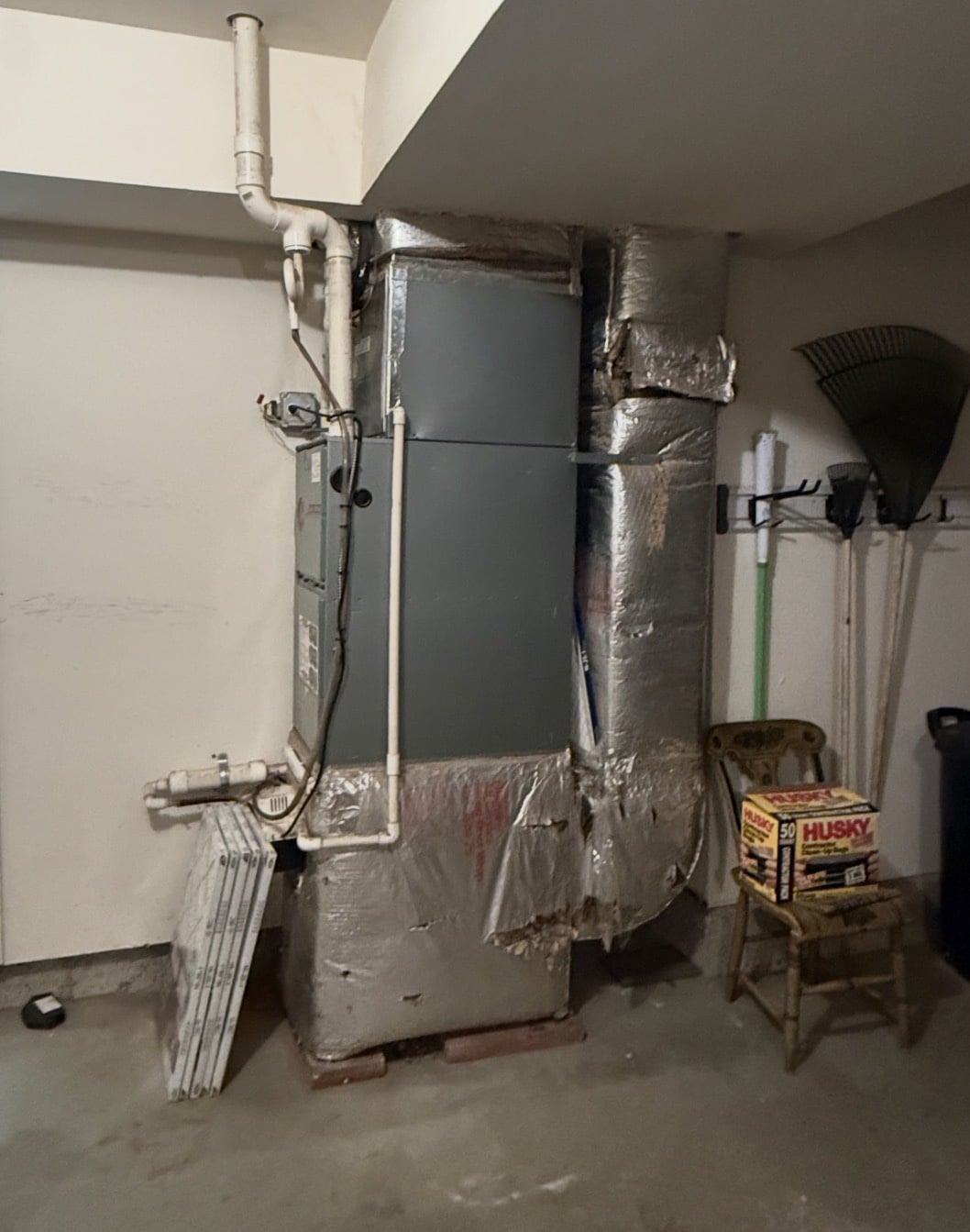

Yesterday‘s job- We pulled a traditional furnace/AC. Installed a new heat pump system.

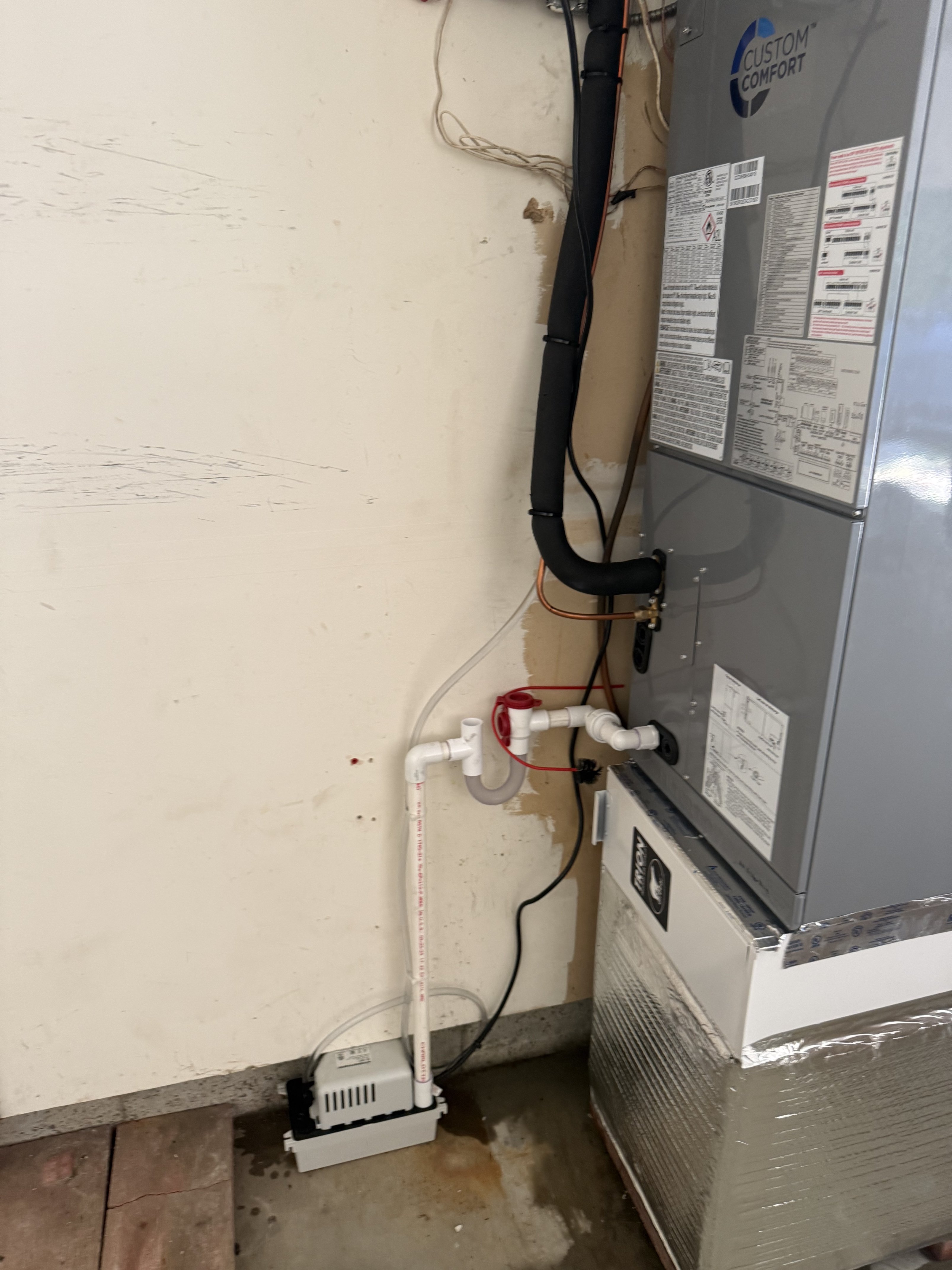

We tied the new Condensate pump into the existing 3/8 copper that was stubbed into this area, through the slab.
Get the message this morning- water all over the floor. My first thought is the new pump is dead, which would not be the first time.
Upon arrival, the pump is not overflowing
I pull the air filter, the return Plenum is dry as a bone.
I’m starting to scratch my head.
I pour some water into the drain pan and the pump comes on, a puddle starts forming right below me.

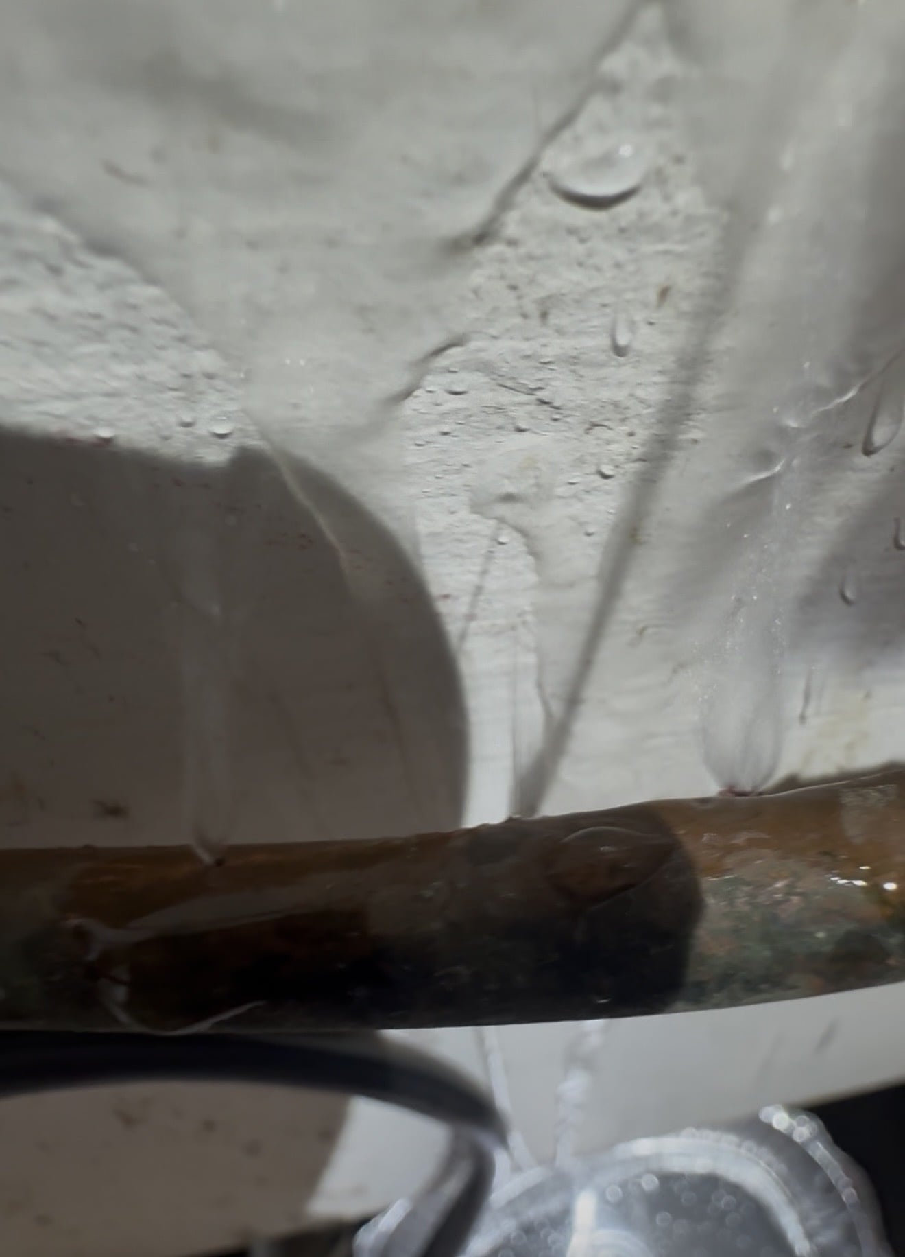

It occurred to me, the pH of the furnace’s condensate water ate away at the copper. Everything was fine until we touched it.
I wrapped some elec tape on the affected portion, as a stop gap. It’s a holiday after all. I pour some more water. A new section starts leaking 6” away. Repeat this process again. This time the water is pouring out where the copper enters the concrete. It’s falling apart in my hands.

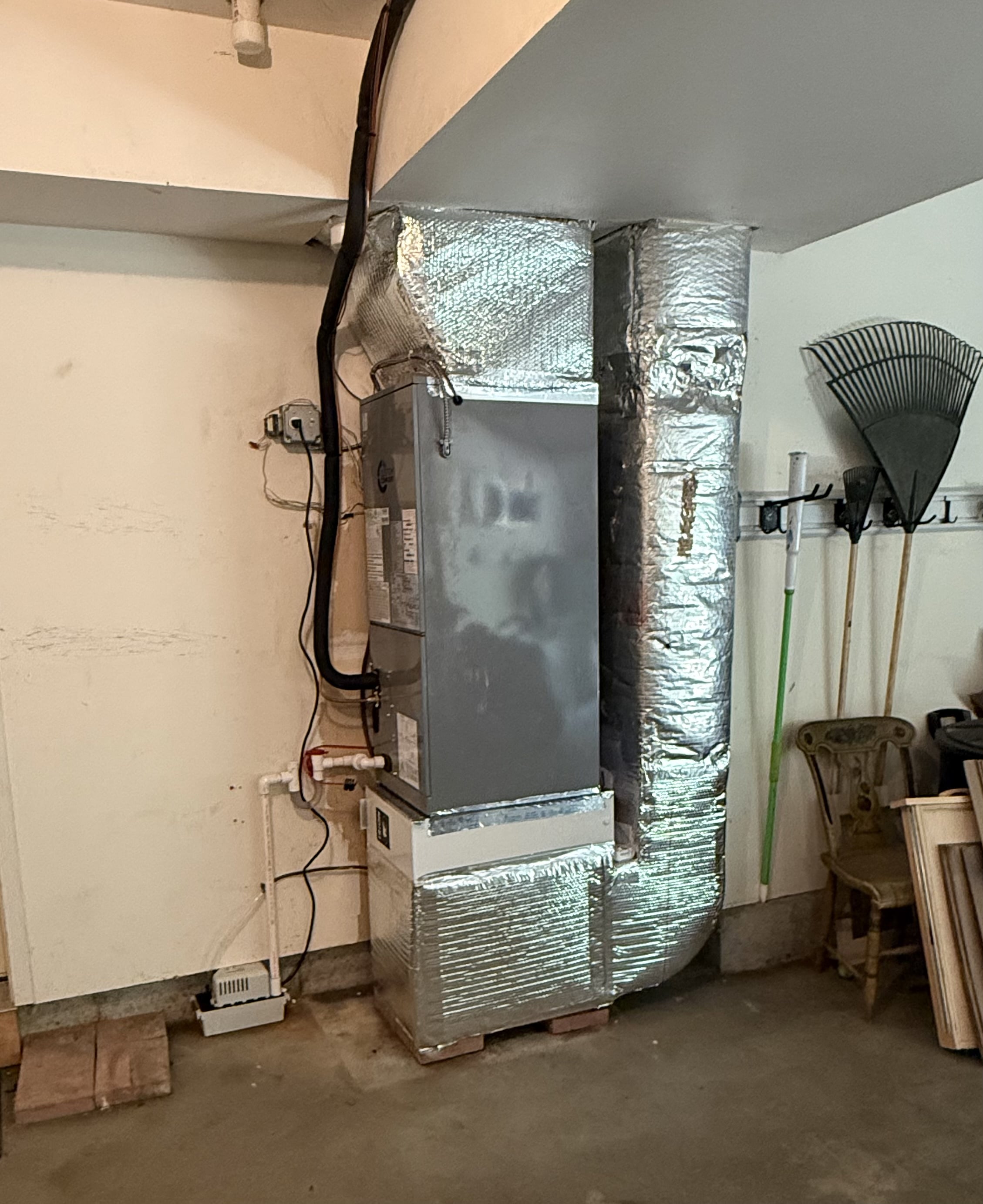

Getting a new line to the sink where it ultimately drains means crossing through a finished portion of the hallway into the finished bathroom.
Because it’s hot outside, my brain is going slower than average- it occurs to me: No more furnace, no more need to worry about condensate freezing in the winter time. I dig a roll of 3/8 vinyl out of my vehicle and start zip tying, following the new line set.
The inner geek in me popped out, can anybody spot some random act of OCD? it’s extremely minor, but I’m quite sure 99.9% of the technicians out there would not have done this. It’s something that the astute homeowner might even pick up on. You may need to zoom

    the union between the trap and the coil?

    Hmmm, The loop in the vinyl tubing, before the condensate pump? 🤔

    no, we generally always give it a loop. But you’re on the right path. More simple, more simple
    remember, OCD, there was absolutely nothing functional about this, just aesthetic.

    what’s black and white?
    nobody switches color once they start this process, you just keep going with the color you have

    it is matching the zip ties to the pipe and the armaflex

    The old furnace was a condensing type dumping combustion condensate down the copper line? No neutralizer?
    AC condensate is slightly acidic maybe in the mid 6 ph. It would take quite some time for that water to eat away copper. Exposure to the Co2 in the air would buffer up that condensate
    Condensate from condensing equipment can be in the 3 ph range

    yes the zip ties- I changed color. Teensy detail, I realize.

    Insulation - no, this is known as their “24 Volt” system. The expansion device is indoors.
    I believe custom comfort (this is made by Midea btw) has the opposing system, EEV outdoors. But I want get a firm grip on the 24 V system because we install these setups on furnaces here and there.
    If the expansion device is outdoors, (let’s think of Mitsubishi), etc., then both lines are insulated.
