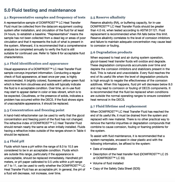

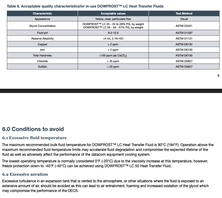

    hot_rod Posts: 28,816
    If you go to most any glycol manufactures website, they had guidance for glycol care and replacement intervals. Here is the Dowfrost PG page. Other or unknow brands would be tested to the same criteria.
    You can send a sample to the manufacture or a lab if you want to know everything about the fluid.
    For the amount you are talking about, replacement after a cleaning makes sense to protect the new components and maintain warranty.
    Ph is a very simple test you could do as the starting point. Test strips or kits are not expensive. Below 8 ph indicates time to replace.
    Glycol blended on site need to be with deionized water, not tap water.
