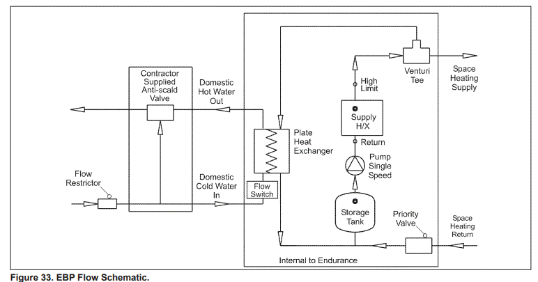

Customer in small home with a single loop system is getting heat to the baseboard during the summer. She reported the it was random, but almost daily. Also the owner moved in this past December so we don't know if this problem occurred during previous summers.
This is a LAARS EPB-110 with domestic hot water.
What I found todays is that it happens when the boiler is responding to a domestic hot water demand. To prove it to my self I flushed the single loop to get it cold. With the boiler sill warm there was no drift up the return or supply.
Then I ran hot water long enough to get the boiler running and heat started moving out the supply line at least as far as the first few baseboards. The heating circulator was not running, I verified there was no power to it.

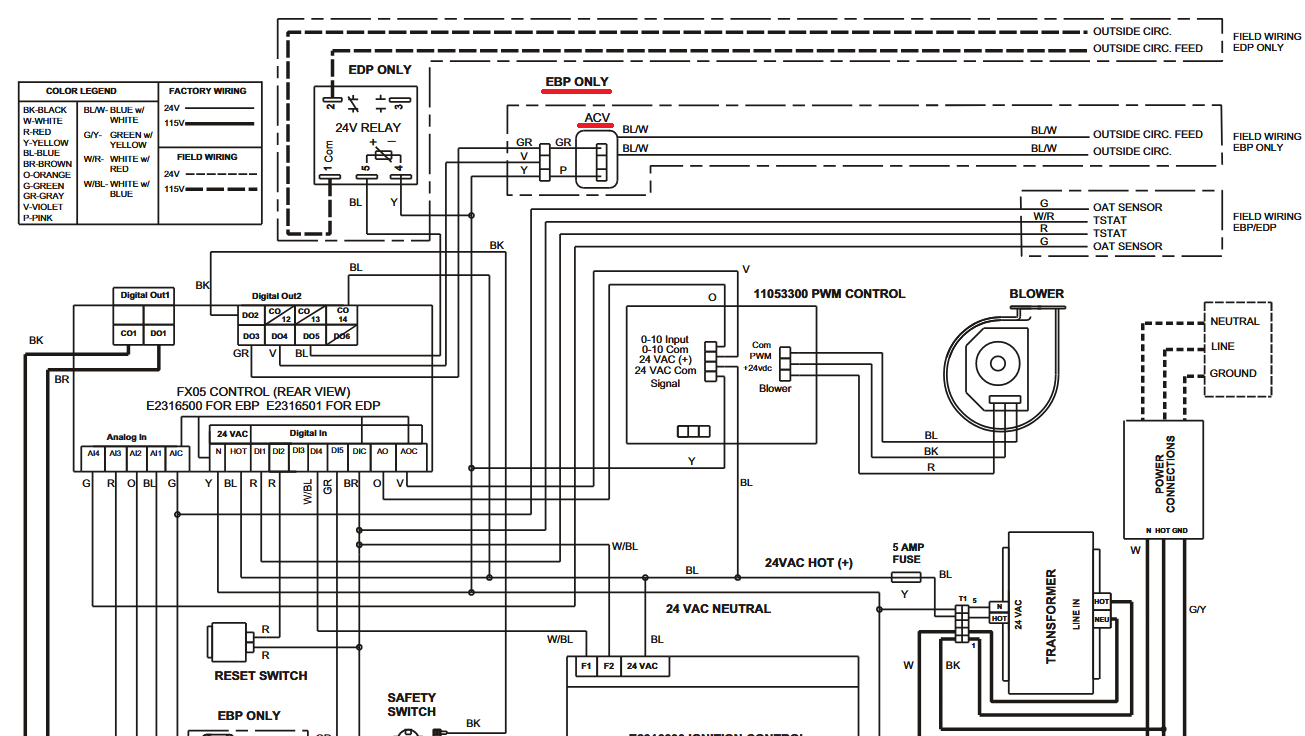

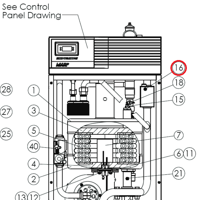

Boiler internal diagram

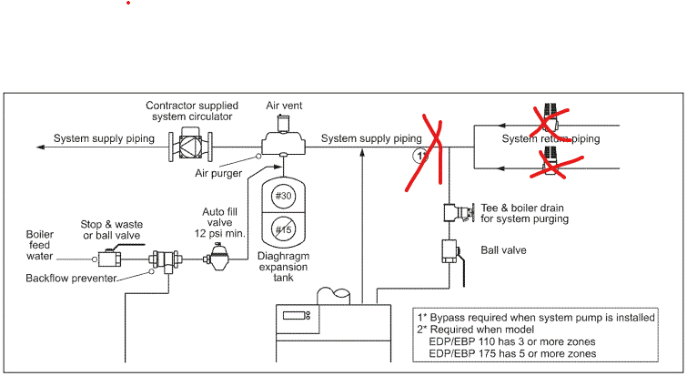

Heating diagram from manual. Piped exactly like this excpt no bypass and single zone, no zone valves.

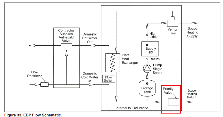

    How is the priority valve controlled? If DHW is the priority the valve in the heating return should be closed on a DHW call.
    109A_5Robert_H
    109A_5 Posts: 4,759
    Hmmm… Space heat water flow during a DHW Call ? I'd be very curious how the 'Priority Valve' works and its integrity. Looks like the 'Priority Valve' may also called an 'Anti-Condense Valve', it looks like it has an End Switch for external circulator control.
