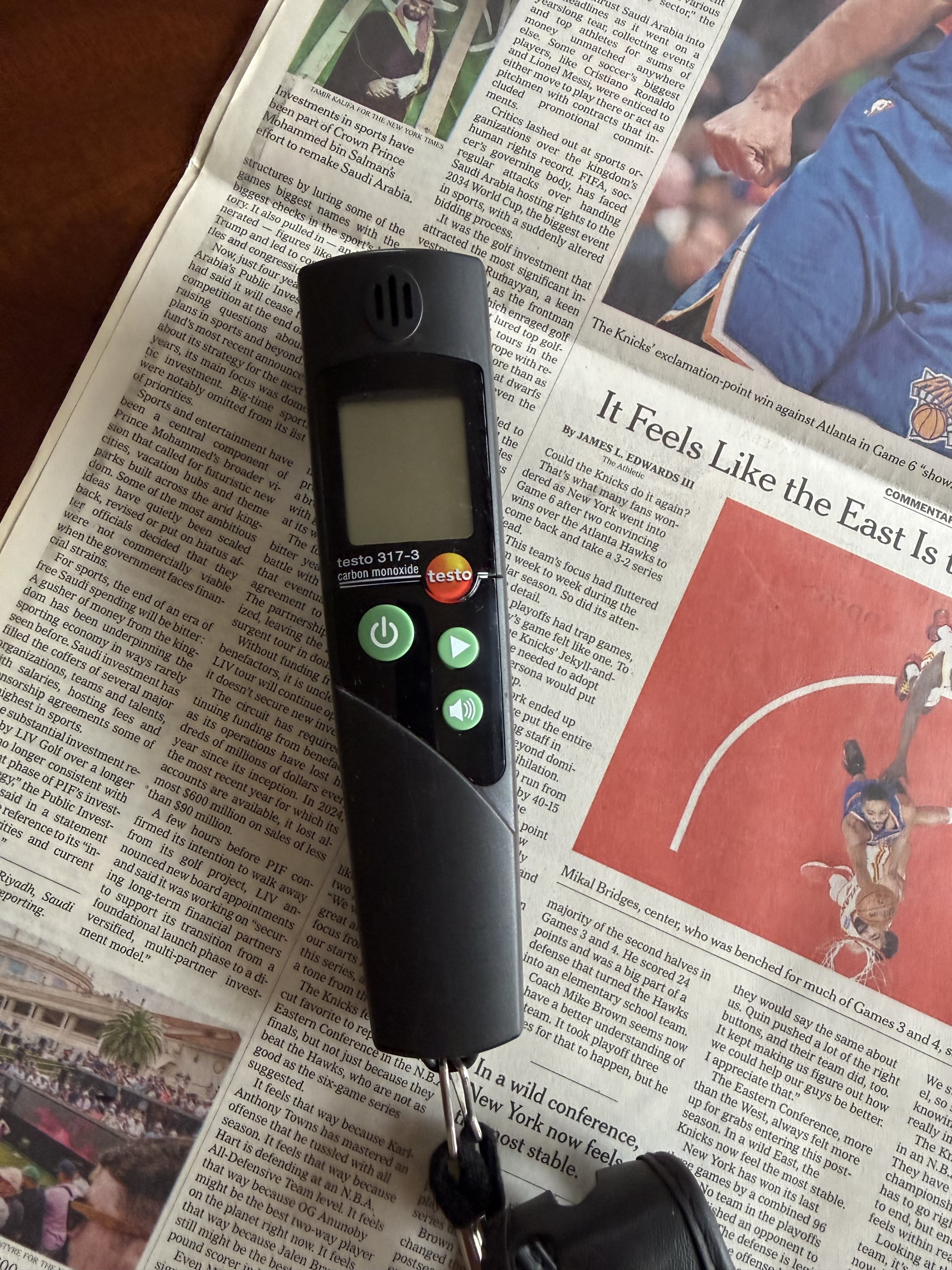

    Yes, Testo calibration is expensive, but I don’t think you need to do it every year. I gave away my Bacharach because of the yearly cost of sensors, close to $600.
    You can send the Testo in during the off-season or if you don’t like to be without one on your truck like me, buy another one.
    As far as a personal meter, I use this one.
