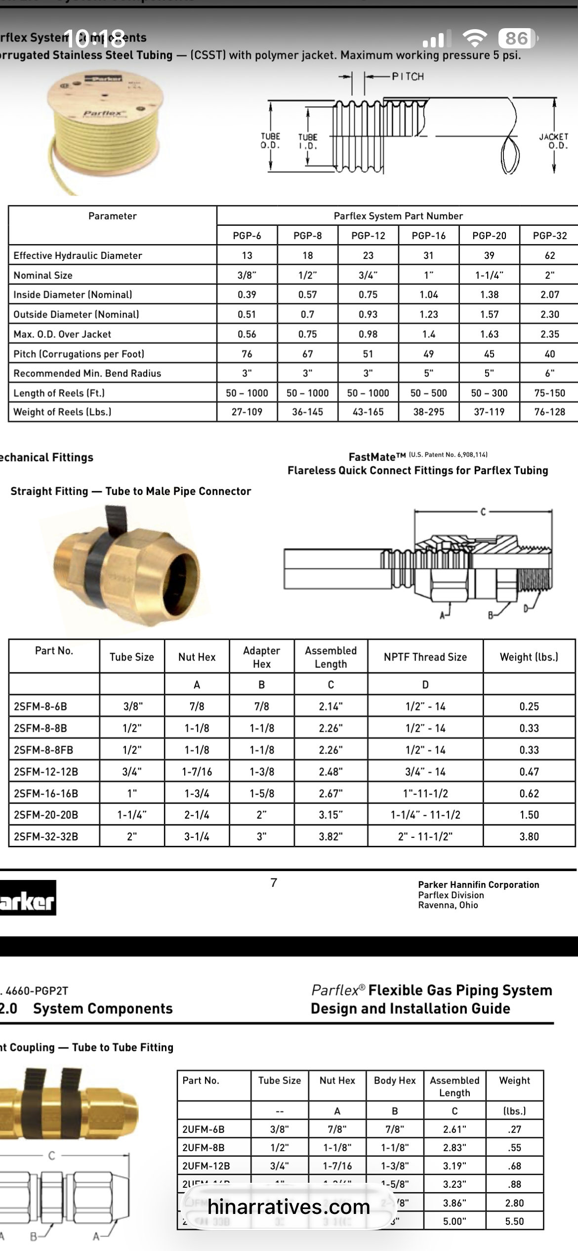

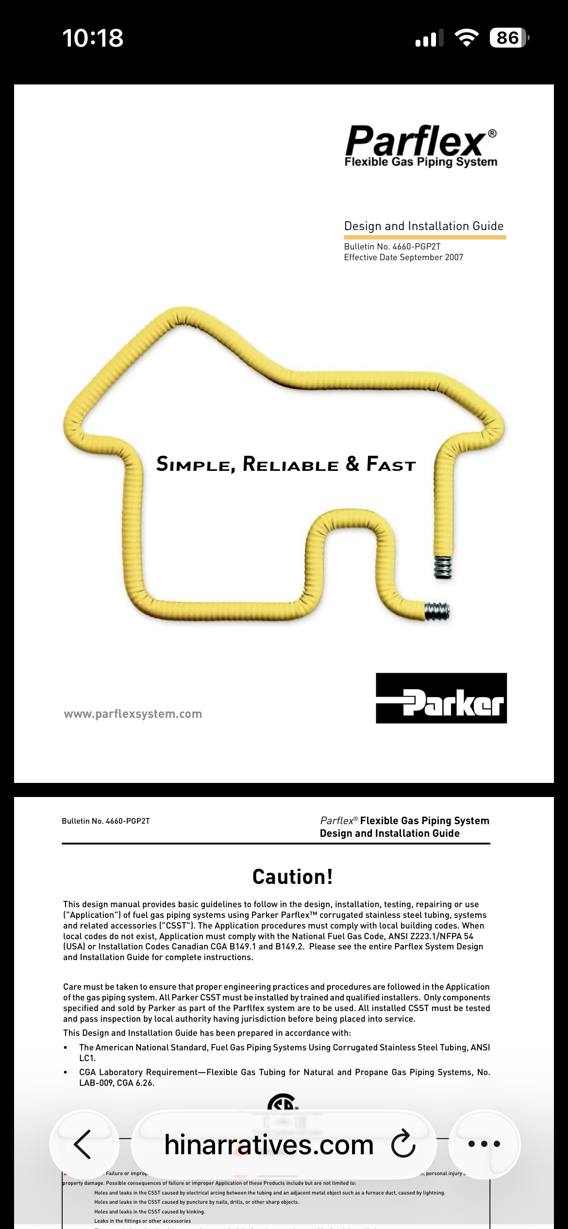

I have a 3/4” Parker flex gas line and cannot find these Parker fittings anywhere!
Please help
Thanks Steve
Are you sure it is CSST?
Parker make all kinds of fitting but I never herd of them making CSST. With CSST the fittings and the tubing have to be made by the same MFG if I am not mistaken.
If your sure it is Parker then contact them
probably find a dealer near you on their website, or Google search the Parker part #
