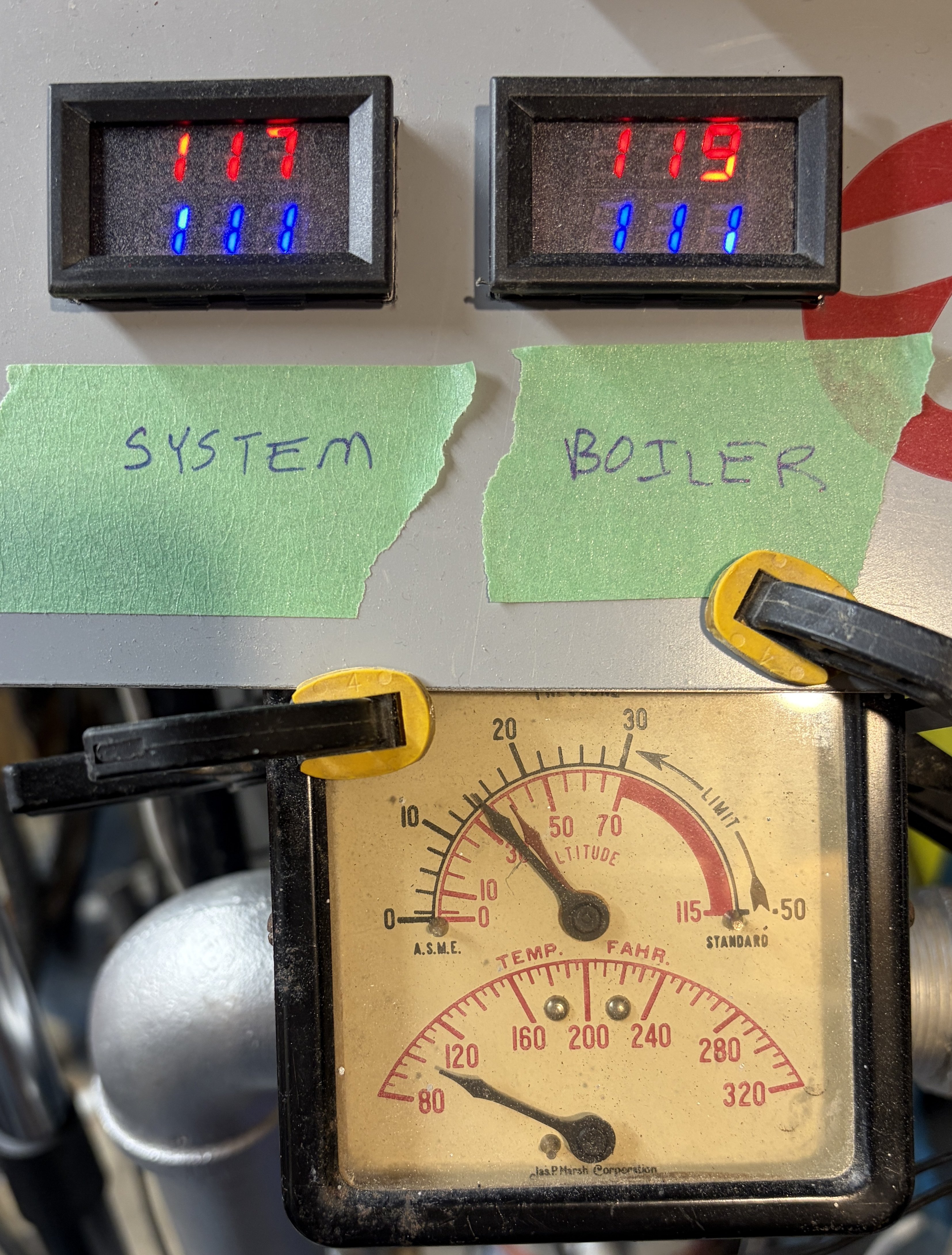

Thanks to Caleffi 280 Thermostatic Mixing Valve.
  • HydronicMike
    HydronicMike Posts: 471
    Care to explain what's going on?
    it looks like you're condensing in a boiler not designed to condense although you could be nearing ok on an oil boiler
  • EricPeterson
    EricPeterson Posts: 308
    Just that the valve ensures that the return water temperature for my CI boiler meets the minimum of 110F, even during this shoulder season when the boiler is hardly running.

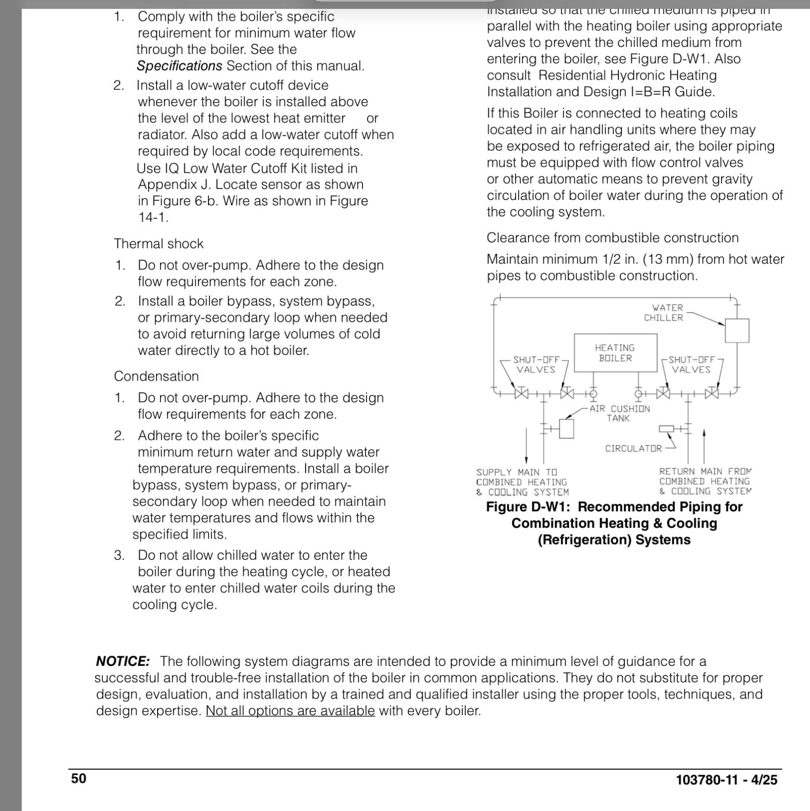

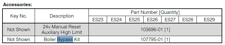

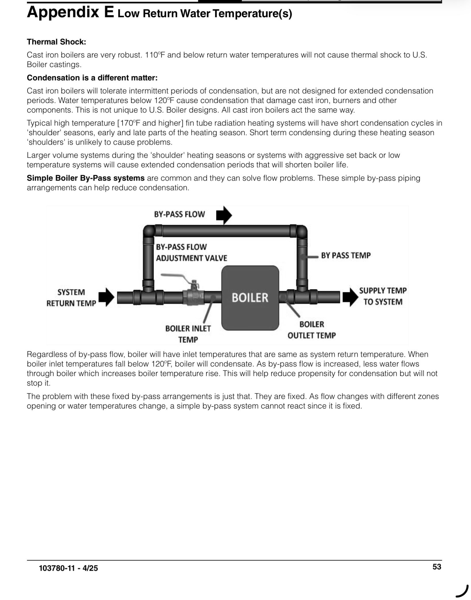

    hot_rod Posts: 28,699
    The manual for that boiler is a bit confusing. They seem to indicate 120 as a minimum return. They also show a few protection options, but even the temperature controlled bypass (optional kit) is not 100% protection
    Does the 110 return number shown in the manual assume the bypass pump kit is used. Because the mention 120 and 110. While the fuel dewpoint may be closer to 130f.

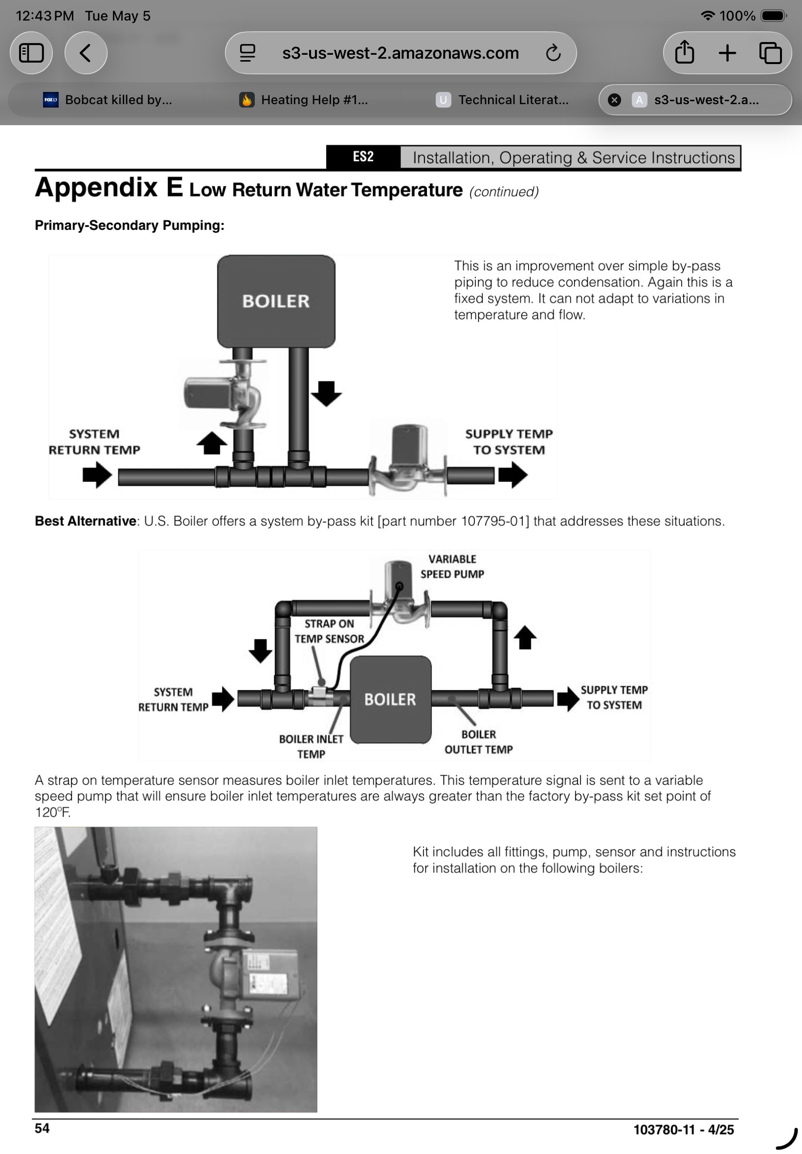

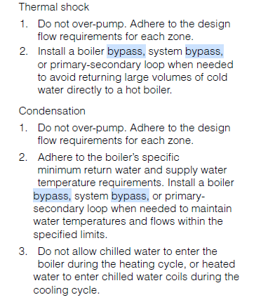

  • EricPeterson
    I don't know what manual you are displaying, but I found the 110F number in the I&O Manual found here: link (on the Burnham website for the ES2). I didn't find any reference to a 120F return in the ES2 documentation. I think the document that specifies 120F is for the bypass kit and that is a generic comment for all boilers.
    The bypass kit looks reasonable but the Caleffi valve is a lot cheaper and a lot simpler.
    Their ES2 documentation is sadly lacking when it comes to specifying boiler protection. They do make reference to a bypass kit. They also mention thermal shock and condensation.

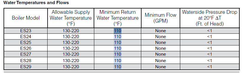

  • GGross
    GGross Posts: 2,104
    edited May 5
    this was the manual I looked through, I couldn't find anything stipulating against that 110 return temp (page 5) . seemed weird to me as well, local rep said they do approve it for the low return water temperature but was going to reach out to the factory for more info. I found an even newer manual that states 100 for return water. kind of goes against what I know so I'm hoping someone from Burnham can clarify
    https://s3.amazonaws.com/s3.supplyhouse.com/product_files/Burnham-ES27BNI-T-Install-instructions.pdf
    edited May 5
    I think the "allowable supply water temp" is also important here. If your flow isn't slow enough to keep the supply temp at the minimum of 130 then you will get condensing.(if it were my boiler I wouldn't cut it as close as the manual suggests is acceptable)

  • pedmec
    pedmec Posts: 1,488
    My interpretation is the 110 is the minimum to prevent thermal shock (cracking) of the boiler and the 120 degrees is the minimum allowed to prevent condensation. In my opinion i would stay well above those numbers. It's like anything. Those are minimum numbers. You are straddling the line which is not good. Compare it to a circulator. Circulators are rated for 230 degrees but i'm sure as hell can bet you that you won't get many years out of a circulator if you run it at 230 degree loop temps.
    The element I have in the Caleffi valve is the 115F, so yes it mixes the water so that the boiler return temps are typically 115F and higher when the boiler is in full swing. As for the 120F, the boiler does heat the water, let's say by 10 to 20F, so the supply temperature will then be well above 120F.
    brings up a good point when you are talking about temperatures.
    The return temperature is typically measured via a sensor outside the boiler. Either a strap on sensor, or with a 3 way mix valve the sensor is internal.
    The boiler control measuring the temperature inside, typically a probe into the boiler, so that number will tend to be higher.
    Another good number to know would be the temperature in the supply pipe as it exists the boiler. It should be a blend of the return, plus what the firing boiler is adding.
    A boiler properly sized to its distribution, at load may add a few degrees maybe as much a 10 degrees depending on flow rates.
    The “industry” return temperature suggested number is a bit of a moving target.
    It depends on the fuel type, fuel value and CO 2 reading.
    some boilers, due to the design and metalurgy can handle lower return, that was always the selling feature of some Buderus, and the Viessmann bi-feral.
    Additionally some cast boilers have a blending device inside, either a valve or vs pump, the Weil GV Gold, or Burnham Revolution, and some other current brands and models have built in protection, done properly
    So the boiler manufacturers info should be the number they have tested and recommend.
    130f seems to be a number that covers all types is standard, conventional, non condensing gas, oil, lp with some wiggle room.
