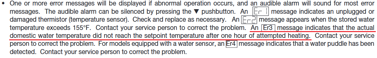

My Amtrol hot water maker is throwing er3 - Zone valve? Need diagnose assistance

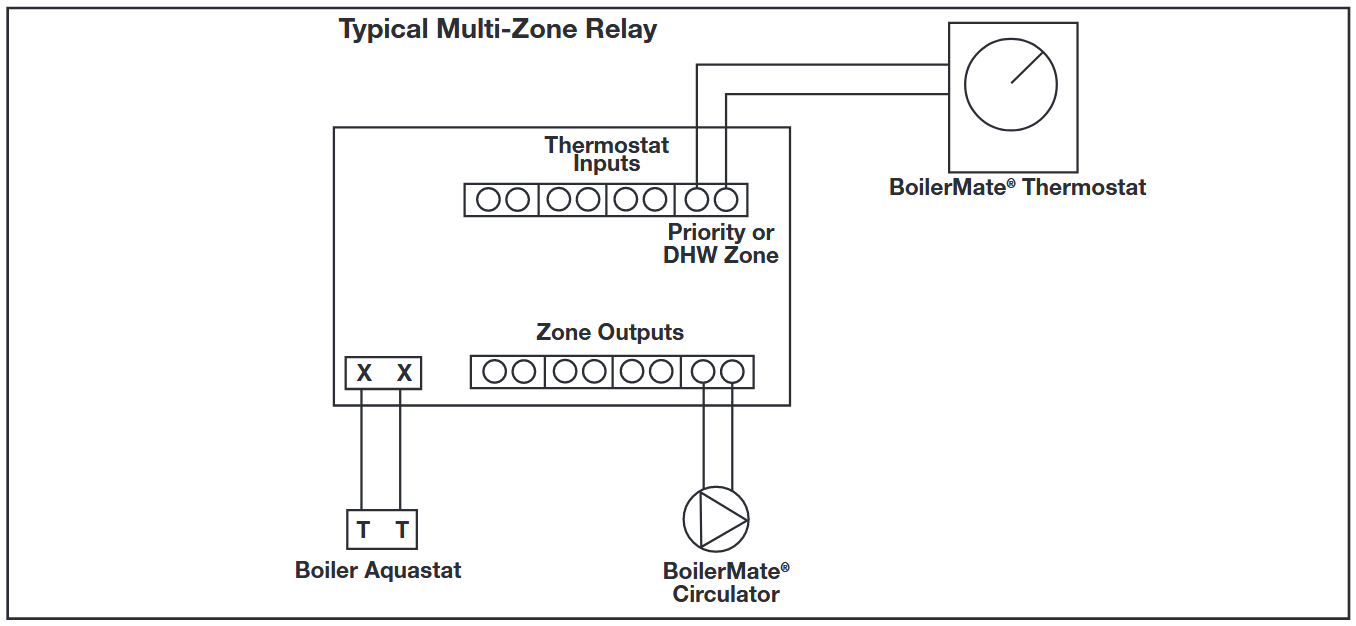

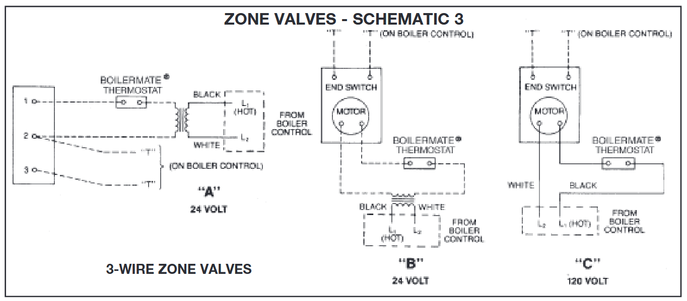

    Some basic wiring examples. Often systems are a combination of "A" or "B" and a Multi-Zone Relay box.

    Sounds like a bad end switch on the zone valve, a Honeywell zone valve from your description. This zone valves last about as long as an old light bulb. Best thing to is completely rebuilt the valve and replace the motor. If the valve opens like you described you can see if the end switch is the problem by jumping out the wires attached to the red wires on the zone valve. If the boiler comes on then you know the end switch didn't close when the motor opens the valve.
